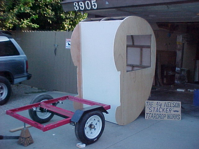

Welcome aboard, you have the right idea, building light. My 6 ft Stacker weighs 245 lbs, so you see, it can be done. Good luck.
8) :) :thumbsup: Roly, the So Calif woody guy.
More pics here: http://tnttt.com/gallery/album.php?album_id=2181
