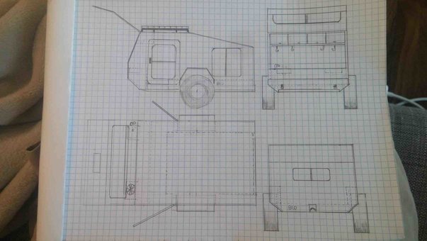

Here's a photo of my drawings.

It appears your axle is almost on center of the trailer.
You may want to consider the 60% - 40% rule so the trailer doesn't dance all over the road and gives you proper tongue weight stability.
Place 60% of the front of the trailer in front of the axle and 40% behind the axle.
Good luck with your build, :D Danny

Thanks, halfdome. Weight distribution is a concern on my project. I'm really hoping I can find ways to move weight forward. I'm unable to move the axle back at this stage. I'm hoping to have a motorcycle on the front some of the time, but I'd like responsible weight distribution even without that.
