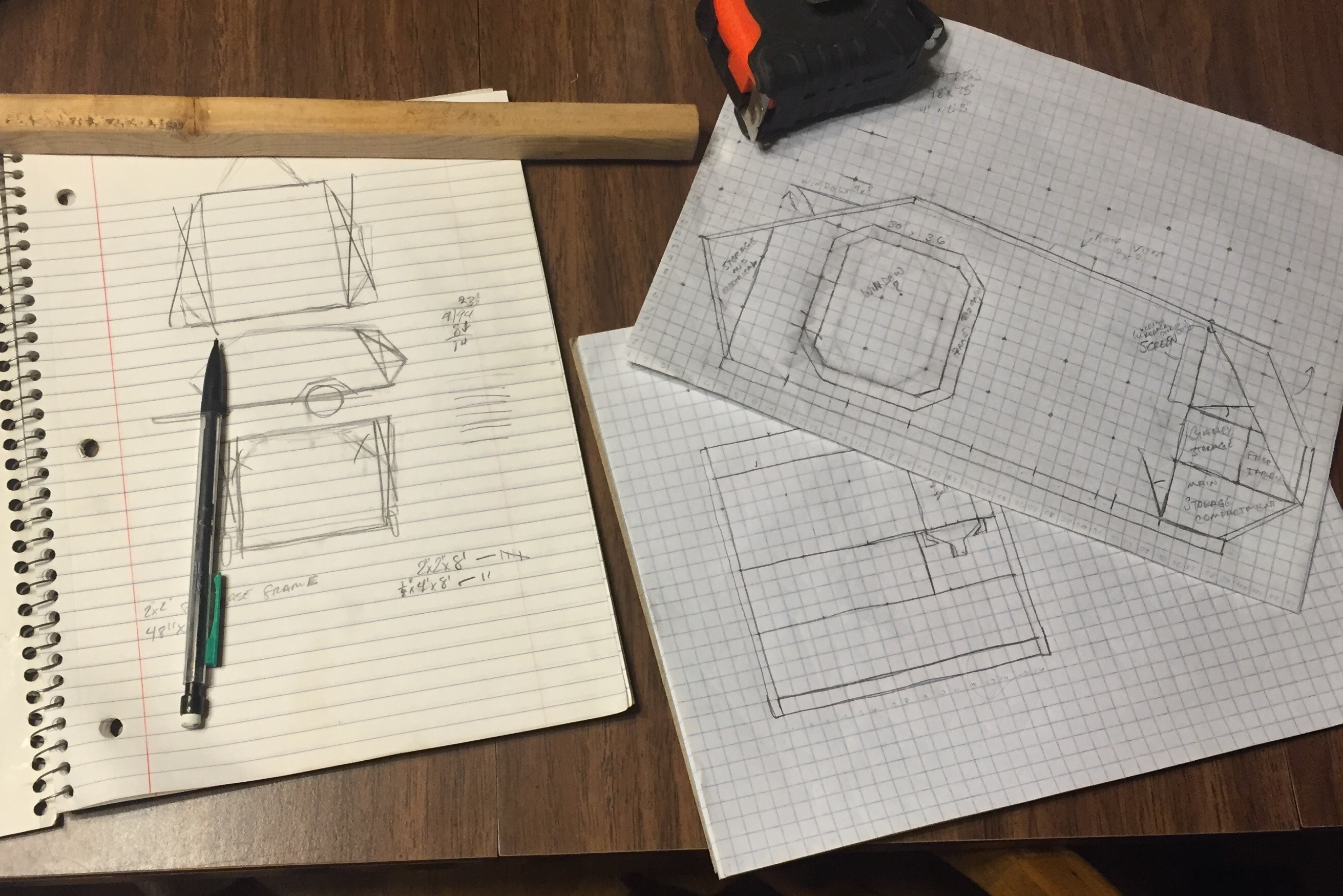

I'm a young guy, and I'm about to start my first build. The first trip I plan on taking with it will be in September up to BC, Canada. I've already started designing, and plan on starting to buy materials very soon. I chose to go with an angular design over a straditional curve because I find them slightly more appealing as I drive an old jeep(boxy by design), which I plan on pulling it with. My plan is to build on a 4'x8' base, and have the entire build insulated(floor, walls, and ceiling). I've attached a quick pick of my plans. If you have any comments, or suggestions they would be greatly appreciated. Especially concerning the hatch.

Welcome to the Forum... I like your basic idea and am watching to see it come together... :pictures:
Hey BTW, Sept. is just around the corner, were you talking about Sept., 2016... That's awful tight schedule... :NC
Good luck and keep us posted... :pictures: :pictures: :thumbsup: :thumbsup:

welcome to site let us know a little about you like name, where you from Tx is big and there are many trailers all over that state If you can go look at some at a gathering everyone is willing to tell you how they did things to their trailers
