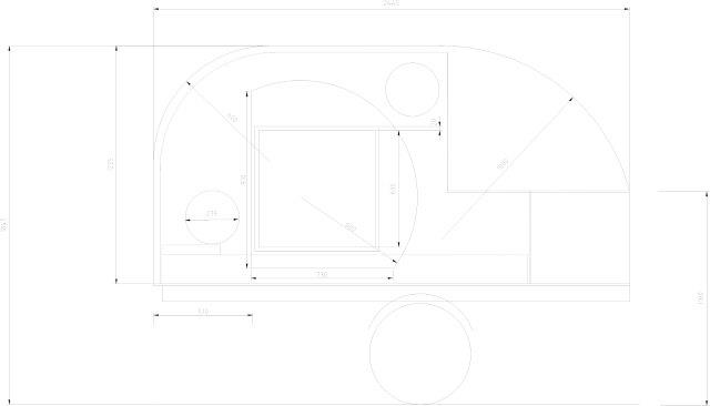

I have picked up some second hand boat porthole glass pieces
Teardrop profile.jpg (11.82 KiB) Viewed 813 times
So here is the story so far....

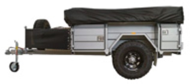

Our extended family are all mad keen water skiers and we gather regularly to camp and ski. My wife's 3 brothers, their families, the in-laws and two ski boats make quite a party!. Two of the brothers have upgraded from tents to camping trailers where the tent top folds out and the mattress is on top of the trailer still. Similar to this style of thing:
allrounder_194 (Custom).jpg (22.62 KiB) Viewed 813 times

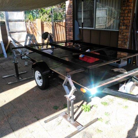

Due to limited parking space (or too many vehicles & boat!) I have designed a system where I can lift the TD off my trailer so it can double for general haulage tasks. (it also allows for sliding a folding table and tarp poles etc underneath)
The bar the jacks lift slides out when the TD is in use.
I have the base trailer (5’ x 8’ flat top kit) and my floor frame complete (recycled steel too!). I have the profile drawn up and the marine ply for the sides ready to cut out ….

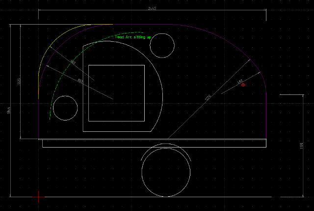

Postby edgeau » Thu Nov 24, 2016 12:49 am
Thanks DR Hill. I will indeed start a build post. And no ski racks needed (they are already on the boat :D )
I have already tinkered with the design a bit - I am trying to decide if I should make the radius of the front curve a bit bigger.
(go from 600mm to 800mm)
Teardrop profile comparison 2 (Custom).png (35.22 KiB) Viewed 695 times
