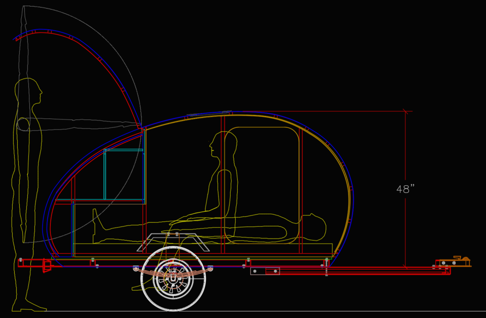

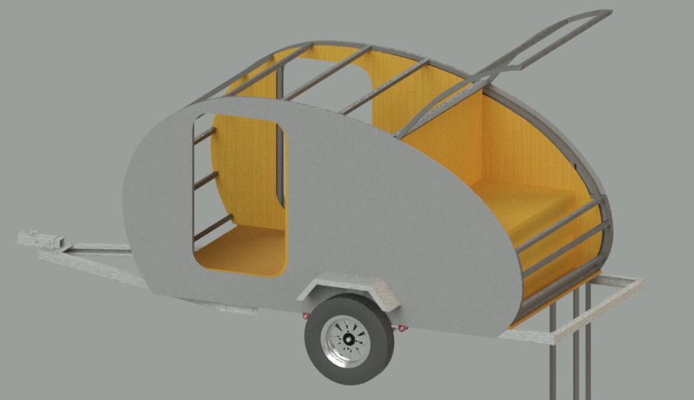

Hi folks. Thanks for the add and greetings from Central Texas! I've been researching teardrop builds for several weeks now and have started my own design similar to the "Rascal" shape. My design goals are to build one that is long enough for my 6' body to stretch out while staying under 500lbs. Want to have the option to pull it with my little Hyundai Sonata or my BMW motorcycle. So, I'm planning an all aluminum frame starting with the Northern Tools 4x8 aluminum trailer. Will end up cutting a foot or so off the length of the trailer. Also thinking about adding a two stage swamp cooler. Here's my AutoCAD model:

The design looks good. I would double check your clearances for your shins and/or knees, or at least consider rounding or softening that cabinet corner.
To keep it lightweight you may want to check out the foamie section as well.
Is this a one person or two person camper? If it's just for one, I could see the advantage of narrowing it for motorcycle towing.

I am planning to put the rigid foam insulation between the struts to insulate. Also planning to shorten the trailer to eliminate the shin buster in the back. I want this to be wide enough for two, so going with 48" for now; granted a "cozy" two sleeper, but then I like that! :)

I was referring to the interior cabinet as the shin buster... But now I see what you were talking about in your drawings. As much as my wife and I toss around at night, we'd both be bruised by morning.

brx017 wrote:I was referring to the interior cabinet as the shin buster... But now I see what you were talking about in your drawings. As much as my wife and I toss around at night, we'd both be bruised by morning.
Sent from my Nexus 6P using Tapatalk
Oh, I see what you mean. Yes I thought about that too, so I was thinking maybe I would upholster some foam rubber to cushion the bottom edge of the cabinet.
