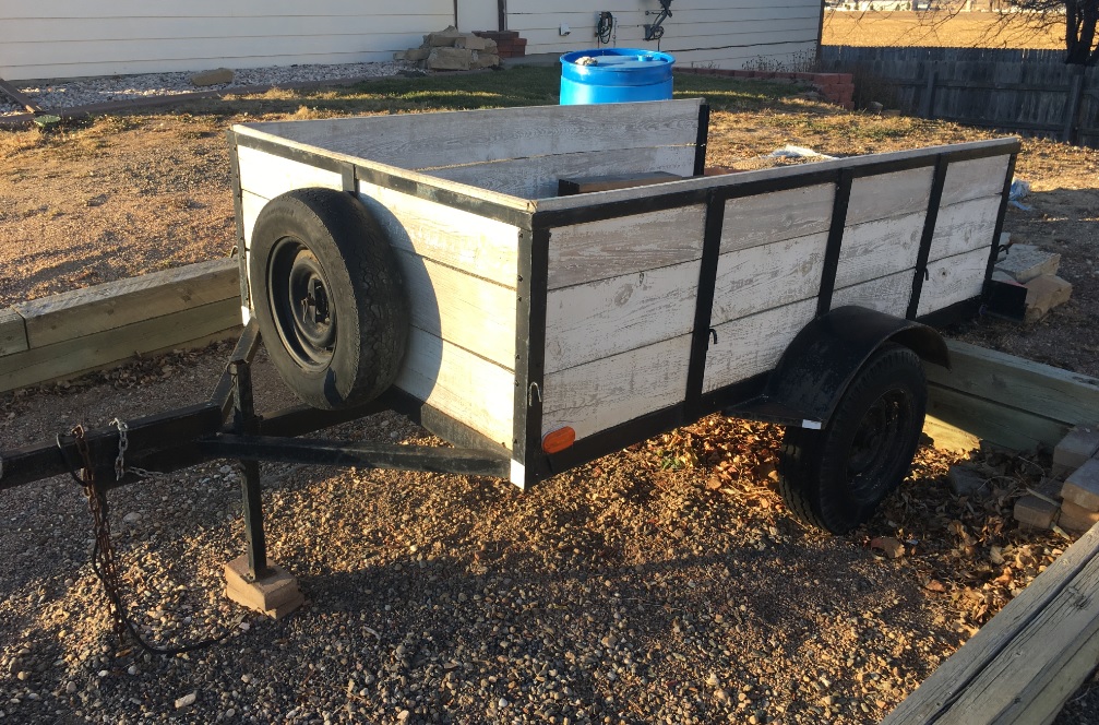

Hello All! First time builder and I'm going to attempt my build this December and January in Colorado without a garage. I have a few friends who said I can use their garage from time to time so that'll help for painting and finishing. Wish me luck.... please....
I just bought my trailer. My mother's bf was selling his hand built 5x8 for $400 and I couldn't pass up the deal. I like this trailer because it also has ribs for the old walls that I'll use to ensure a secure mount to the trailer. Nobody wants a Teardrop Kite, right?
I'm going to go with the "Rimple" design since it's easiest (i'm told) and also for max headroom with Aerodynamics. LOVE that you all provided the basic build plans for this (and many other) Teardrops! Saved me $20 which we all know will come in handy.
My Modifications: My main mods will be interior. I live in CO and want to be able to use it during the winter without too much heating and layering. So I'm adding 2x2 studs to the walls and insulating it that way (not sure which type yet, suggestions welcomed). The plans on here are for a 5x4, so obviously modifying for a extra foot of width (hooray for space!). My floor is also sunk 5/8" below the frame so that'll help with the space I loose for the insulated floor.
I'd love some ideas and suggestions, all are welcome. Outside of the Rimple plan and the insulated walls, I'm going to wing it as I do with most of my projects.
My 5x8 Trailer (below)
(taking off the side wood panels)
Trailer Start
CC Trailer.jpg (355.28 KiB) Viewed 2947 times

Postby pchast » Tue Dec 06, 2016 9:04 pm
Welcome! :D
I'd recommend that you check out foamys..
Those 2x2 studs can add up to a lot of weight. :thinking:
I'm sure, no matter what you decide to do, you can
finish a camp trailer with that to provide your needs.

Postby tony.latham » Wed Dec 14, 2016 12:24 pm
Cody:
Sounds like your brain is rolling on this project!
I'd run down to Harbor Freight and buy their cheap saws-all and cut that frame off. It's not going to do anything for you other than add weight and get in the way. There are several ways to tie your floor to your frame and then bolt the floor to the trailer.
Tony :beer:

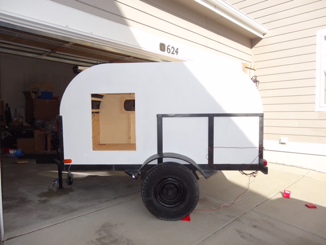

Postby ColoradoCody » Mon Jan 09, 2017 10:51 am
I'm working on a build journal post with step-by-step pictures (but plenty of "forgot to take a pic" steps too), but thought I'd post at least an update of the build so far. I was lucky enough to have a generous girlfriend who surrendered her garage to me for the winter so I wouldn't have to keep building in the snow and cold. So I'm a bit warmer and happier, but she also lives an hour from me so I really only get to do weekend work now. Not a bad trade off, but the work week is tough since all I can do is plan...
Besides being a good developer of patience, the winter build isn't too tough if you have decent lighting. It gets dark quick and that's my biggest hurdle so far. The only other real downside is that the glue doesn't work well in cold temps. So I've had to wait for warmer weather and add a heater to the garage so that the glue will bond better. I'm using screws too, but the glue will become more and more vital as I inch closer to my goal of getting the roof on.
This group has helped me a ton and saved me a lot of money on potentially wasted items and materials. But at the same time there are amazing ideas that have "forced" me to spend more money on cool accessories or build ideas. haha
Early Jan progress
trailer update.JPG (84.04 KiB) Viewed 2613 times

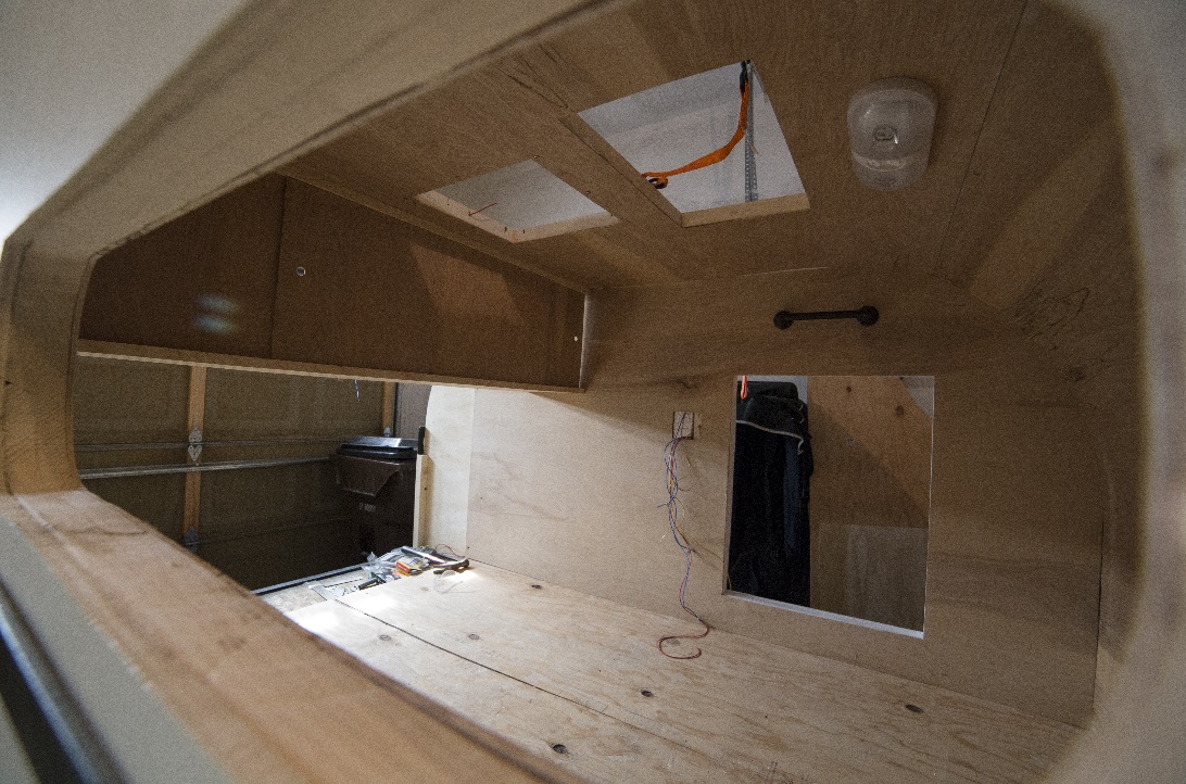

Postby ColoradoCody » Tue Feb 14, 2017 1:51 pm
The inside is almost done!
Interior update
Inside from Window.jpg (343.52 KiB) Viewed 2525 times
