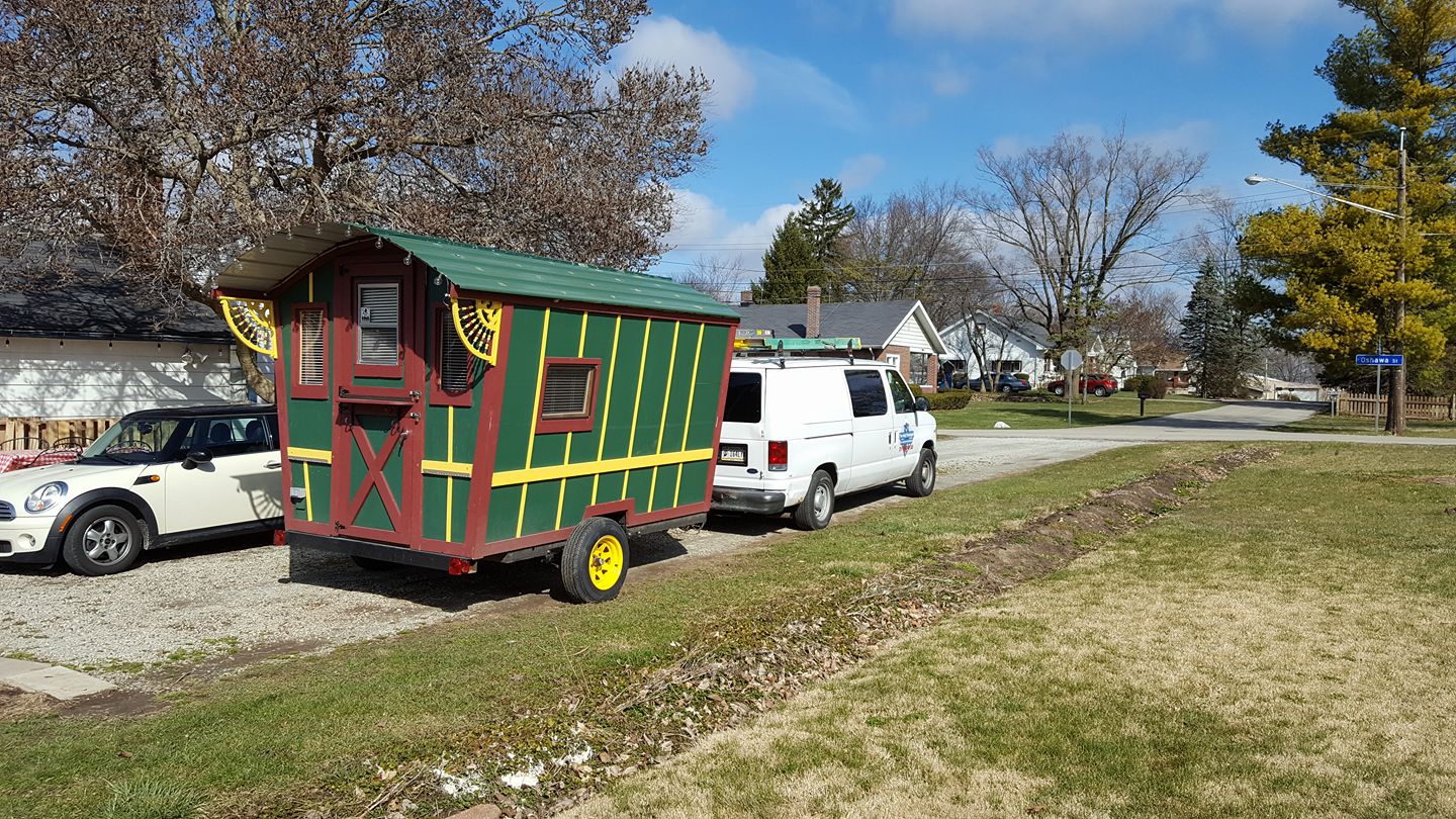

Postby mtbikernate » Mon Apr 10, 2017 1:12 pm
This might interest you. This is my friend's trailer. He basically put a shed on top of a flat trailer. Queen bed and a small kitchen inside. Tall enough to stand in.
