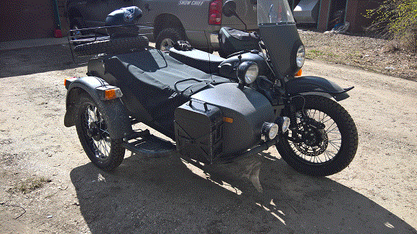

:DOH2: its been 6yr, time to build a second tiny tear. Let the MADNESS begin....
This time I'm planning on building a truly tiny tear. I plan on pulling it with my Ural motorcycle.
have been lurking around for a while now, and there are not to many plans out there in the very tiny size. my trailer is a flat utility 48"X48" long Tung.
most plans I have seen, look like folding types, I'm looking to try a very small traditional teardrop type. looking at a max 78 long by 48 wide, and 40-48 tall and as light as possible.
was thinking about sides in plywood, and corrugated tin or PVC for the tear. any ideas on this working, have seen larger tear drops use corrugated meatal.
