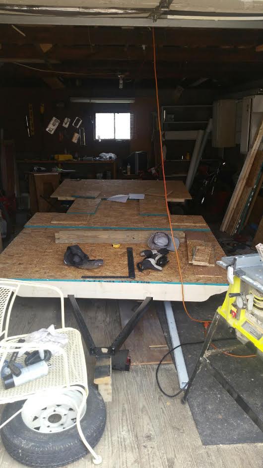

Postby 5150red » Fri Mar 24, 2017 2:50 pm
My initial plan was to extend my floor over the "A" portion of the tongue by 12". Now I am thinking this is a bad idea. My plan is based on the Compact. I have squared off the bottom and have the extension riding on the "A" portion of the frame. I am now thinking I should cut that back. If I remove 8" of floor and the front 2x6 support, that would cut off a few pounds.
Thoughts?

Postby 5150red » Fri Mar 24, 2017 2:51 pm
Not a great pic, but here is what I have so far.....

Postby QueticoBill » Fri Mar 24, 2017 4:21 pm
Extending the tongue?
Between extending the trailer front and back along with moving axel versus extending floor all to front and extending tongue, I think the latter is easier. I see a piece of tuve in your photo so maybe you are extending tongue. I just reached a decision on mine and have to pick up the steel.
QB

Postby 5150red » Fri Mar 24, 2017 4:23 pm
QueticoBill wrote:Extending the tongue?
I've extended the tongue 18" and moved the axle back.

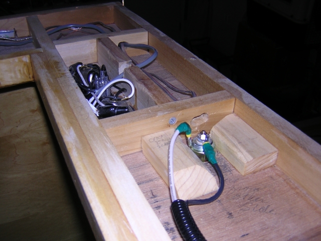

Postby S. Heisley » Fri Mar 24, 2017 10:52 pm
If you are building a Compact, you have room to run the wires in the stationary ceiling portions:
You only run the wires down the side where you need to. Leave as much as you can in the ceiling area and it's out of the way yet convenient.
The other thing that you might do is build a wire runway, so you can always get at your wires if you want to. A lot of teardrop builders build a runway between their cabin area and their galley area. A compact doesn't have the advantage of an adjoining wall; but, you could still build a runway along a side or sides, if you're so inclined.
Of course, a lot of how you run your wires depends on where you plan to connect to your battery and to shore/land power.

Postby S. Heisley » Fri Mar 24, 2017 11:08 pm
5150red wrote:My initial plan was to extend my floor over the "A" portion of the tongue by 12". Now I am thinking this is a bad idea. My plan is based on the Compact. I have squared off the bottom and have the extension riding on the "A" portion of the frame. I am now thinking I should cut that back. If I remove 8" of floor and the front 2x6 support, that would cut off a few pounds.
Thoughts?
You should not be using 2x6's at all. It'll be way too heavy. Use 1x2's for the walls; and, believe it or not 1x1's for the cross beams/spars in the lifting roof. The strength of the build is not in the individual parts but in the whole of the unit. Remember, you aren't building a house. You're building a tiny trailer. ...Okay, 2x4's should be used for the portion of the floor/deck that extends beyond the original chassis; but that's about the only place that you should use them and 2x4's are plenty strong enough.

Re: Compact builder??
Postby 5150red » Sat Mar 25, 2017 10:53 am
J.E.
There's only one 2x6 & it is trimmed down to about 2x4.5. Looking back, the 2x4's are probably overkill. I probably could have gotten away with a strip of plywood instead of the 2x4.

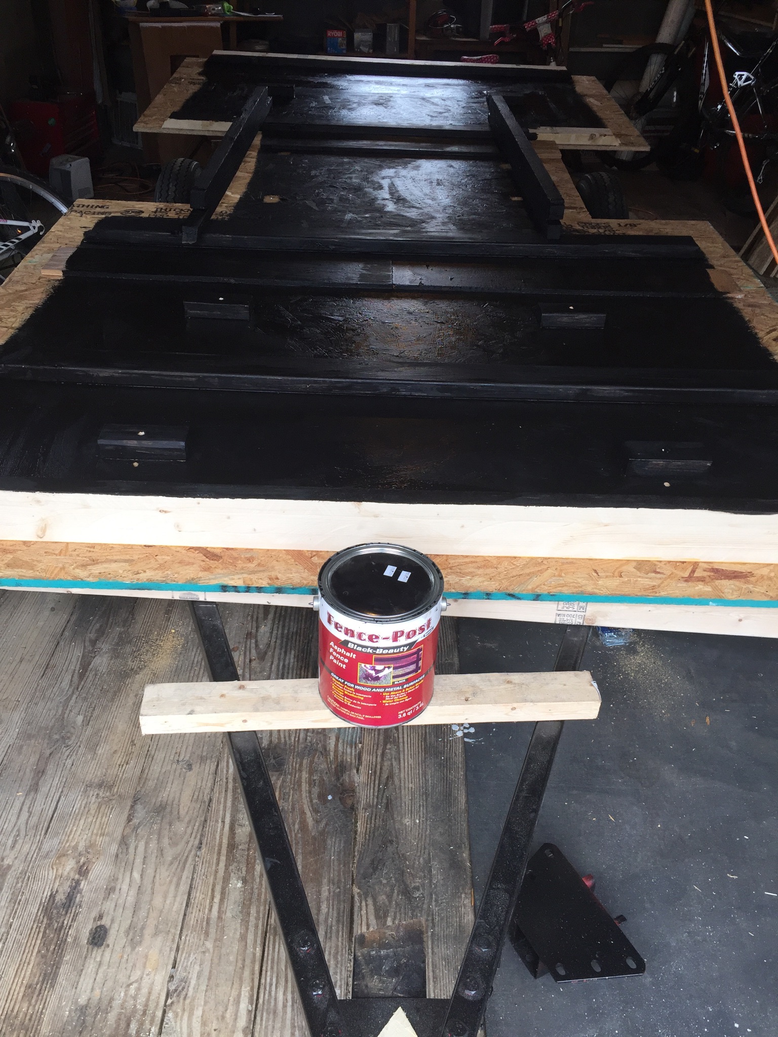

Postby 5150red » Tue Mar 28, 2017 9:06 pm
Well, I had to go to Ann Arbor, MI for work this week so the wife won't be able to complain about me spending time on the.....(OH NO SHE NEEDS A NAME)....uh, TTT? However, before I left I got to put the first layer of under coat. It's kinda exciting to see it progress! I did leave about 4-5" unpainted to make it easier to glue my side pannels (hopefully next week).
5150red
