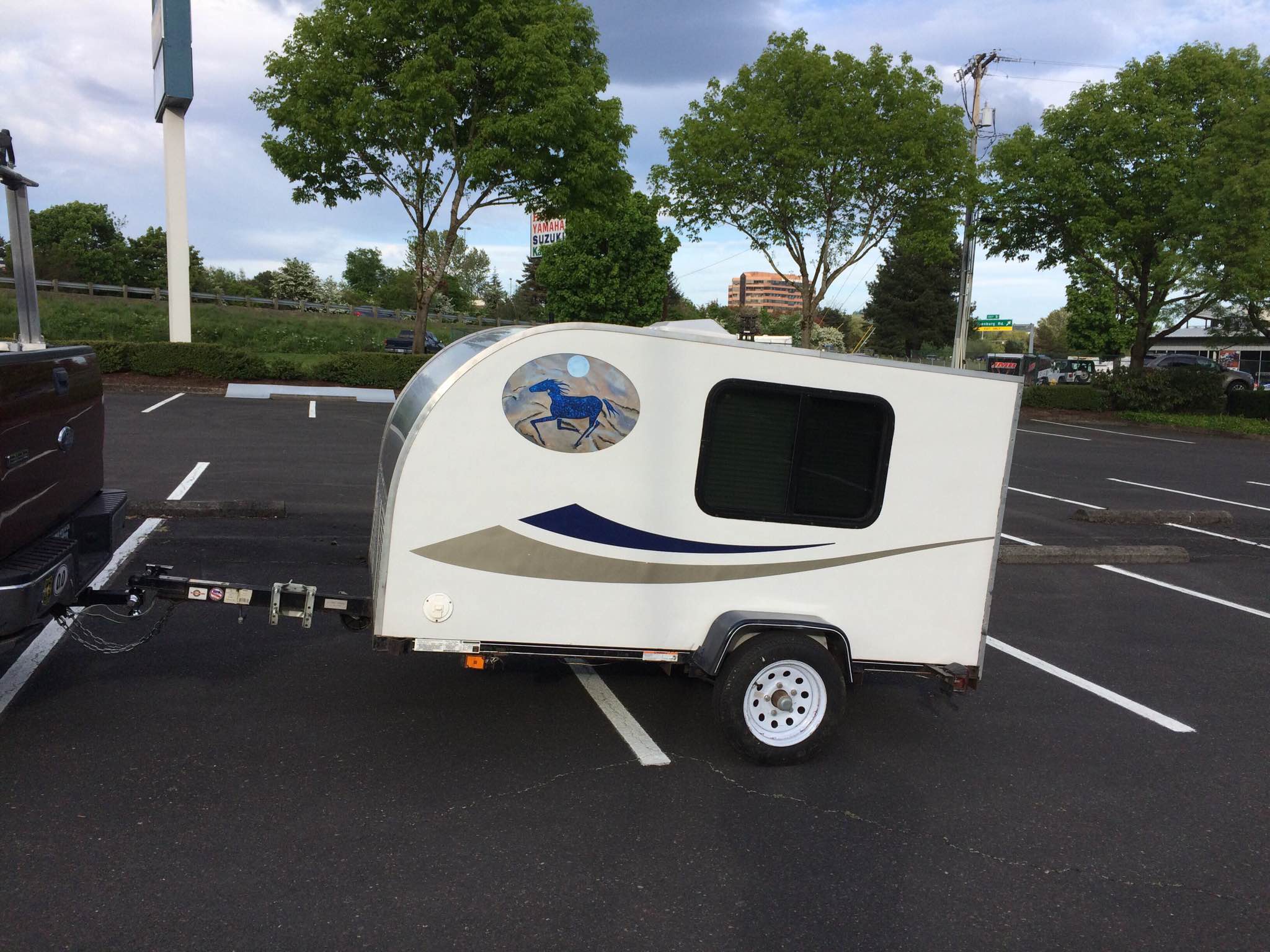

Postby Pinstriper » Tue May 16, 2017 8:10 pm
And the big rig:

Re: Just got a teardrop
Postby Pinstriper » Tue May 16, 2017 9:05 pm
Thanks!
I put foam tiles down for the floor. Not happy that it has a glue-down I/O carpet, but I'm too lazy to rip it out.
I also put a spare tire carrier on the tongue, and I bought some industrial sized roll of vinyl magnet what they use to may refrigerator magnets from, so as to have a magnetic blocking panel for the A/C vents on the front of the box. Keep bugs and road spray out, help insulate instead of being open to the outside.
And those horse decals - they gotta go. Will be replaced by Sasquatch or the Kraken or something. Horses. Pfffft.
Postby AZ_Desert_Rat » Thu May 18, 2017 3:44 pm
Welcome to the forum... :thumbsup:
Congrats on getting the Tiny Trailer... The pics show both trailers nicely... :pictures: :pictures: :thumbsup:
