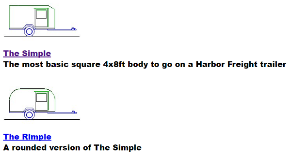

  • Hello Brian, welcome to the forum. I built a squareback (Simple) trailer on a decrepit motorcycle trailer frame that I enlarged to a 4x8 platform. I decided on a "Simple", rather than a "Rimple", because I had n't the skill or desire to bend the 3/4" plywood I sourced for my build. Easier to build, for sure, but less aerodynamic than the rounded shapes favored by most.
    Rimple or Simple.PNG (47.71 KiB) Viewed 2280 times
    basically the same; easier to build than most
