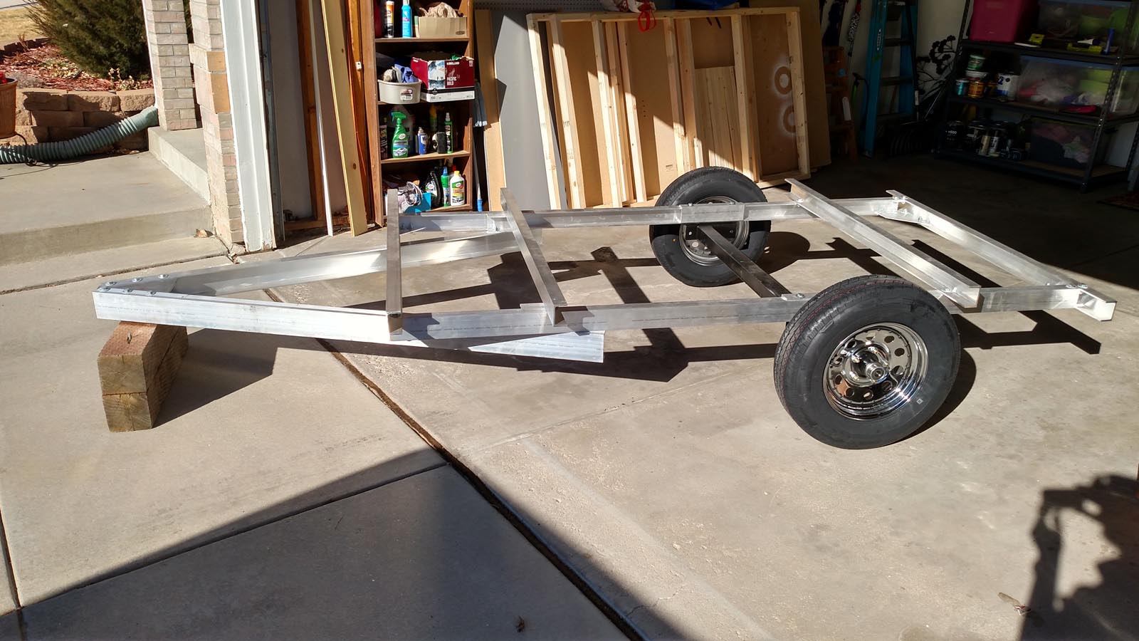

Fairly long-term lurker here, I've finally made the plunge and started a build... still figuring out how to post on here, etc, but here's a shot at posting a pic of my finished platform.
After much MUCH deliberation, I decided to build it from scratch and out of 6061 aluminum channel. I'm very pleased at the result, appears very solid, and I believe fairly light for the quality of the axle and wheels.
I'm a retired aerospace injunear, with a strong background in structures, so I'm confident of the design.
Thanks SO MUCH to many on here who inspired me to start this thing, and I'll properly than the member who's design I used to base my design on when I start my build thread.

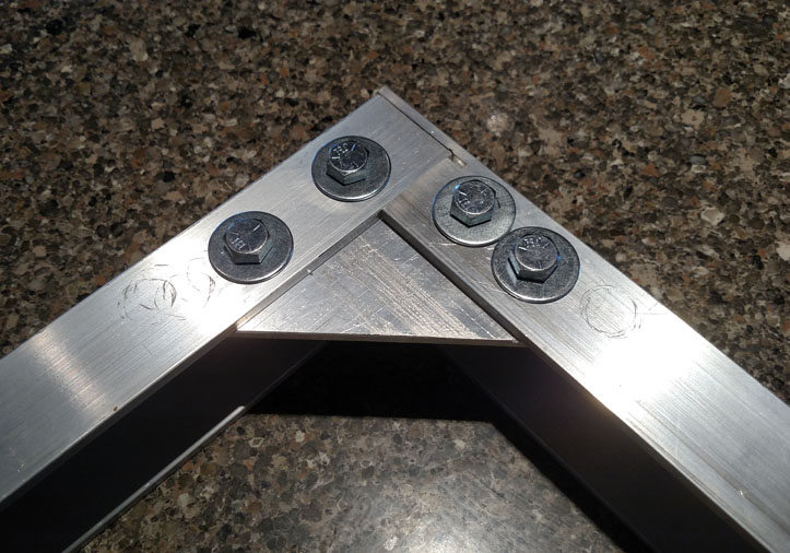

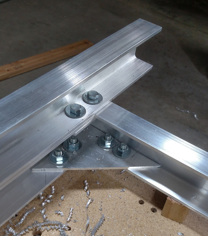

Tony: Here's a shot (the bottom pic) at the underside of a "test" joint for the front corners, the actual is identical. I "coped" the joint by carefully removing the flange up to the web on the cross piece (on the right), leaving the main longitudinal pieces whole. These front joints also get a second cross member at the full trailer width (60"), as seen in the top pic, showing the final actual complete joint. My wording is probably confusing, but hopefully the final complete front corner joint picture is clear.
Notice the bevel on the 45-degree gusset (top pic), this allows the gusset to snug up against the web of the channels. Without this bevel, the fillet on the inside of the channel would interfere. This allows the holes in the gusset to be further from its edges, and the holes in the channel to be closer to the web, for greater strength.
I had a ton of fun cutting all of this aluminum; I bought a new $20 aluminum-cutting table saw blade, and it went through this stuff like butter, making precise cuts. It was like working with a fine hardwood. I was very careful, wearing a mask, excellent safety glasses, made sure it wouldn't bind/kick back, etc. Aluminum chips and drill-spirals get all over the place, and one has to be very careful to not track this stuff into the house... wife would not appreciate that.

Stunning workmanship. I'll have to follow your build.
