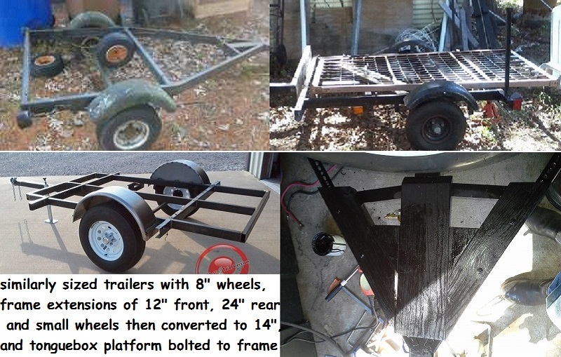

  • My TTT is made from a derelict 50" x 60"motorcycle trailer I bought for $50, at a swap meet. I fixed it up a little, but never used it, and it sat and rusted in a tall grass spot in my backyard for 18-20 years. When I started building it again, this time as a "simple" semi-off road trailer, I lengthened it by welding on 12" and 24" extensions to the frame, making it a solid platform for a 4' x 8' sheet of plywood (it wasn't really necessary...the 3/4" floors, walls, and roof made a self-supporting structure that would've worked on the original frame). But, necessary changes (a stronger, longer tongue, and conversion to larger wheels) were done. The wheels were just too small for the intended use I planned, and the tongue was short, weak, and rusted through, so to avoid problems like the ones Ron had, I went big on my replacements: big bearings and hubs for the 14" wheels, and a 6" piece of .1875 thick, square tubing (welded to 3 crossmembers, with a center spine of smaller tubing welded over it all the way to the tail (very strong, but probably overkill).

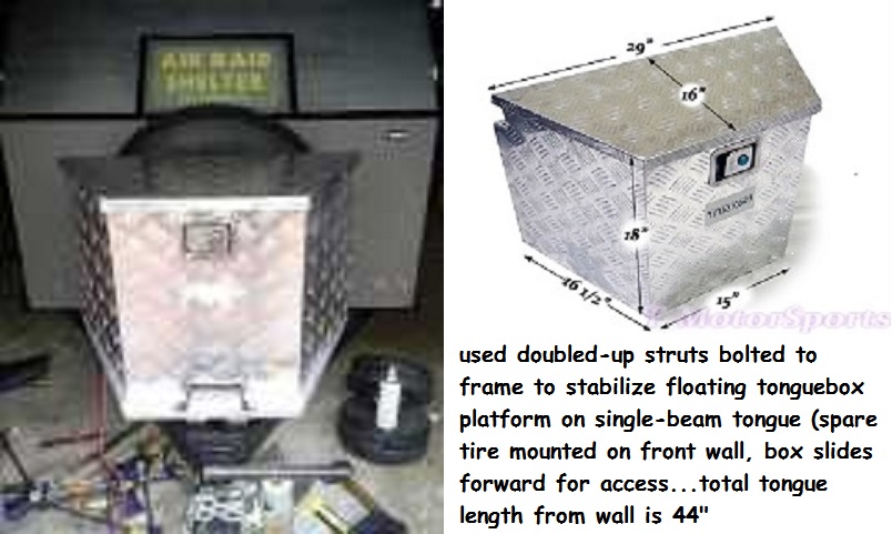

  • You may be interested in a modification I made to mount a tonguebox on the unused space on my single=beam tongue. I needed to transfer some more weight forward, to better balance my trailer, and a tongubox was needed to do so. I had already mounted my spare tire there, and decided to fabricate a sliding platform on the beam, enabling the tonguebox to move forward for more access to the spare, if needed. At the time I made it, I had no welder, so I simply bolted on a couple of doubled-up 1-1/4 in. x 48 in. Zinc-Plated Punched Angle bars, to serve as a stabilizing platform and brace for the wooden base, that I mounted the sliding mechanism to. It works pretty well, and serves my purposes, without being too obviously redneck engineered.

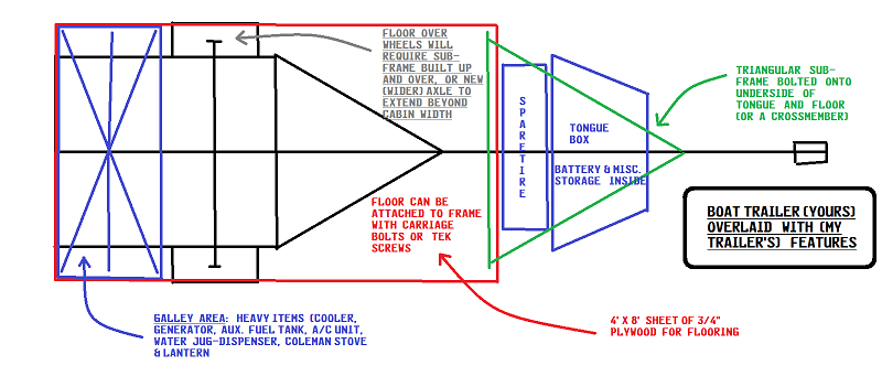

  • Which brings me to the main point regarding your use of the small (but long-tongued) boat trailer. It is not much smaller than what I started with, and can be converted to a usable teardrop-type camper. The narrow width can be overcome by building up and over your wheels (which I recommend up-sizing to 13"-15" tires), and/or getting a stronger/wider axle. A single sheet of 3/4" plywood bolted/screwed on top of your existing frame (or a to a lifted framework - to have your wheels under the floor, or with internal wheel-wells) will make a strong base for your cabin. Additionally, the long tongue on your trailer is a positive feature, if sturdy enough. My trailer's new tongue tubing was only 6' long, before welding it on, with 44" in front of the cabin, limiting the space I had there, to mount tire and tonguebox. I made it short to be able to fit backed-into my 3-bay garage, so I could walk around it, with a an existing workbench/storage area behind it. I made the trailer to be 12' total length, but found that 14' would've been doable (your trailer length is ideal). If I had your boat trailer, I could've built a TTT similar to mine, with certain benefits from the placement of your axle (further back than mine - better weight balance for my very heavy galley), and the longer tongue (aiding in backing-up maneuvers). Here is a quick drawing I made, to show the placement of a 4x8 sheet of plywood on your frame, as a starting point, and where my components match up to your frame. Placement and scale are approximated! It's a viable plan, if you have the time to do so. Welding or bolting the front "v" onto the tongue (it could be 2x4's bolted or screwed/glued under the floor, instead of steel) will make a tonguebox feasible, and it will certainly make a galley possible, by offsetting rearward weight bias, while also freeing up interior space. Or, in lieu of a 4x8 trailer, extend the floor forward to make it a 5 or 6 x 8. I wish I could lengthen mine, but it would be a major task, after 5 years of interior/exterior mods. Good luck with your build!
