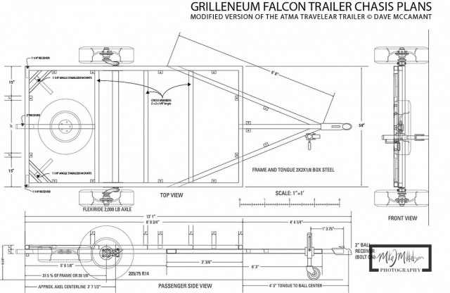

My first goal is to get a trailer built (roughly 5x9). I am not a welder (though I'd like to be - it's on my to-do list) so I am going to have someone weld it for me. My goal is to keep the total trailer width to 79" or less, so I don't have to run additional markers on the fenders and the three lights on the top. Also, a narrower trailer will fit better behind my TV. North American towing restrictions put a 1,000# tow limit on my car, so weight conservation is also on my radar. I did two a 5x8 uHaul box trailer from NH to MT this summer and I just learned that the empty trailer is 900# (according to the uHaul website). My car didn't even notice when it was behind me. I did notice the trailer when it was fully loaded - so I was aware of my speed and following distance and took appropriate precautions. Back to the frame. I am thinking of building along the lines of the Atma Travelear frame, with a few modifications.
Question time:
1) What type of steel should be used? Mild?
2) How are you all mounting your spare tires under the trailer (I would like to do this because I'm planning on having a bike rack set-up on the tongue so this is both the next logical place and will help balance out the tongue weight)?
3) I can't seem to access the trailer tongue page, but can I substitute 2x2x11ga angle for the two legs of the A Frame tongue (I'm planning on having a center tongue (2x2x11ga) run to the second cross member)? I seem to recall reading somewhere that the tongue bracing doesn't really increase the strength, it just prevents it from twisting.
4) Mitered corners-vs-butts. Should this be decided by my welder?
5) I feel like this will result in many opinions, but... what/how do you recommend painting the frame? Clean it with mineral spirits and then a self-etching primer?

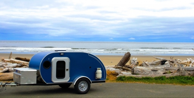

Profile... oh, profile. Simplicity (and what's on the 1/4 ply) is a Benroy-ish shape (24" radius on front). Pic will come later, I think I have one... I am not in love with the Jelly Bean profile, though I do like the Teardrop NW profile:
and I also like the Silver Shadow profile as well. Why 9'? We want to have our Coleman cooler tucked in lengthwise, and we also have a Chocolate lab who will have to sleep in the TD when it's cooler outside. We're hoping to camp more into the shoulder seasons with the TD than what we do with the tent.
