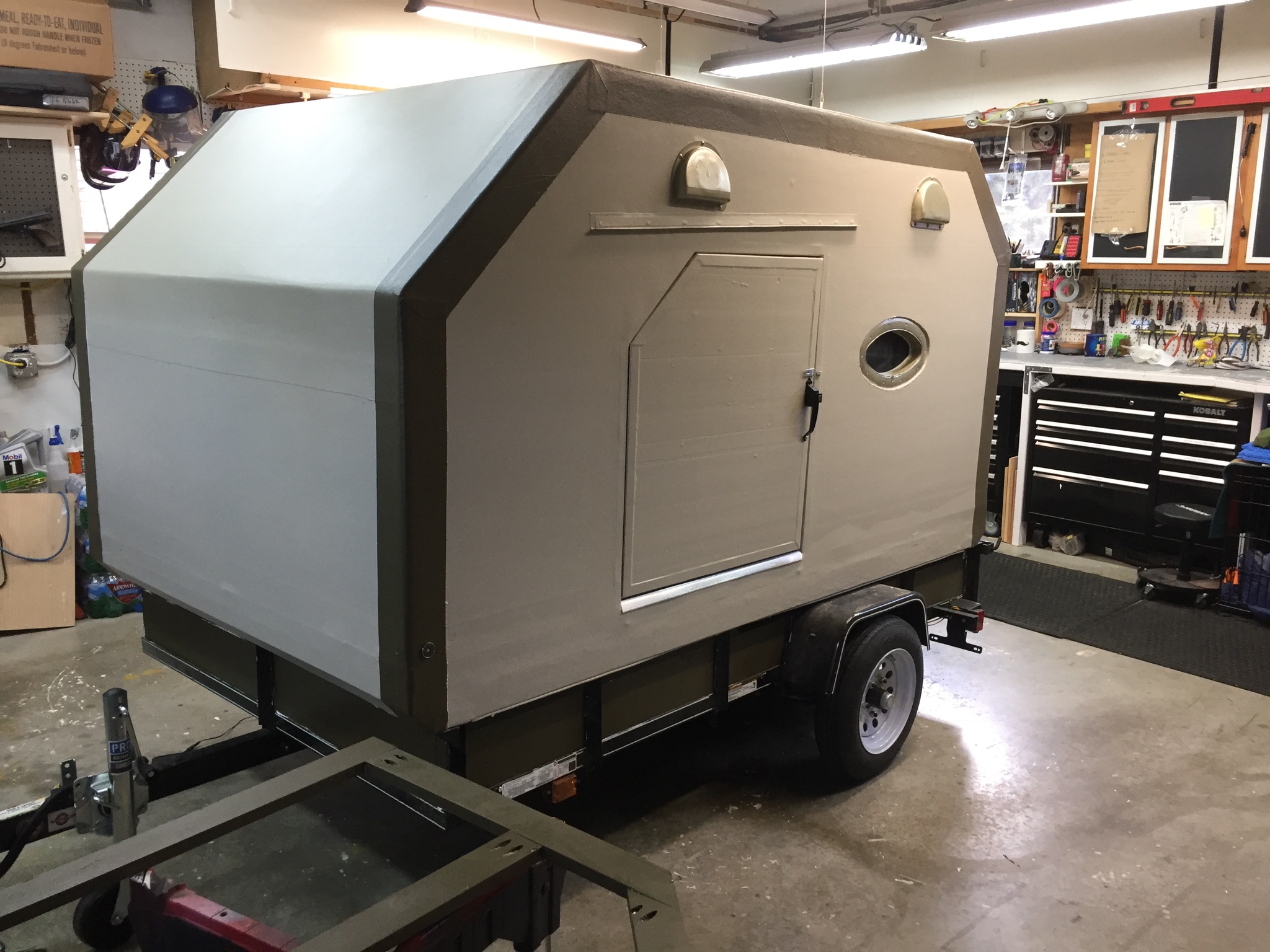

What about bears? Just asking. Pictures please. Tapatalk makes pictures easy. Here is my foamie I am building. ImageImageImage Bed time Foot foot well and Put out awning bars.

Yours is pretty cool- how did you attach the awning frame?
About 80 percent done

The awning is a extendable curtain rod. The bigger part is glued thru both walls of the camper. Inside it is a curtain rod and it is a extendable awning outside. It is also a roof support with a block in the center between the bar and the roof.

Thanks KennethW, that's a pretty cool set up. Do you have wood framing to support it?

No wood just 1 1/2 blue foam and canvas. The only wood is the 3/4 plywood drop floor, the toilet and the bed platform. The only metal is the solar panels, the awning tubes, rails for the tonoau cover, toilet box support galley counter support and the bed frames. :thumbsup:
