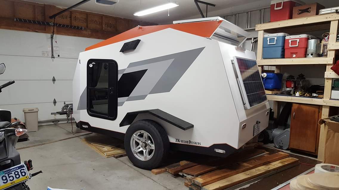

Honestly, bending the wood can sometimes be easier that making your "square" joints straight and plumb. And if you decide to build in a few angles, compound miter cuts can be a huge PITA. You may do a search on here for 'squaredrops' and find what you're looking for.
Here's my 'X-Cubed', built in 2014. Not a curve on the thing. But definitely some funky angles.
Zach
