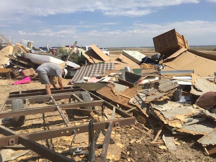

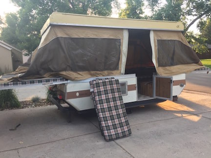

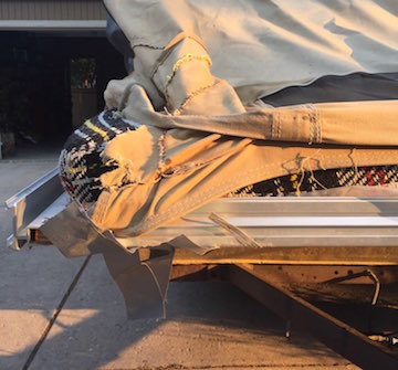

A few months later I came across a free Craigslist posting for a 1970's Palomino popup camper. I immediately jumped on the deal and quickly discovered why it was free.
Here it is when I brought it home. 1978 Palomino unknown model, most of the interior was missing, much of the fabric was brittle and easily tore, mold on the floor, and it was generally in poor condition. It did, however, have a newer looking 3 way fridge.

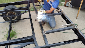

The bumper on the back of the frame was hardly attached, a few welds were broken here and there, and the front half of the frame had a surprisingly large span that needed more steel. I sanded the frame with a wire wheel, which took forever. Many cans of Rust-Oleum paint and it started to look pretty good. I met a friend of a friend who was a welder by trade and in exchange for a plethora of Busch Light he did the necessary repairs. He added a few pieces of steel where I requested as per the build I had planned and also stiffened up it in places he thought were necessary.
I have no idea of the accuracy of this technique, but to get the weight of the frame I used a bathroom scale to weigh each wheel and the tongue jack and added them together. Around 400lbs. The frame is 118" long x 75" wide sitting on tiny 20 inch tires attached to what appears to be a 2000lb axle with old electric brakes. My guess is the empty camper was pushing the limits of the axle and bearings, and loaded with water and supplies it was likely easily overloaded.

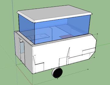

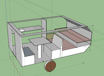

I set my expectations high and spent a lot of time reading other builds and playing on Sketchup. I eventually decided on a foamie pop-top finished with PMF. Here's some early Sketup renderings. My design was to popup vertically like a Sportsmobile campervan. I'm hardly a Sketchup pro - this was my first time using it so please ignore any weird shapes or lines. I don't have a rendering of the entire camper as I only used it at times to help envision how different parts would come together.
Screen Shot 2019-06-17 at 5.08.25 AM.png (67.04 KiB) Viewed 3736 times
The red panel at the front of the camper is a bed that raises and lowers.
The table is also designed to drop down and create another bed.

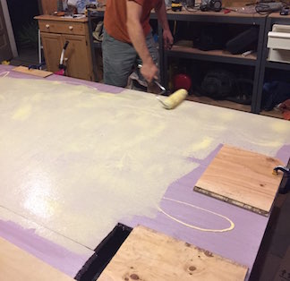

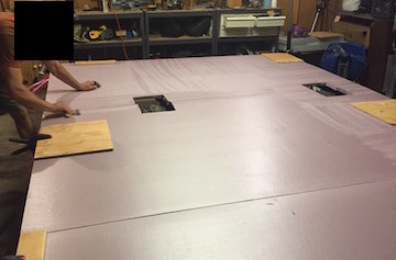

After the frame was prepped I began on the floor. The bottom is 1/2 plywood covered by 1" thick Owens Corning XPS rigid foam and then covered with 1/4" plywood for the subfloor inside the camper. Each layer is glued together with Titebond III. The floor dimensions are 119" long x 81" wide.
11f copy.jpg (24.4 KiB) Viewed 3718 times

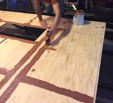

There seems to be two schools of thought with regards to the underside of a camper. Either completely seal it or leave it raw so any moisture can escape. I decided to leave it raw with the exception of where the wood meets the steel cross members where I lathered thick outdoor deck paint on the plywood. After this was painted I flipped the plywood over.

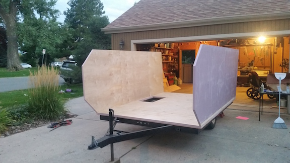

Postby aaronf » Mon Jun 17, 2019 6:54 am

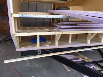

Next up came the walls. I did a similar design to the floor. Again using Titebond III, I glued 1" XPS foam to 1/4" plywood. To keep the pressure on the joint while the glue dried I placed every heavy object I could find in my garage onto the plywood using extra pieces of 1" ply to help distribute the weight. I waited a week for each side to dry to be sure the water from the glue had evaporated. The summer time high temperatures and low humidity of Colorado helped also.
weight
14c copy.jpg (75.84 KiB) Viewed 3715 times
15 copy.jpg (95.24 KiB) Viewed 3715 times

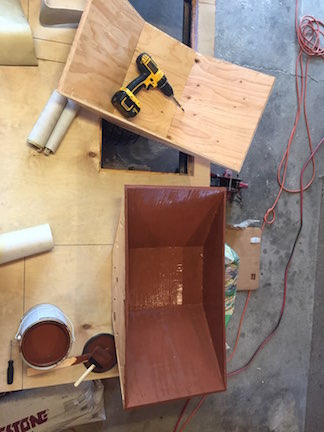

The wheel wells are 1/2 ply glued and screwed. They're very solid. I put many coats of exterior deck paint inside the wheel well and then later multiple layers of spray on truck bed liner. I really don't want these to leak or absorb water. So far so good.

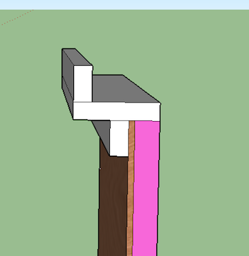

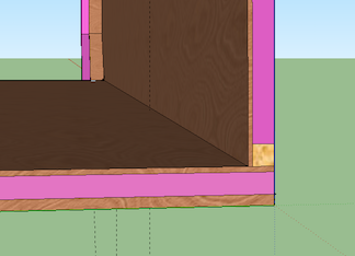

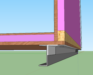

Here's a Sketchup screenshot of how the walls and floor join.
Screen Shot 2019-06-17 at 6.15.20 AM.png (62.46 KiB) Viewed 3713 times
One of the things I did during the frame prep was add a few pieces of steel angle to the outside of the frame due to the floor overhang. I was concerned the weight of the walls and eventually the roof would require extra support. There's a few more pieces than what this picture shows. All joints are screwed with high quality screws and also glued.
Screen Shot 2019-06-17 at 6.15.48 AM.png (46.18 KiB) Viewed 3713 times

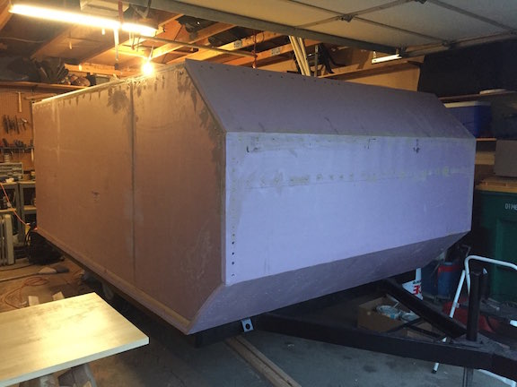

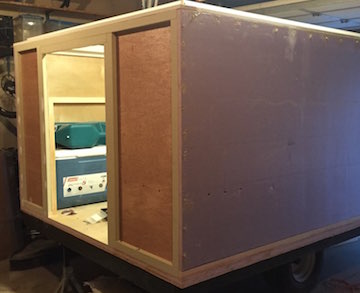

I don't have a lot of pictures of the next steps. We made the front wall in the same fashion as the sides and then cut it down with circular saw to match the angles on the front kickout. The kickout is 12 inches and houses part of the bed that can transition into a couch. We use two 4 inch air/foam mats made by Exped that when put together are 78" x 60", almost the exact size as a household queen mattress. These pads are the reason the camper is so wide at 81". I wanted the bed layout east-west to save interior space and we already owned the pads.

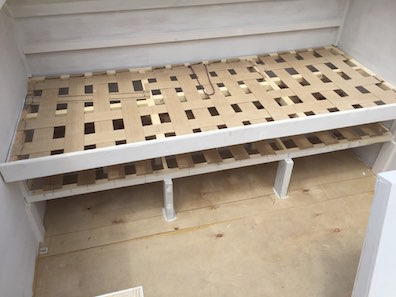

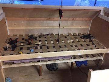

As with everything inside the camper, the bed is glued and screwed into the walls and floor which add to the rigidity of the entire structure. I was initially nervous with strength of the walls, the 1" foam and 1/4" plywood were still very flexible but with the bed, interior cabinets, and benches added into the structure it very quickly became one solid unit.
Here is the bed in couch mode. The lower part is fixed and doesn't move. The upper half slides into the camper living area and drops down to the level of the fixed half to create the bed. I used upholstery webbing over the bed frame to hold the mattress rather than wood slats in an effort to save wight. We use sleeping bags and a down blanket rather than sheets.

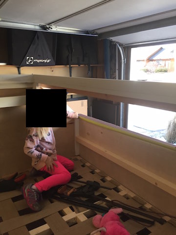

Fast forward a few months here. This is what how the front panels mounted onto the kickout. There are some interior blocking in the corners as well across the front. It's also glued with a lot of PL Premium. It's surprisingly solid and doesn't flex at all. All the round dots you can see are holes in the foam where I screwed cabinet head screws through the foam to pull the plywood tight with the interior braces and cabinets. They were filled with PL Premium and then sanded smooth before applying PMF.
25 copy.jpg (47.49 KiB) Viewed 3664 times
The whole family got involved, whether they liked it or not!
20b copy.jpg (33.7 KiB) Viewed 3664 times

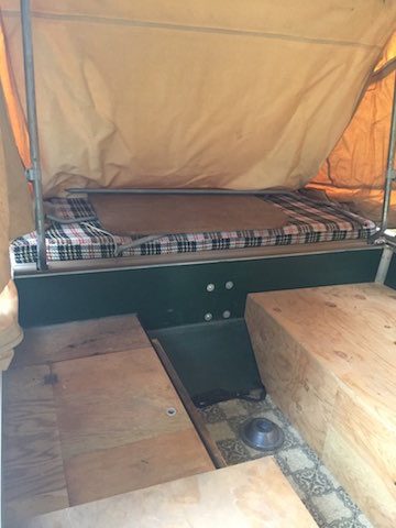

Bed from the inside
21 copy.jpg (26.82 KiB) Viewed 3663 times

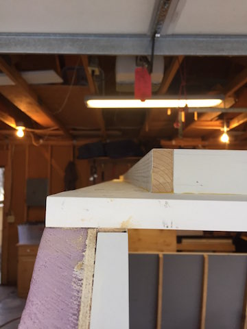

Sketchup design of the top edge. This would give me a drip edge to attach the canvas and support the roof when closed.
Screen Shot 2019-06-17 at 11.42.39 AM.png (31.61 KiB) Viewed 3663 times
How it turned out.
roof edge picture
20c copy.jpg (29.28 KiB) Viewed 3663 times

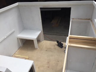

The back wall was framed a bit more traditionally. The door frame is made of actual 1" x 2" and a single piece of 1/4" plywood. 1" foam was later added to the inset create a smooth rear wall. I also purchased a door from Ebay. The door frame is 44" tall x 33" wide.
20a copy.jpg (21.67 KiB) Viewed 3658 times

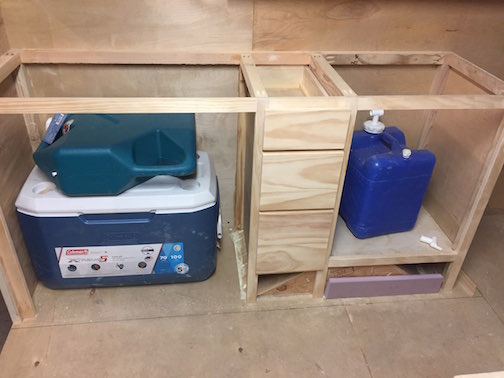

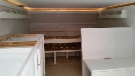

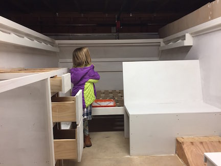

Interior cabinetry is a mix of 2" x 2" and 1" x 2". Again every joint is glued and screwed. Pocket hole screws pulled it together very nicely and the entire unit is built into the wall which added a lot of rigidity to the exterior structure. Keeping it simple with a water jug and cooler.
35aaa copy.jpg (37.39 KiB) Viewed 3658 times
Here's the interior covered with a layer of primer. On the top edges you can see the storage boxes that run along each side of the camper. This feature probably gets the most compliments, second to "Oh my gosh, you built a camper!" There are 10 small boxes that are perfect for storing all the miscellaneous stuff that gets thrown around when camping. Books, keys, flashlights, cell phones, utensils, anything and everything. The kicker is it also helps add rigidity to the walls.

The bed is looking good and most importantly functions as it should.

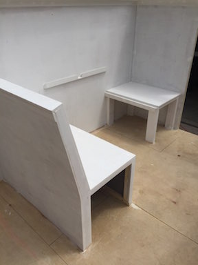

The benches are attached to the wall and assist with rigidity. The longer one is about 36" wide and will fit two smaller adults side by side, works perfect for an adult and child. The back of the bench arches to make it more comfortable. In the down position, the bed butts up against the back of the bench at the level of the seat. The smaller bench is perfect for one person. Both are hollow underneath for storage. Notice the cleat on the wall for the table.
37b copy.jpg (16.8 KiB) Viewed 3654 times
37a copy.jpg (16.53 KiB) Viewed 3654 times

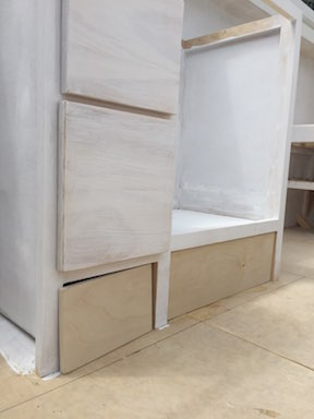

Not an inch of space was wasted. Behind these magnetic covers are small pockets around the wheel well. They are storage for extra 1 lb propane tanks and also a few other rarely used items.

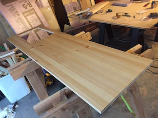

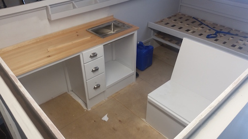

The counter top is 72" x 24" x 1" thick pine pre-made from Lowes for $25. It was the perfect size and all we did was cut a hole for the sink then sand and cover with a clear layer of polyurethane. We're very happy with how it turned out.
40 copy.jpg (26.7 KiB) Viewed 3631 times
Here it is with the sink installed. Also, notice on the floor the small round black object. That's a marine foot pump for the sink. I don't have many pictures of the sink system, but we ended up with a 7 gallon freshwater tank under the sink operated by the foot pump and a 3 gallon waste tank also under the sink. There is a valve that direct dirty water to bypass the tank and drain outside depending on where we're camped.
41 copy.jpg (58.89 KiB) Viewed 3631 times

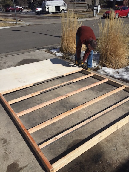

Hands down the most stressful part of the entire project was the roof. I spent many hours with a pencil and paper trying to figure out how build a 36 inch lifting system for the large 10 ft x 6.5 ft roof. I didn't have the budget for a pre-made lift mechanism and had zero fiberglass experience. I doubted a foam roof would be stiff or strong enough to hold the canvas taught. In the end I decided to frame it with wood and waterproof with PMF. Aluminum would have been nice but wood was so much more affordable. It's overbuilt and heavy. At 140 lbs it felt lighter than the roof that came off the old Palomino popup.
It's built a lot like a wall. 2x4's on the edges, 2x2's 16" on center, and sandwiched with 1/4" plywood inside and out. Voids between the 2x2's are filled with 1.5 inch XPS foam.
45 copy.jpg (101.38 KiB) Viewed 3629 times
