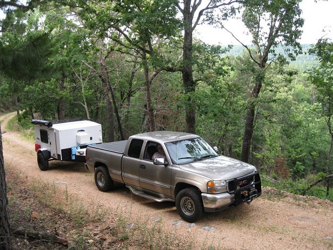

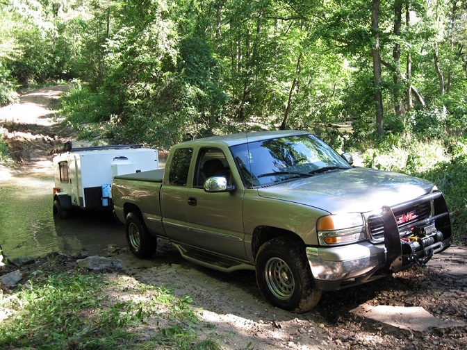

new guy to forum, own a 2019 Runaway Range Runner that I done ton of modifications & fabrication work to change it to offroad. Fabracted new tongue: longer, heavier w\articulating coupler & hitch (Lock n Roll), removed the original suspension springs & hangers, installed longer leafs, heavier hangers, Dexter Axle Flip Kit, & shocks. Wired for 12v & shoreline 110. Solar is Renogy 30 amp Charge Controller, 100 watt Renogy Portable Folding Panel, Battery: VMax Tank 125ah AGM, 55amp Powermax Converter Charger. The rear of the trailer as a large 40x40 rear door I built the dividing wall that sperates the sleeping & storage area. Swing away spare tire carrier with drop down table. I done all the interior work.
We do 95% offroad dispersed camping, 5 % Rv public grounds with our son & his family.
