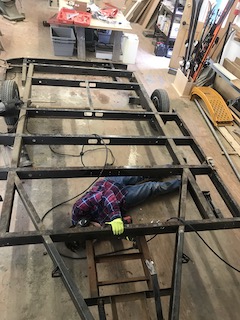

My son Winslow and I are planning to build a teardrop for him, as a father/son project. His older sister and I finished her project a couple years ago, and now it's his turn.
So far we've scavenged a frame from a pop-up trailer, and we've been cutting and grinding away at that to prepare it for our ~5x9' tear (Win likes the kit profile, so that's what direction we're headed.) That's him underneath.
The boat took us about 18 months (kids are busy these days) so we hope to follow a similar timeframe and get Win's teardrop ready for summer 2021.

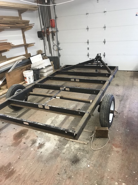

Postby nrhmaine » Sat Dec 17, 2022 7:59 pm
Well, a couple years without any action on this, but finally getting to it!
Got the axle mounts welded on a couple weeks ago, as well as brackets for the rear stabilizers, and coated the frame in Por15.
Now spending what feels like way too much time tracking down parts and finalizing build plans. Hope to put together a floor this weekend! I've spent days researching sources for 5' wide anodized or painted aluminum, all to basically come around to the idea that having seams in the roof is fine, and that'll give me more flexibility and make sourcing the skin a lot easier.
We're planning a layout that's similar to VISTABULE trailers (headboard aft, fairly symmetrical profile) with a fixed window high on the front/roof, and using a convertible couch mattress so the interior can be used for lounging as well as sleeping. Easy cooking and ease of set-up/breakdown are priorities, so we're planning a slide-out in the galley with a camp chef oven/2-burner range, and a small sink with pressure water (or foot pump, perhaps both, like on boats).

Postby nrhmaine » Mon Dec 19, 2022 6:44 pm
Yesterday the teenager finally got out of bed at 1pm, in time for a few hours of work together.
We packed bearings and installed new hubs (to accommodate larger wheels), and mocked up the galley layout on the workbench.
(Stove/oven pullout to port. Cooler pullout to starboard. Sink in blue.)
