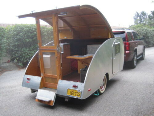

After I bought my '93 Ford Ranger with its 3L V6 and discovered that it is not actually an ideal tow vehicle for camping rigs, and I started finding variations on a theme of "maybe Ricky could still pull this" (Ricky is the truck...you know; "Ranger Rick..." Waka waka), I ran across an ebay ad for a 1949 Kamp Master, and thought, "Hmm...I wonder of a version of that could be made without using canvas?"
A teardrop with the galley inside
s-l500 5.jpg (37.75 KiB) Viewed 1523 times
Note the side access
s-l500 6.jpg (30.94 KiB) Viewed 1523 times

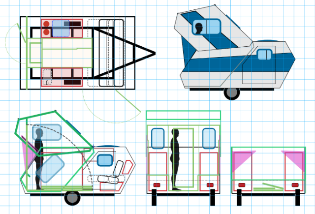

The idea I have attempted to sketch out is mounted to an Ironton 5x8 utility trailer, with a 1 foot extension of floor in each direction for 7x10 space. Someone was telling me that instead of this I ought to simply have the entire top raise up, which has its pros and cons (the biggest con so far is working out the mechanism for lifting it; there's also the issue of the side access which I like for the idea of crawling in for a nap without having to set up the whole rig, which would be blocked by a full area hardside pop up), and I haven't gotten a drawing of that, yet, that I like well enough to share. This is the idea I had for the home skillet version of the Kamp Master:

The biggest issue that jumps at me is ensuring the lifting portion is sealed in both the down and up configuration. Envision 60 mph in heavy rain.
You may also want to look at the backing clearance in a tight turn during a nearly jackknife with the tow vehicle. I'm not sure you'll have enough distance without contacting the vehicle.
You might also look at moving the axle back to ensure safe towing.
There are a lot of folks –-me included-- that believe curved profiles are easier to build than angular ones. Angled ones are certainly easier to draw... :thinking:
You do have an interesting design going. There have been succesful pop-up builds on this forum.

As a novice builder myself, I’m gonna say that is an ambitious build. While Tony and many others here could tackle that with ease, fir me the challenges I’d have would include
1) Tools- good cuts and straight cuts are impacted by the quality and options available to make the cuts. I did my work primarily with 18v rechargeable tools, and it shows.
2) space and time. - if you look through the build threads you will find it takes many hours, I put over 200 hours into mine before it was campable. It will take space, and more challenging builds take more space because you need to make jigs and potentially other tools to make sure you get things right.
3)experience, knowing which tool to use, and which joint to use comes from experience. If you build the standard builds people can help, but something unusual is going to create new issues you may not even be aware of for a couple of years,
As one novice to another, I’d suggest sticking with a standard design to start.
