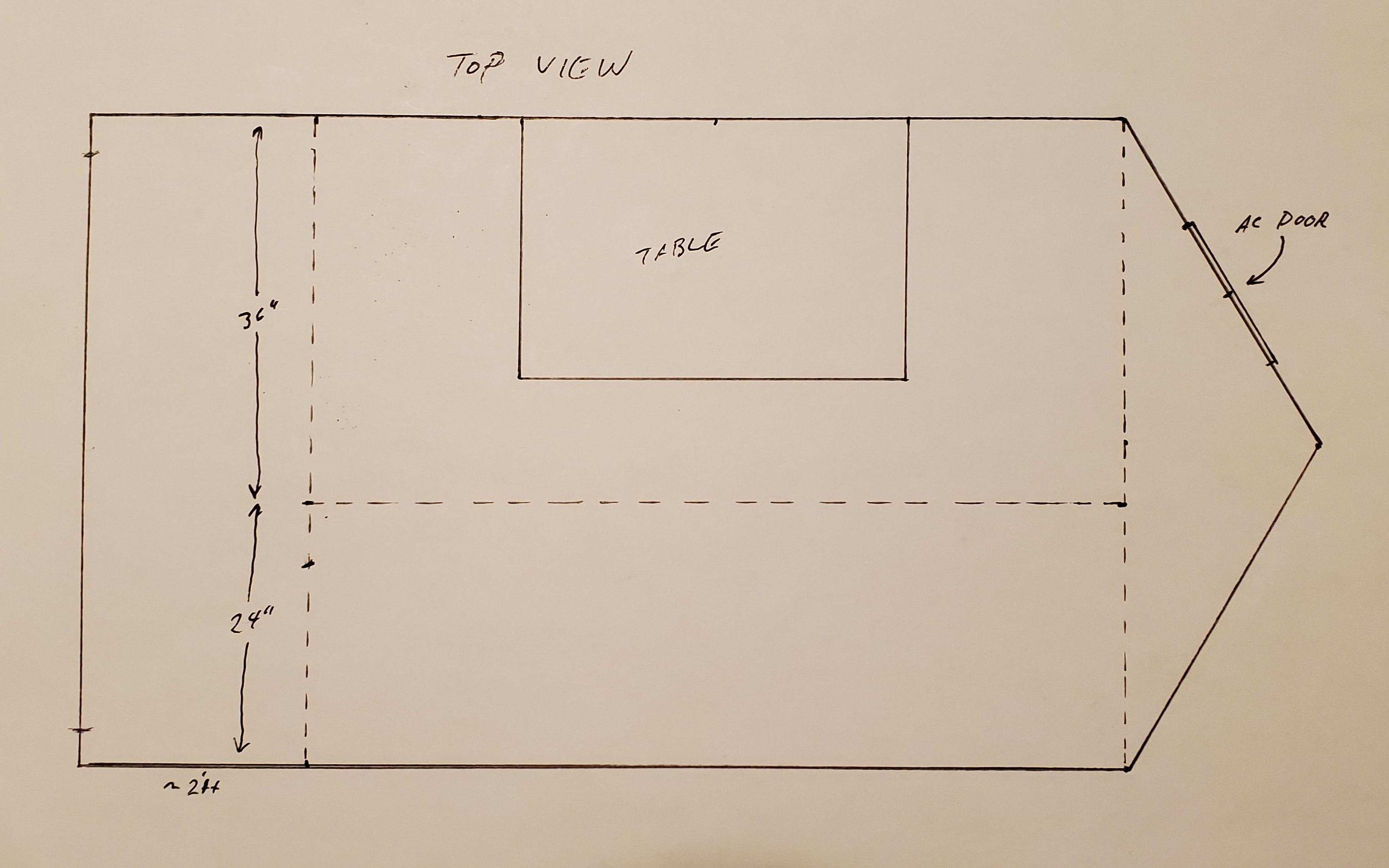

So here's my plan:
- Insulate the walls and ceiling with pink foil sheets
- Install 2 windows. one on the passenger side, one in the rear (barn) door.
- Install an access panel in the front v big enough for a small 5k btu window AC (I wish climateright was still an option)
- Build an upper cabinet and counter top in the v.
- LED house lights
- Rhino rack batwing awning
- On the driver side, there will be ~36" bed platform hinged to the wall, on the passenger side it will be ~24", if the passenger side folded down it will serve as a couch base, I will build a hinged table on the drivers side that will swing up/down.
- Mattress will be a double size folding mattress/couch
- Going to do a straight pass through for AC power, either from my 2000W genset or campground
- For a house battery I'm going to use a bluetti or Jackery 500W power center that I will recharge using the built in inverter in my car. The lights i have picked out will run DC, or AC with a wall wart (Black and decker under cabinet lighting).
- Just going to do a yeti cooler, and a colman road trip or weber Q for cooking, but for races, it's really just a place to sleep.
Thoughts or ideas?

Postby pchast » Fri Aug 07, 2020 9:20 pm
Sounds like a good basic plan. Execution can
be the tough part, keeping it light and functional. :thumbsup:
