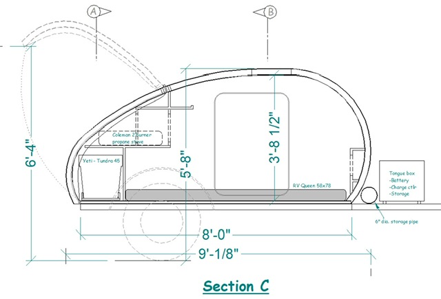

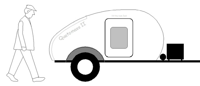

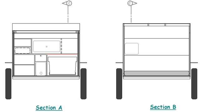

I’ve been lurking here and dreaming of building a Teardrop for a while now. After ordering and reading Tony Latham’s book, I’m getting much more serious about it. It has made me realize that I can do it and I can incorporate all the features I want on 5’x8’ frame. The two most important are a queen size mattress and an on-board cooler in the galley on a slide out. Not possible when you’re only looking at a plan view. So, I started sketching a cross section and came up with this. It’s a work in progress but I’d love some feedback on it. Much of the galley and cabin design can’t really be finalized until I get more measurements on everything I plan to pack. One thing I’m concerned about is the tight radius on the inside of the hatch at the low end. As it’s drawn it’s about 16”. Is that too tight for 1/8” plywood to bend?
Thanks in advance for any constructive criticism you might have.
Rob

You can make that bed with 1/8" Baltic (assuming you can find it) if you bend with the grain and not against it.
What jumps out is that the hatch gussets are interfering with your countertop and upper storage structure ––but good on you for drawing them in.
I'm not sure about your upper galley shelf, but there may not be room for struts.
(I drew in the red line previously to show that the strut needs to be installed so it's below the centerline of the hinge. So disregard it for now. Just make sure you do it that way.)
p.s. A 60" x 80" queen mattress will fit in there fine. If you trim it down, it'll scoot around.

tony.latham wrote:Rob:
Thanks so much for the feedback! You're right about the interference and I'm thinking about ways to resolve it. I just need time on the computer to sketch out what I'm thinking. I think if I reduce the down angle of the hatch a little it would make that low end curve a little easier to manage and give me a bit more room to work with. I'm also going to re-read your chapter on strut design and rough that out so I know what I need to work around for the shelf and counter. I want to make the galley as simple and practical as possible which should help keep the weight down too. My TV is a Toyota Rav4 Hybrid with a max towing weight of 1750 lbs but I want to weigh in at less than 1000 lbs if I can.
