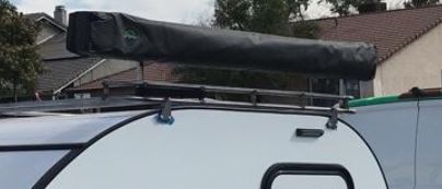

I think roof racks need to be tied to the walls, not the roof. So-Cal makes brackets for teardrop roof racks. Thule makes their artificial gutters for their racks.

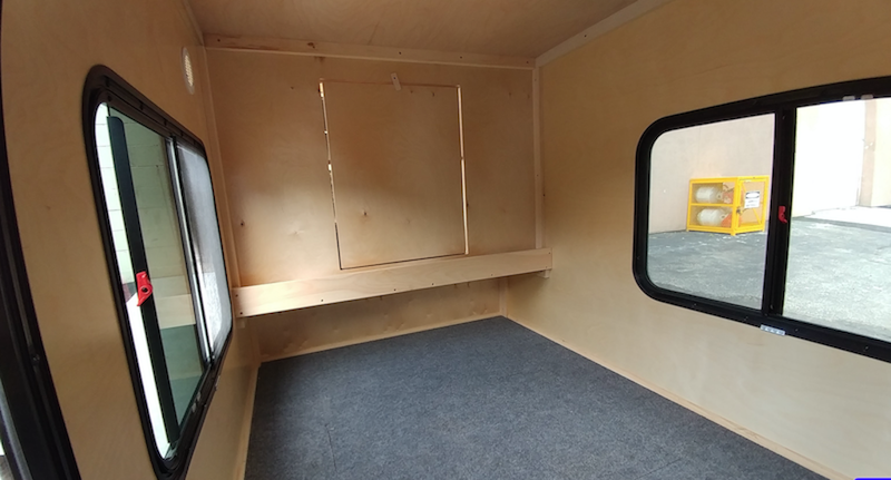

So I looked at MMT website and apparently the wall construction is solid 3/4" ply covered in aluminum. That's good for you in that within limits, you can attach it anywhere. Is that how you trailer is built; solid walls with aluminum on the outside?

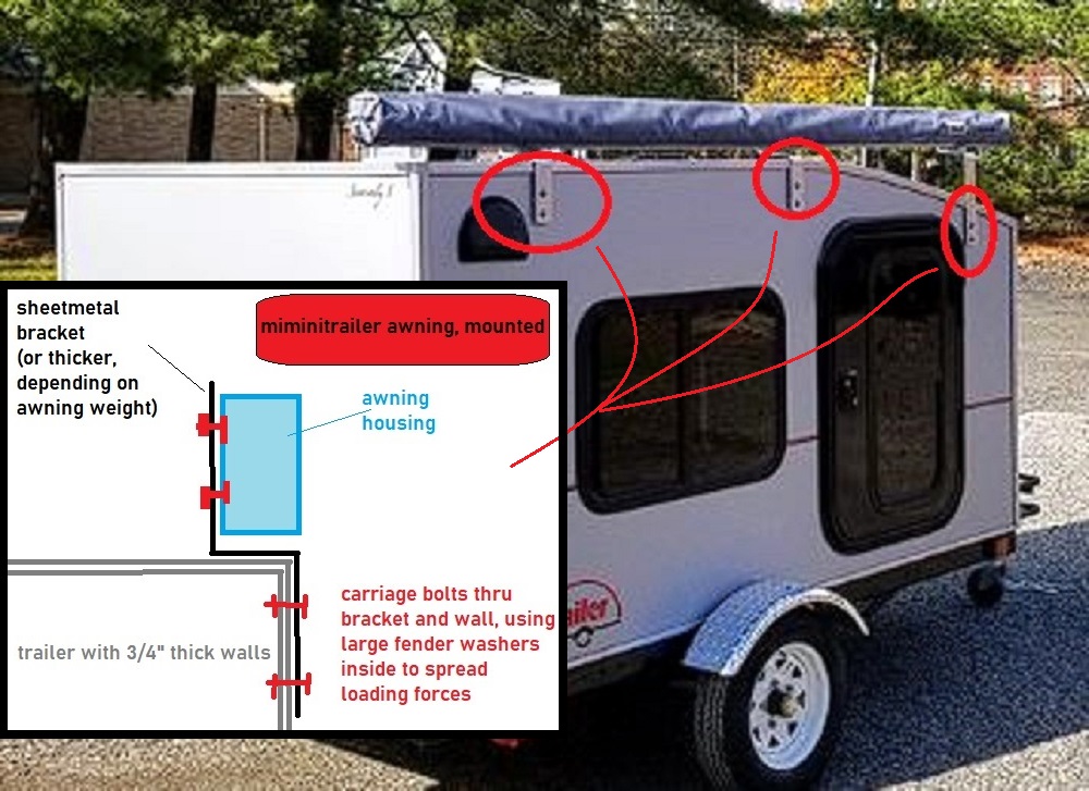

If the walls are 3/4" plywood, then you'll have plenty of strength to attach simple brackets thru the walls (not roof).
from their website
minitrailer with awning.JPG (221.84 KiB) Viewed 1617 times

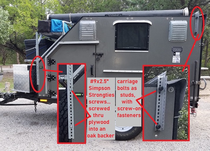

I have a 3/4" plywood squareback trailer, and I used leftover materials to make racks & supports, and carriage bolts and construction screws (all available at your local big box, orange or blue, store).
not pretty, but cheap and functional
rack brackets made from scrap, attached using leftover fasteners.jpg (211.66 KiB) Viewed 1617 times
Or you can get some aluminum or steel flat stock from the same store, and make nicer ones yourself at home.

The only thing I would add to the above drawing is to add some type of rubber or plastic gaskets or spacers between the brackets and the sides of the trailer. You'll get galvanic corrosion eventually if there is any steel to aluminum contact.

This is so reassuring. I did look at his website and took a few screenshots of his camper photo's just for reference but I never thought to look at any details he might have written on his website. Is that what you are referencing AND also showing me the photo's or just going off of photo's? Yes my camper is aluminum outside and inside is solid plywood inside.

It looks like you'll need someone who can fabricate some brackets similar to the drawing above. I think your installer could bend some offset brackets in a vise, this isn't precision work. I would try to pick mounting points that aren't directly over a window or door.

If it were me, I'd bolt (not screw) Thule artificial rain gutter brackets to the walls at the prescribed distances in the manual and purchase either Thule or Yakima racks with feet that will fit rain gutters. Both companies make them. Make sure the U-bolts in the kit will fit the bars.
I'd seal the bolt holes with oil-based polyurethane varnish, let them dry, and add a bit of Lexel sealant while installing. The brackets come with gaskets, but I'd add the Lexel--not silicone.
