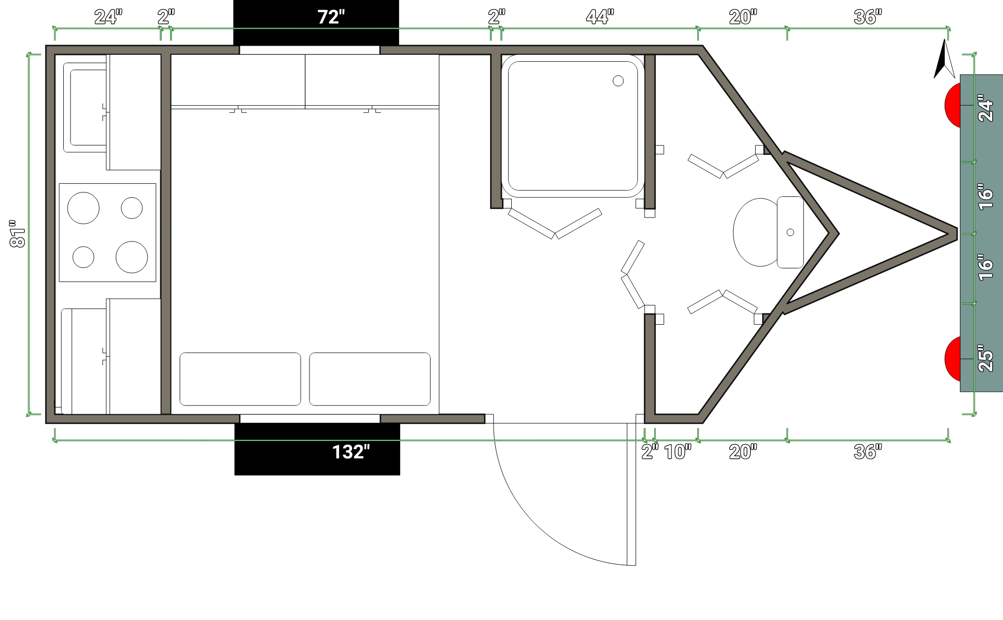

Yeah, that's exactly what I was hoping for was experience. If everyone was saying that they are going through a set of tires every 500 miles, crazy swaying above 50 mph, or broken axles on single axle trailers below 3500# then I would have went with a tandem axle.
If I attached it correctly, there should be a Floorplan that I put together in a 7'x12' body with a 31" v-nose. I won't be hauling any toys, just a place to "camp".
CHMLEON

Postby hankaye » Thu Jun 04, 2015 10:05 am
CHMLEON, Howdy;
Of course you would use a computer program to do the art work ...
told ya my meds were kickin' in.
Looks like you have a nice plan. What types of items do you plan for
the voids on either side of the commode?
hank

Postby CHMLEON » Thu Jun 04, 2015 11:14 am
Lol... I've been working though designs for a bit. My original started as a 7x16 but I had to shave some weight off when I discovered that my manual transmission Liberty had a max tow capacity of 3500#.
Both the spaces will be closet/utilities. The space to the right of the commode will probably be a closet/plumbing. The space to the left of the commode will probably be a closet/electrical. I also intended to have a 80"x60"x18" utility/storage space under the Queen size bed. I'll have shocks mounted under the bed to assist in the bed lifting process.
