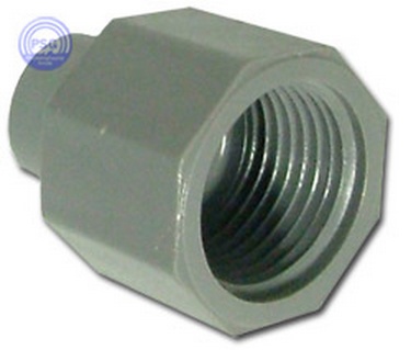

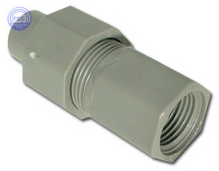

On the faucet connection. I thought maybe just two of the Qest nuts would work but wasn't sure. I'll include a couple of pictures. One of the nut. One of the female to male adapter.

The nuts are the right thread but won't seal against the bottom of the faucet nipple, the coupler as you have pictured with the nut will.

So the female adapter is the one I need. That is helpful. I ordered all the Qest stuff saturday. It hasn't been processed over the weekend. I'll try calling them monday morning and see if I can add those to the order and get it in one box.

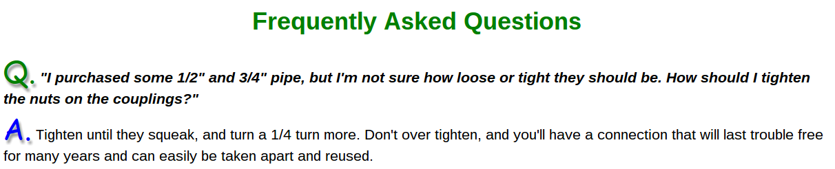

Couple of notes I found about Qest fitting installation:

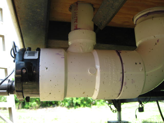

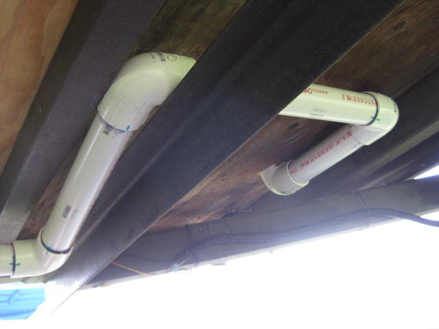

Postby Trailmate » Sun Jun 14, 2015 10:43 am

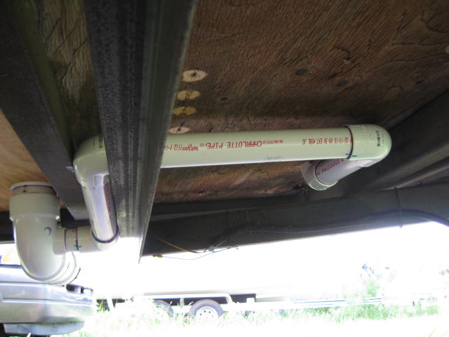

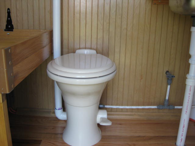

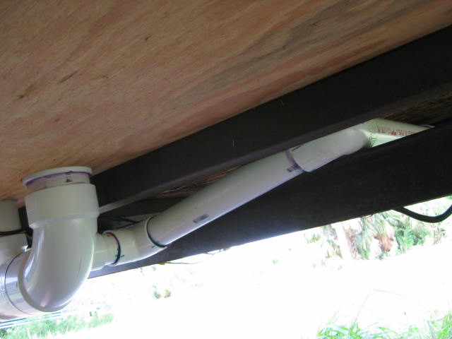

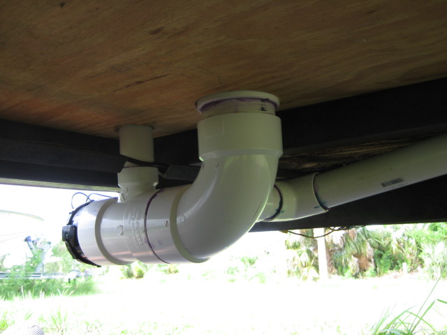

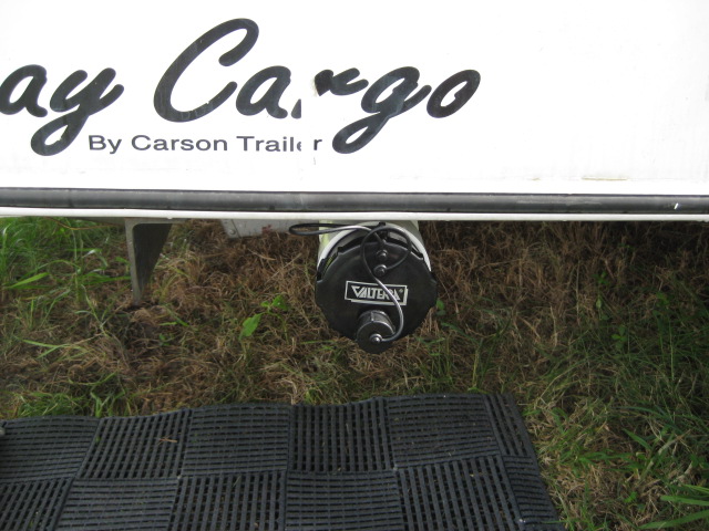

I've got the plumbing done underneath the trailer so I'm posting some pics of it. I'm aware that there needs to be clearance between the pipes and anything that could chafe them. Couple of areas that were close. I'll keep an eye on them. This was tricky but I came up with the best solution I could think of. The 1.5 inch is the sink drain. It is connected to the side inlet of the 3 inch elbow of the toilet drain. There is a 3" x 1.5" tee connected to the 3" elbow. The 1.5" outlet on the 3" tee is facing up for a vertical stack vent that will run from the floor and exit the roof of the trailer. When I get that installed I'll post some pictures of it.
Trailmate
Posts: 30
Joined: Thu May 07, 2015 4:52 pm
Re: 6x10 Hiway Cargo plumbing
Postby Trailmate » Sun Jun 14, 2015 10:53 am

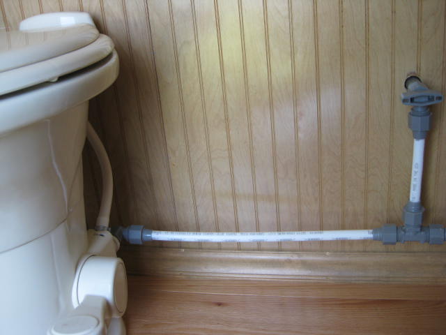

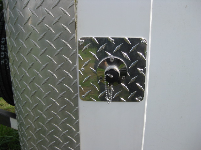

Here are a couple more and a couple pics of the water inlet. I've got the inlet lines installed. When I have the stack vent in and the toilet put back, I'll post some pictures of the water inlet plumbing, the vent and the sink drain. This is obviously not a conventional setup so only time and usage will determine how well it works and I'll report on it in the future.

Postby Trailmate » Sun Jun 14, 2015 10:55 am
The shiny stainless water inlet:

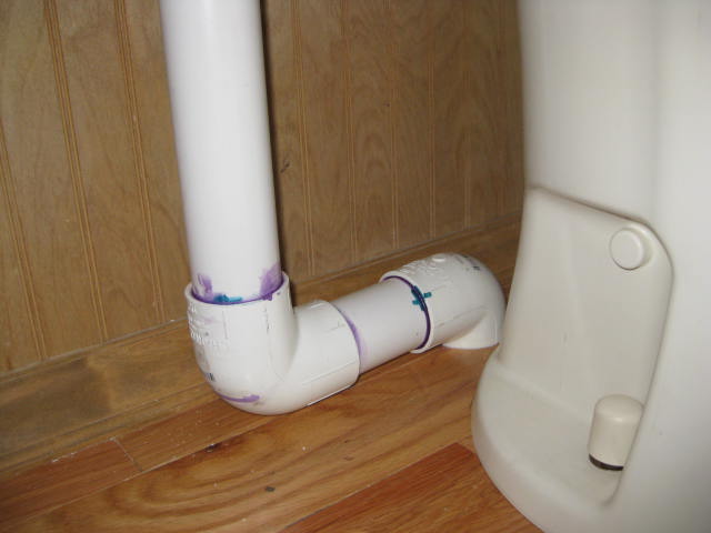

Postby Trailmate » Sat Jun 20, 2015 3:15 pm

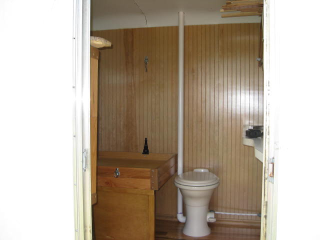

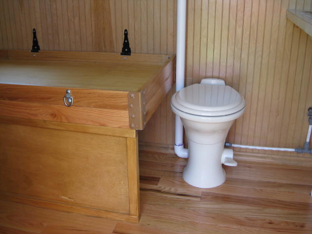

Here are some pictures of the stack vent:

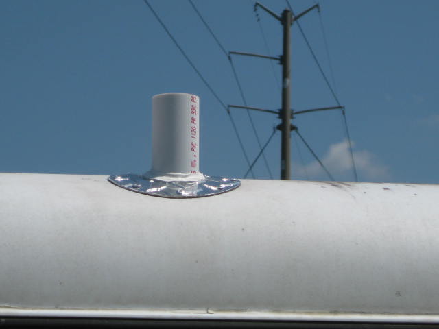

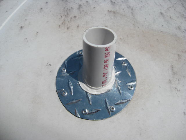

Postby Trailmate » Sat Jun 20, 2015 3:18 pm
Vent pipe on roof:

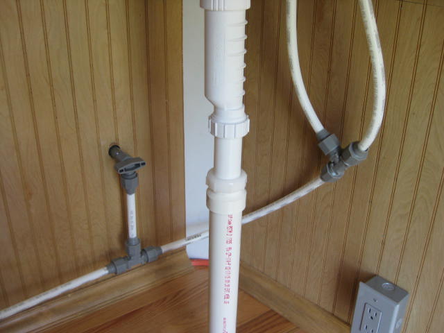

Here's a few of the water lines:

Postby hankaye » Sat Jun 20, 2015 11:11 pm
Trailmate, Howdy;
You may want to get ahold of one of these to dress up the top of the vent pipe.
Buyers choise...
https://www.google.com/search?q=RV+vent ... 80&bih=699
hank

Postby Trailmate » Sun Jun 21, 2015 6:31 am
Thanks guys! Tom, here is the closet flange I used: http://www.homedepot.com/p/Sioux-Chief- ... /202313218
I've done all the work on this outdoors in a private trailer storage area so I don't have water to it to test the system. The flange appeared to be a perfect fit for the dometic 310. I'll haul the trailer to the house to test the plumbing soon and, eventually, the ultimate test will be at a campsite and I'll report my findings.
Hank, thanks for the link. I was contemplating some sort of cover for the vent.
