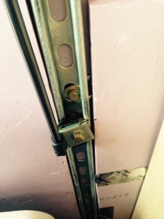

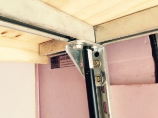

-so I've stole your ideas on the unistrut bed, I ended up using gas struts vs ropes to offset the weight and it works fairly well, so thanks for the contribution! That said I get some binding between the bed frame and the vertical rail during movement if it flexes or one end is raised above the other. I'm curious if you physically have the bed frame attached to the vertical rail, or just have the supports it sits on attached.
Cheers.
wanabxtrm
Posts: 100
Joined: Thu Aug 14, 2014 3:53 am
Re: 6x14-V Featherlite Horse Trailer Conversion
Postby Hiflyer » Sun Aug 30, 2015 11:50 pm
wanabxtrm wrote:-so I've stole your ideas on the unistrut bed, I ended up using gas struts vs ropes to offset the weight and it works fairly well, so thanks for the contribution! That said I get some binding between the bed frame and the vertical rail during movement if it flexes or one end is raised above the other. I'm curious if you physically have the bed frame attached to the vertical rail, or just have the supports it sits on attached.
Cheers.
The bed is a floating frame that just sits on the 4 support brackets
I use Allen key bolts that are round and slot right into the unistrut bracket holes "locking" it into place
I also run 3 runners between the sides to support the plywood / mattress. 2 wasn't enough
i also tied in the plywood via the 4 eyelets thru the plywood and unistrut - one on each corner
Got any pics of your setup?

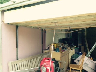

Postby wanabxtrm » Sun Sep 06, 2015 7:24 pm
I think I have mine worked out but still have some binding issues if they get out of alignment. In the end I over estimated the bed weight so I need to physically pull it down vice pushing it up. Extended I can walk underneath. Compressed I can sit under, and still have enough space overhead to lie in it. Haven't camped in it yet (still under construction) but if the range of motion proves to small I'll double up the struts by tiring them end to end to double the range of motion.
wanabxtrm
Posts: 100
Postby Hiflyer » Mon Sep 07, 2015 12:24 am
Looks good - very well done :)
