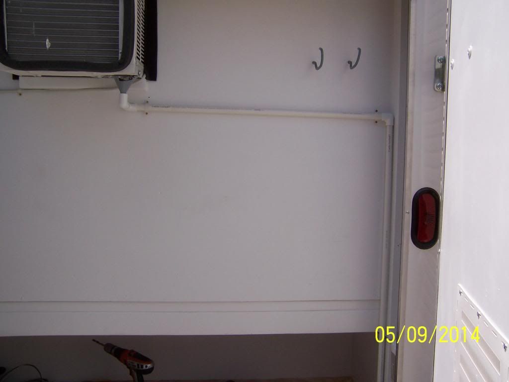

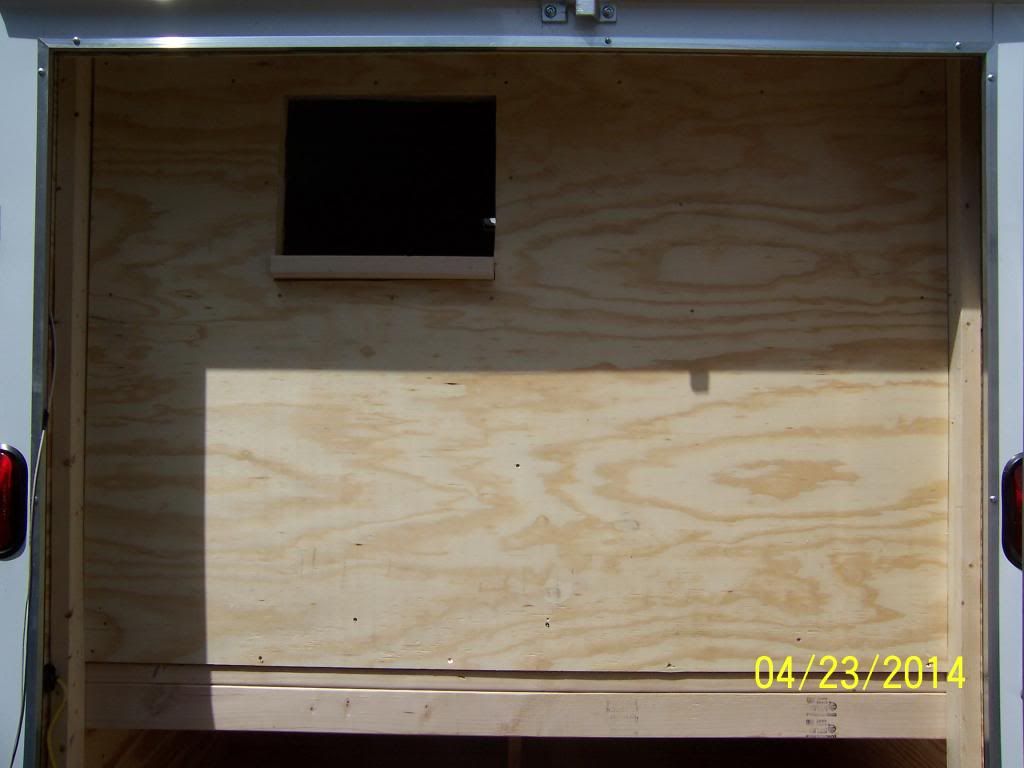

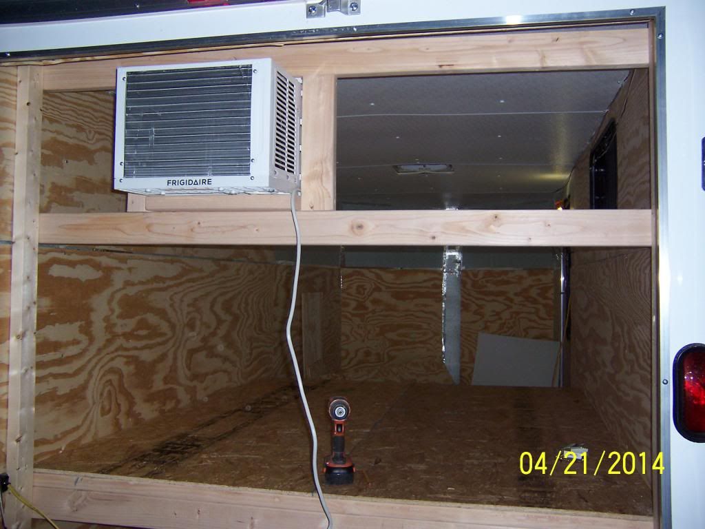

Also chek out my AC solution. You say you don't think 5K is big enough - remember, a 5K unit is designed for something at least three times the size of your trailer, so if you're insulated, it shouldn't be an issue. My 5K unit draws only just a little over 400 Watts.
