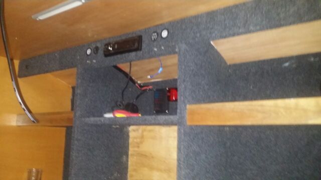

From what I've found dc fuse boxes are a bastard to adapt to our style projects.
They were never designed to even come close to meeting our requirements.
Ive actualy purchased 3 different fuse boxes totaling around 120 bucks not to mention all the connectors and wiring ive changed in the process.
The major issue is any fuse box for a standard dc system is each circuit is grounded near it's location with is impossible on a foam or wood build.
You need a bus bar and/or you need one of 3 types of fuse box styles.
Single positive feed. Makes foe easy wiring but generaly no thought in design as far as placing in a position where they look tidy and the positive wires generaly enter from the front connected by spade terminals.
2 the same thing but with a negative busbar attached also as previously mentioned but if they don't have a single pos/new feed there is alot!of wiring involved.
Or there is what I reluctantly settled on witch is individually fed positive circuits fed from behind and a seperate negitive bus bar.
This I have been c hoping and changing in for months but mostly because I hate electrical work with a passion.
This option looks realy smart and it isn't that hard to make the positive side tidy but once I wired up the negative it looks crap.
But from the only side you'll see unlsess you remove the inspection pannel it Profesional looking and clean.
You can sort of see it there and the black and red boxes are positive and negitive bus bars to help tidy up the install.
If it was a steel structure that these fuse boxes are designed for you could terminate the earth next to each conection eliminating so much work
