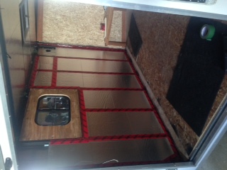

I went with 2 sheets instead of one,I didn't think it was costing that much more to go overkill on the insulation.
I made sure I cut them so it was a really tight fit between the studs also 2 layers made it flush.
I also used gray duct tape and sealed every all the seams, then replace the wood panels and covered the walls with thick flouring carpet, not so much for extra insulation but I was going for a
high end man cave look.
I didn't do any flour insulation but I did add the extra thick hardwood type flooring.
