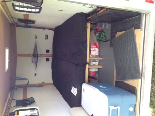

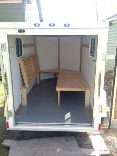

viewtopic.php?t=68016
have a look at the way i set up my bunk in my 5x8. it's been a while since i've updated my build but i've installed strip led lights with remote controls, solar exterior led motion lights, 12v cig plugs, usb charge ports and computer fans for ventilation. i use a 400amp booster pack for it's versitility and a 40 watt solar panel to keep it charged up.

Postby onehoser » Sat Jan 20, 2018 11:35 am
a better shot of the interior

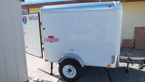

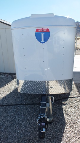

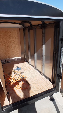

Postby CaleyAnn » Mon Jan 22, 2018 3:34 pm
I've been getting help in various places on the Forum. One person said, need pictures to help better, so here are three.
One is the inside. I already took one side panel off. All I can say is what a pain that was, as I had to remove all the strips of border the manufacturer put on in order to get the main panel off. The sides have U shaped recesses along the U shape structural brace. This should allow me to just slide the foam insulation in, if I can bend it enough to get it started.
The second is of the side showing both the tongue and door. As you can see, what I thought I remembered as a V shaped tongue, is actually just a very thick single bar, and it is very short. Withe the optional front jack I had installed, there may be difficulty in placing some kind of utility box astride that single tongue.
The third picture is just a frontal view, again of the single tongue. CaleyAnn
EDITED: Sorry for the pictures being in the wrong order. I didn't understand just how to upload them. But I guess they will do.
