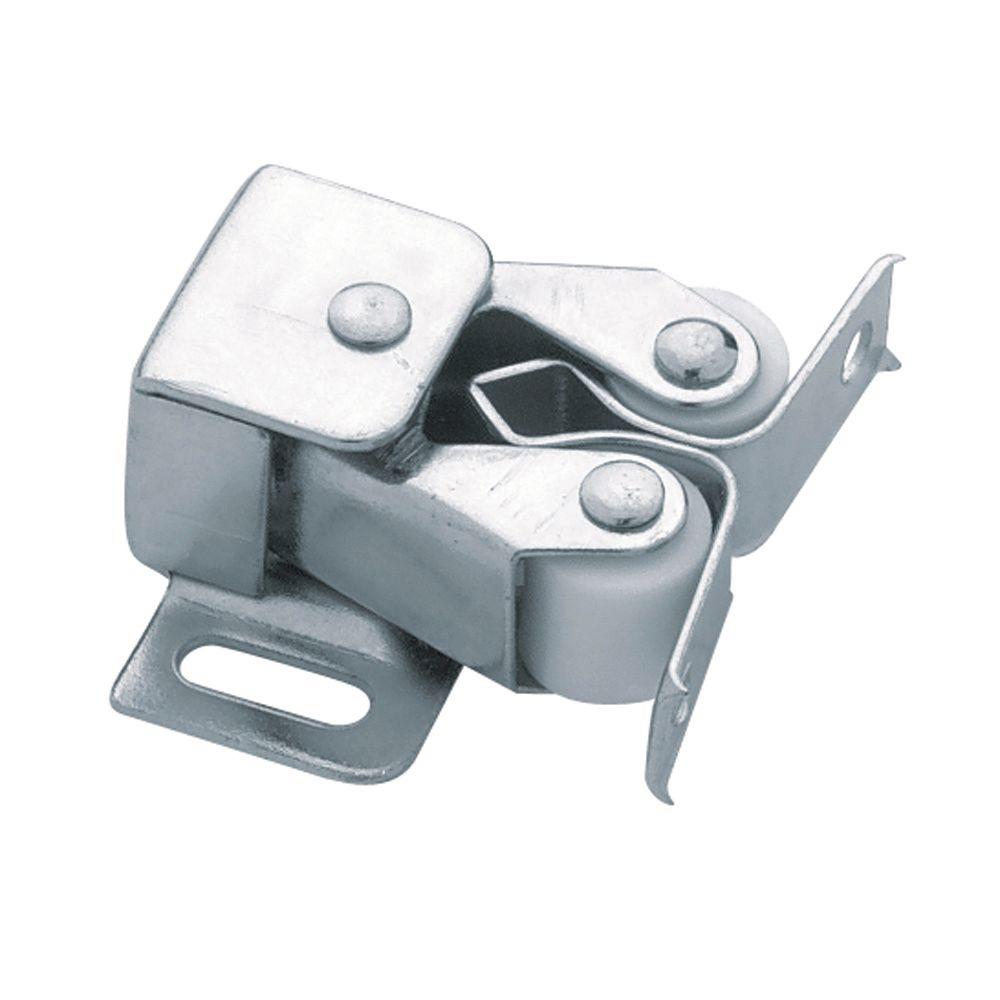

flboy wrote:Really looking nice. I was noticing the bungees and thought you may be using them to hold cabinet doors shut. Some ideas that worked for me. In any case, there are other types of baby locks also and they will keep cabinet door and drawers closed on the road. You can also find these types at Wal-Mart in the baby section.
I found these work well for the cabinet doors and can go across your knobs and hold then together also:
I have these installed on the lower cabinet doors, they hold well but I use the bungee cords just for extra piece of mind. I am putting them on the upper doors as well. The drawer on the base cabinet does not have anything holding it closed so I may look into the ones you suggested for the drawers. For now I use the bungee.
Cabinet Latches
