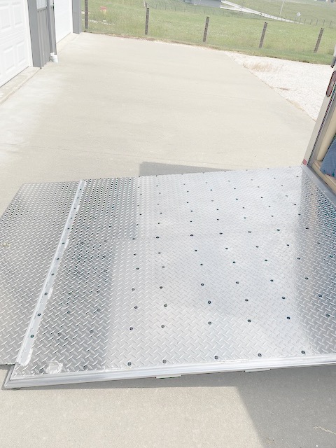

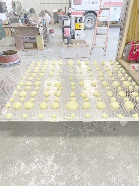

Postby featherliteCT1 » Sat Jun 03, 2023 2:25 pm
IMG_4228 188 holes filled.jpeg (131.97 KiB) Viewed 1673 times
IMG_4230 seepage.jpeg (72.27 KiB) Viewed 1673 times
IMG_4234 black rivets.jpeg (101.64 KiB) Viewed 1673 times
For a long time, I have wanted to insulate the ramp door on my trailer with sheets of polyiso insulation, like the rest of the trailer. So, a friend helped me grind off all the welds and rivets affixing the 1/4 inch aluminum diamond plate to the door framing. After grinding off all the welds and drilling out all the rivets, we discovered that the plate is also welded onto the framing from the inside. Consequently, we could not remove the plate.
However, the time was not wasted because we were able to lift the plate up around the edges just high enough to peek inside with a flashlight to see where the framing is located. All of the the framing is aluminum square tubing.
So, we decided to drill about 188 holes in the plate in order to inject 20 cans of window and door type spray foam insulation into the panel voids as well as into all of the square tubing.
We drilled so many holes thinking that this would reduce the risk of blowing out the exterior skin. Notwithstanding, some of the foam seeped out of and slightly bulged the exterior seam. Not shown is where the foam seeped out and bulged the seam because we had already trimmed off the excess foam at the seam. I still need to caulk the seam which bulges out about 1/16 inch along a 12 inch long stretch of the seam.
Then we installed black plastic push rivets to close the holes.
Even though there is a thermal bridge connecting the exterior skin, the framing and the plate, I suspect that we made a significant improvement. I will watch for condensation forming on the inside where the thermal bridges exist.

Postby flboy » Sun Jun 04, 2023 7:29 am
Wow, looks like that was alot of work. Did the foam clean up well off the deck? That stuff is so messy. Glad you got it done in any case.
Is that your shop? Looks nice and big.
Sent from my SM-N970U using Tapatalk
Don (Flboy)
https://youtu.be/6_-8cVdWUIA
https://youtu.be/MUcMM86LA2g
flboy
Posts: 4269
Images: 378
Re: 7x16x6.5 Featherlite Build
Postby featherliteCT1 » Sun Jun 04, 2023 11:02 am
Yes, there was much more work than I had anticipated. It took us about three days.
On the first day we tried to remove the plate and ended up spending most of the day drilling all 188 holes. It took about one minute to drill each hole (188 holes x 1 minute/hole = 3 man hours of drilling).
On the second day, we spent half the day finding and buying the foam and filling the holes with the foam. Then the foam had to set up overnight before we could peel off the blobs.
On the third day, we spent half the day cleaning off the residual foam with acetone.
The residual foam came off fairly easy with acetone, but it still took about two minutes of scrubbing with a rag, per hole (188 holes x 2 minutes/hole = 6 man hours of scrubbing).
The foam from Lowes cost $11 per can. We used 20 cans (20 x $11= $220 of foam).
The shop is our company's shop that I have access to 24/7. Nice perk! :D
We install underground water and sewer lines for public works projects. We use lots of heavy equipment like: excavators, bull dozers, drilling machines, semi tractors, trailers and a whole lot of other miscellaneous stuff. Almost all our work is lump sum bid. We are blessed. :beautiful:

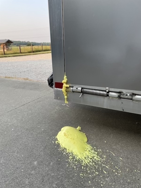

Postby featherliteCT1 » Thu Jun 08, 2023 7:38 pm
Even though we spray foamed the ramp seven days ago, today the trailer had a bout of severe diarrhea.
Bad Foam Leak Day 7.jpg (174.59 KiB) Viewed 1529 times
Which surprises me. :o
featherliteCT1
Posts: 1168
Location: Southern Indiana
Postby flboy » Thu Jun 08, 2023 7:42 pm
Wow.. must be airtight in there ' it never got a chance to cure.
Postby Modstock » Fri Jun 09, 2023 8:32 pm
Maybe poke through all the holes with a screwdriver, help release some trapped air or undried foam.

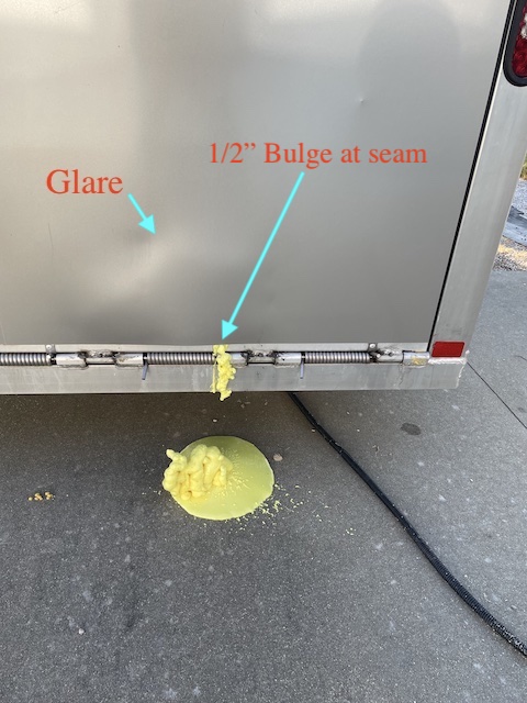

Postby featherliteCT1 » Sat Jun 10, 2023 12:42 pm
On the 10th after the installation of the foam, I saw more seepage in a second location. I watched the foam drip out onto the concrete. The foam has the consistency of soup.
230610 Foam Seapage Day 10.jpg (110.9 KiB) Viewed 1439 times

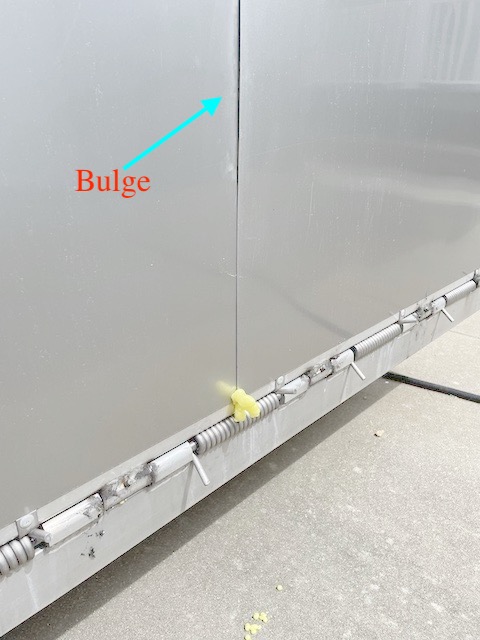

I removed one of the black plugs installed in the plate over the area of seepage. I noted that the foam is cured below and around the immediate surroundings of the hole; however, I am only able to probe the hole with a tool a distance of about 1/4 in all directions.
The first location of seepage after day 7 bulged the skin out about 1/8 inch at the bottom of the ramp. This second location of seepage after day 10 bulged the skin out about 1/2 inch at the very bottom of the ramp. The outer skin of the ramp door shows a slight amount of oil canning. The glare in the photo makes the slight bulge in the skin look way worse than it really is.
In each case, the seepage occurred after the ramp door was expoed to direct sunlight in the afternoon and heated up.
The foam spray is Great Stuff for windows and doors.
We shall see in the future if foam continues to leak out.
featherliteCT1
Posts: 1168
Postby bdosborn » Sat Jun 10, 2023 1:36 pm
When I was researching insulation for the van it was pretty common for the exterior sheet metal to get wavy with foam insulation. I don't think there's much you can do but wait till it all hardens.
