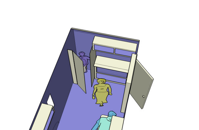

The Nose layout is the same for all of them and shown here.
A counter for cooking etc, and a private spot for a wag bag potty. Nothing fancy.

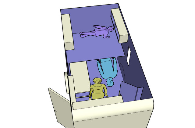

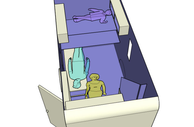

In the 6x12 I have a challenge in that I am 6'3" and don't fit across the trailer. So I cam up with two alternatives.
The girls would share a bunk, and my wife and I would take the floor or cots.
Same arrangement for my wife and I , but the girls each get a bunk. This also provides a small amount of additional living space, when in sleep mode.

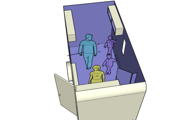

Bunks taken down for daytime use.

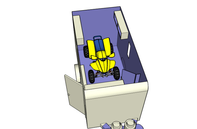

Used to haul a toy.

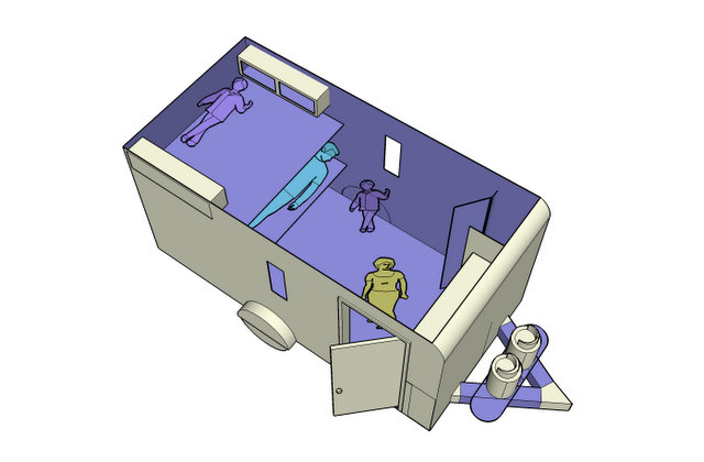

The next option is to go larger so that I can sleep across the trailer. I though a queen on the bottom, and a double on top for the girls to share.
