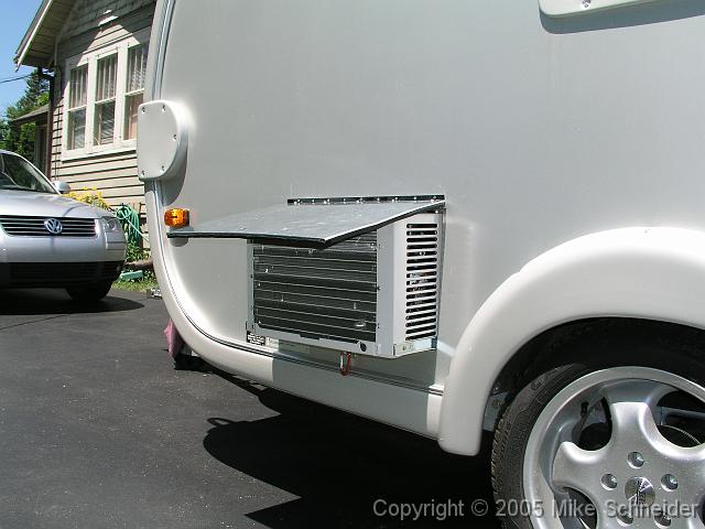

Postby mikeschn » Sun Jul 26, 2009 2:09 pm
If I had it to do over again, I'd mount it in the side, like I did on my t@b, just higher up on the side wall...
Here's a pic...
More pics here...
