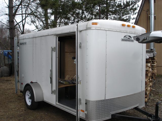

Like some others I want to be able to use my trailer for hauling quads bikes what have you. As well as camp at dog shows in comfort.
6x12 RoadMaster, barn doors with side door.

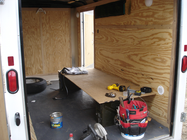

Bunk
Postby BDR » Tue Apr 14, 2009 8:35 pm
We got the fold away bunk which is nothing more than plywood and a piano hinge.
Folds flat out of the way with 2 sliding draw bolt locks. Sits on top of 3 20MM ammo cans, they are the perfect height for me, to sit evenly. They also happen to be air tight, water tight (yes they have rubber gaskets) raccoon proof almost indestructible and cheap. Plus they give clearance for my cooler, Big buddy heater, and lots of other storage.

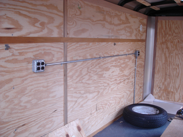

Electric
Postby BDR » Tue Apr 14, 2009 8:42 pm
You need more plugs than this stay at home:o .
Wire drops out of the down feed conduit to plug into gen or shore power.
(All I really need is battery charging which I can do in the van, it has a big inverter)

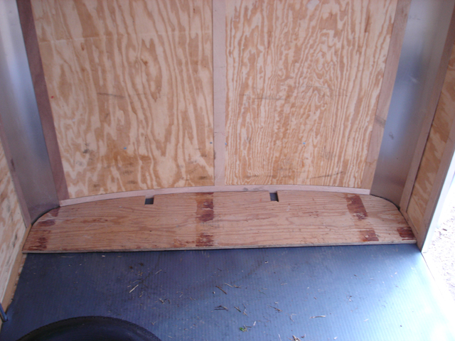

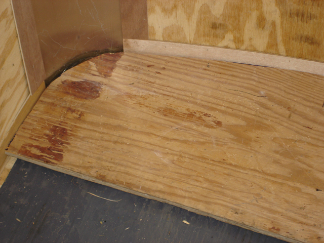

Front shelve
Postby BDR » Tue Apr 14, 2009 9:09 pm

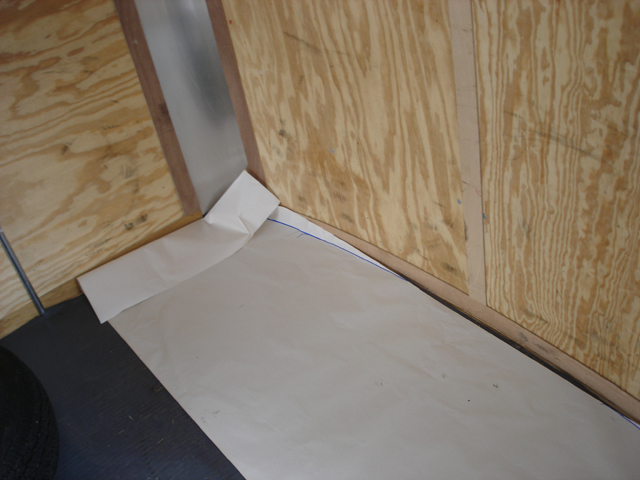

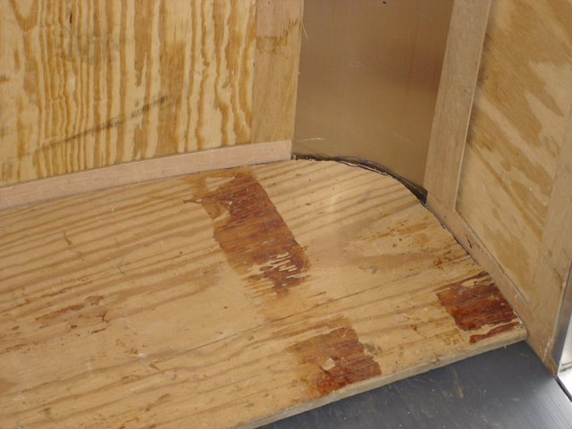

The front has a round nose and I wanted a removable shelve/laptop desk
I saw the folks with the flying monkeys, spare tire mount and liked that idea, so I figured that it would bolt through section of 4x4 that I would, mold with a belt sander to the contour.
To the sides of that I would mount a couple vertical 2x4 sections to lock the shelve in place,. A couple more cleats at the out side corners same level as the 4x4 and you have a unit that may need a rubber mallet to assemble and take down.
paper temp (yes I kept it)
left
right
full shelve

Postby devigata » Wed Apr 15, 2009 1:27 am
You're off to a great start! Those rounded corners are a force to be reckoned with, aren't they? I'll tell John you liked his idea.
Why are you using 4X4's?

Postby BDR » Wed Apr 15, 2009 9:40 am
devigata wrote:You're off to a great start! Those rounded corners are a force to be reckoned with, aren't they? I'll tell John you liked his idea.
By the time I sand it down for the contour, it will be more like a 2x4 on the outside edges. I want to have enough remain for a solid mount for my vertical uprights.

Postby devigata » Thu Apr 16, 2009 4:14 am
Okay, I get it.
John just screwed cleats into the wall and screwed the shelves onto them. Of course, ours are permanent.
You really are off to a good start.

second trip
Postby BDR » Tue May 19, 2009 3:43 am
Just made my second dog show weekend trip in the trailer. It really is a joy just pulling out the camp stove, making coffee + hot breakfast in 5 minutes, watching everyone run. They have been up since 2-3 am to get to the place and get ready, run run run, I'm here to relax not get stressed :? , and the trailer makes it so much easier.
I pull in the night before, set up go scout a fishing hole I've google earthed before leaving home, come back feed the dogs and sleep like a 12 year old at camp:thumbsup:
Not much has changed (been really busy or fishin, ain't that the same thing?)
Have added multiple tie down points, I think a window or two maybe the next project, so I can see the dogs without opening the door (not that anyone is going to bother them they are American Bulldogs)
I still have total use of the trailer for hauling.
