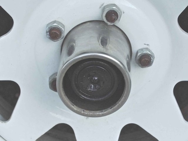

Not Sure What I've Got
Postby d30gaijin » Tue Jun 14, 2011 1:18 pm
Now I'm not sure what type hub I have. I thought it was a E-Z lube but maybe not. Below is a pic. Maybe someone with more knowledge than me can help identify what I've got.
Thanks,
Don
d30gaijin
Titanium Donating Member
Posts: 594
Images: 139
Joined: Sat Jun 12, 2010 9:27 pm
Location: Boise, Idaho
Postby vtx1029 » Tue Jun 14, 2011 1:41 pm
Yep it looks like an ez lube. Pop the rubber cap and there should be a zerk behind it.

Postby d30gaijin » Tue Jun 14, 2011 4:30 pm
vtx1029 wrote:Yep it looks like an ez lube. Pop the rubber cap and there should be a zerk behind it.

Postby GPW » Wed Jun 15, 2011 6:41 am
Sorry MJ, here they call all things like that BBs... you know how we are .. we tend to generalize too much :oops: So when we shop, what do we look for ??? Is EZLube a brand name or is it the physical construction ... ???
Postby madjack » Wed Jun 15, 2011 8:00 am
EZ-Lube is a patented system which allows grease from a zerk fitting to FLOW THRU the spindle into the inner bearing(and thus to the outer)...BB's are spring loaded grease caps with witha zerk fitting which sends grease into the outer areas of a hub and if your LUCKY, the spring loading will push A LITTLE grease onto the outer surface of the outer bearing...which is why they are so despised by those in the know!!!!!
madjack 8)
Posts: 15128
Postby madjack » Wed Jun 15, 2011 8:03 am
...if the zerk fitting goes directly into the spindle, it is an EZ-Lube, if the zerk pumps grease directly into the grease cap, it is a Bearing Buddy............
madjack 8)
Posts: 15128
Postby madjack » Wed Jun 15, 2011 8:10 am
...witha Bearing Buddy, if you over grease, you face the VERY real possibility of blowing out the rear seal, with EZ-Lube, excess grease simply comes out the front of the hub, in essence, repacking the bearings...both front/back(inner/outer).........
madjack 8)
Posts: 15128
Postby GPW » Wed Jun 15, 2011 8:47 am
OH COOL !!!! Thanks for that info MJ !!!! Was always confused about that ... Now we know what to look for ...
