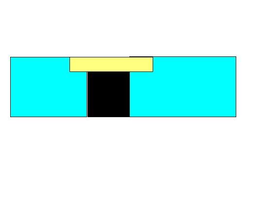

Third: I was thinking of using 1 1/2" insulation, trimming the edges and using 4 inch wide strips of wood, screwed onto the frame in order to avoid heat transfer kinda like this: http://i273.photobucket.com/albums/jj20 ... onidea.jpg
Black is the 1" steel frame, blue is the insulation and yellow is the wood strip... what are your ideas on this?

Postby sed8ed » Fri Jul 08, 2011 1:13 am
OverTheTop - I actually have read your blog and that's where I got the idea for using 1 1/2 insulation and strapping 7/16 OSB on top of the studs (frame members) to both anchor the insulation in place (while giving me another wider surface to nail the luan to) and to create a barrier between the metal and the interior of the trailer.

Postby OverTheTopCargoTrailer » Fri Jul 08, 2011 9:44 am
Hi Sed8ed
The trick, the whole trick and nothing but the trick is, you said it !!!!
is to create a 2nd barrier between the metal and the interior of the trailer, so that the hot or cold steel studs can't transfer the heat.
Don't worry about this or that insulation R4 - R5 does not matter....
(the heat is transferred by the metal studs - RV's are built out of wood)

The metal studs transfer heat, But the insulation still does quite a lot. Honestly I don't think campers are built from wood with climate control in mind.. They do it cause of cost. Wood is much cheaper and easier to build with. Insulate the walls best you can and but a decent layer between the metal and the living space. My ceiling has 1/2 strips on the studs with 1/2 foam in the gaps. But my walls just has 3/8ply with 1/4 paneling on top of that. That little bit of wood on the studs does help. On hot sunny days the walls don't feel any warmer then the air temp. I can heat my trailer with a 15 dollar bathroom heater and I can cool it with 9200Btu AC. Considering its 7x24 thats pretty good. Its always a trade off with insulation. Thats why our houses only have R13 or R19. R30 would be better but probably not worth the cost for the gain.
