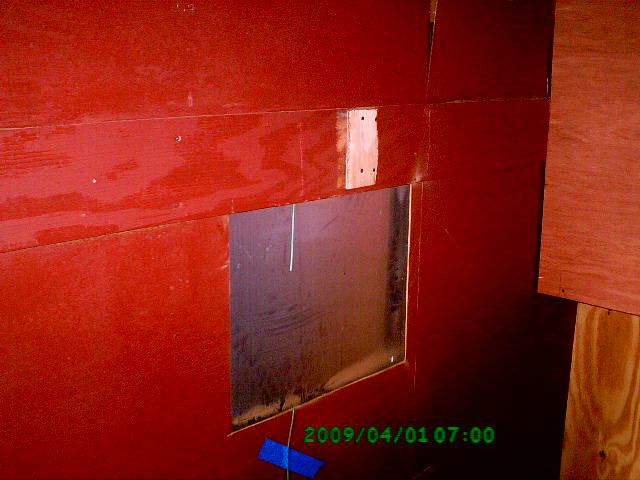

Postby devigata » Mon May 25, 2009 3:45 am
dunediver wrote:What all do you guys use as for the actual window install? plasma cutter? what did you guys use?
After marking out the location of the windows, John just used a jig saw on the inside luan wall and the 4" grinder with a cutting wheel on the outside aluminum wall. He reinforced with (I think) 2X2's, sealed with silicone and screwed it in. Sorry I don't have detailed pics, I was at work when he did it.

Postby Prem » Mon May 25, 2009 11:19 am
WINDOW CUT-OUTS:
You mark the cut-out for your window on the exterior skin of the trailer in the exact spot you want to install it, making sure that you aren't going to be cutting through any electrical wires to your taillights. You drill a 3/8th inch hole anywhere on the INSIDE of the line. You put a metal cutting blade in a jigsaw. It's 3/8th of an inch wide. Insert in hole and cut along your line. If you are cutting through an upright piece of thick metal, you switch to a reciprocating saw with a metal blade just for that cut because a jig saw cuts finer and is more controllable than a reciprocating saw. (Staying perfectly perpendicular is hard with a reciprocating saw.)
No plasma cutter needed. :SG
Hope that helps.

Postby dunediver » Mon May 25, 2009 10:53 pm
PREM, I was leaning towards the metal blade the jigsaw..And then just running some caulking around the window real well for sealing reasons.. As far as the side bracing is this needed?

Postby bobhenry » Mon May 25, 2009 11:59 pm
Prem wrote:WINDOW CUT-OUTS:
Hope that helps.
Prem
A metal cutting blade in a circular saw is quicker and easier to keep straight. The plunge cuts needs to be slow and deliberate but it would be my tool of choice !
Re: Window cut-outs
Postby Prem » Tue May 26, 2009 12:22 am
Bobhenry,
Drop cut with a circular saw? :shock: You're a braver fellow than I.
I had to use a jigsaw on my window cut-outs because the windows have radius corners.
I also put masking tape on the "table" of my jigsaw so that I would not scratch or mar the white paint on the aluminum skin of the trailer, which is easy to do. Worked great.

Postby edcasey » Tue May 26, 2009 10:08 pm
To answer one of your previous question, I always add a full frame when adding a window, roof air conditioner, entry door, refer vent door.... With a new unit it's very easy to remove the luan, cut out any wall supports that are in the way and weld in a steel frame. You said your are a fabricator so I'm assuming that includes simple metal work. As far as what tool to use to cut the sheet metal, there are several good choices but I use the same tool we use when replacing sheet metal on campers which is a router with a flush cut bit with ball bearing. All you do is drill one hole in the sheet metal and insert the bit. Start the router and move the bit until it hits the window frame. The ball bearing will ride along the window frame making a perfect cut that takes less than 30 seconds on a medium size window.
