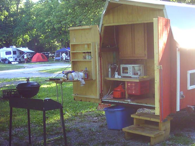

Postby bobhenry » Mon Jul 27, 2009 11:21 am
Here is what is on that trailer now !
The galley is in with 8 screws and easily removable then I have a cargo 4'11" wide by 10' inside. Hell we can move in the rain.
I had dreamed of a flat bed , cargo , teardrop combo using different bed units but by the time you embleish the tear with electrics and tow lighting it gets more and more difficult to remove the " BOX " not to mention it gets heavier and heavier so I went this way for my all purpose combo trailer.
Slightly taller sides and a different profile roof to accomidate the boat and you got it all.
UNLESS YOU HAVE TO MOVE THE REFRIGERATOR :x
