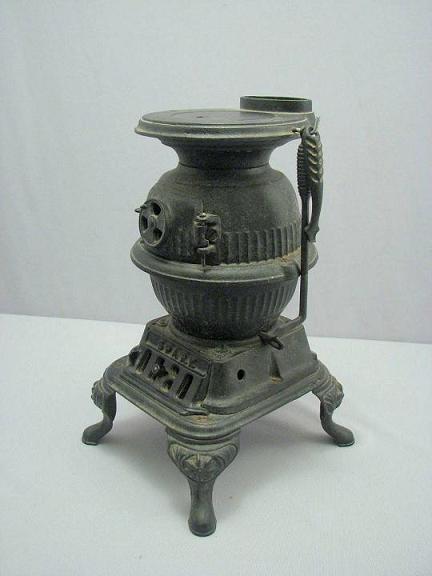

Postby bobhenry » Sat Oct 17, 2009 1:27 am
Ageless wrote:catalytic tent heater says it all; combustion creates water
A furnace as shown; vents that water outside and heats the interior air.
Now where did I store that little cast iron woodstove?
Mine is on the front porch :thumbsup:

Postby hunter535 » Sun Oct 18, 2009 7:14 pm
Bobhenry,
Does that stove put off enough heat to keep you warm in the winter? Looks like you may be up every hour stoking it up! Or maybe every 1/2 hour?
Interesting though. :thinking:

Postby Ageless » Sun Oct 18, 2009 8:29 pm
Hunter; it's cast iron. You don't need a 'HUGE' fire. If ya know how to 'bank' a fire; it will still be giving off heat 8 hours later

Postby bobhenry » Mon Oct 19, 2009 3:42 am
hunter535 wrote: Does that stove put off enough heat to keep you warm in the winter? Looks like you may be up every hour stoking it up! Or maybe every 1/2 hour?
Logs are small 3-4 " but it will hold several and it took the trailer from 28 degrees to 76 in 12 minutes from a cold start at the 08 shivaree.
Those results amazed even me and I have had wood heat since the oil embargo of 78.
Cycle time was about every 3 hours I am up and down that often with an electric heater turning it off and on to keep from getting too warm.
