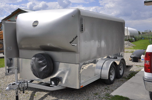

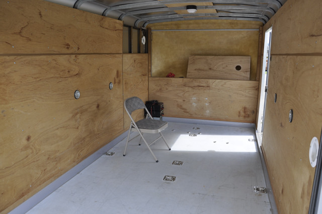

Here's a photo of our trailer, a 7X12 Wells Cargo Cycle Wagon:

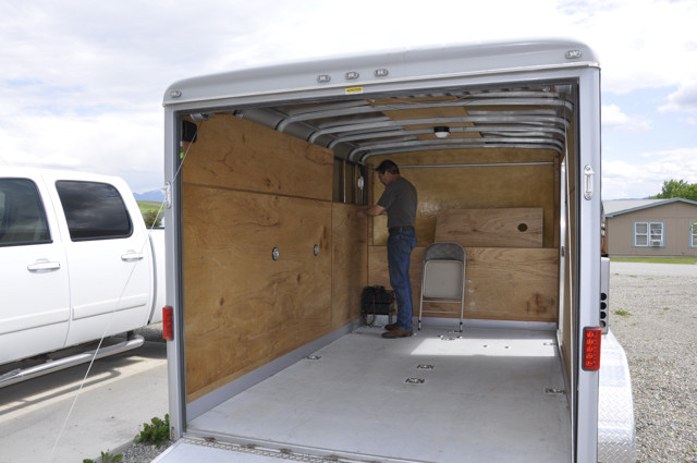

A look at the inside...
And just to commemorate the build, here I am removing the first of what looks to be hundreds of screws!

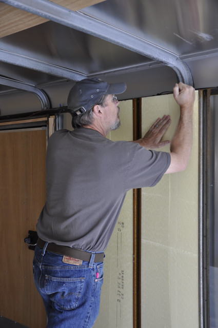

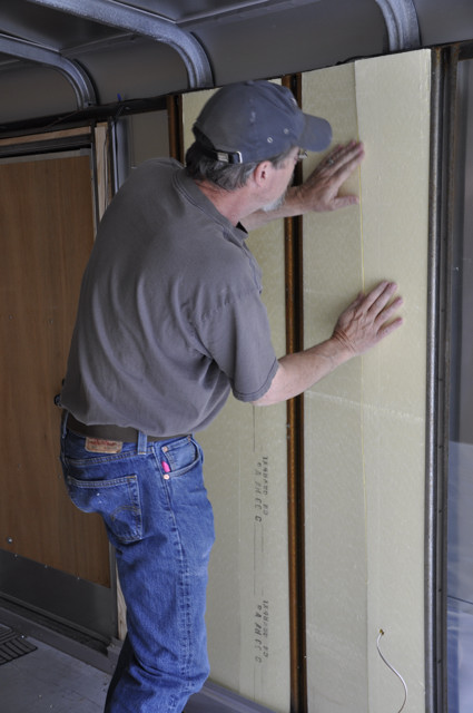

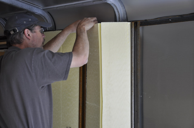

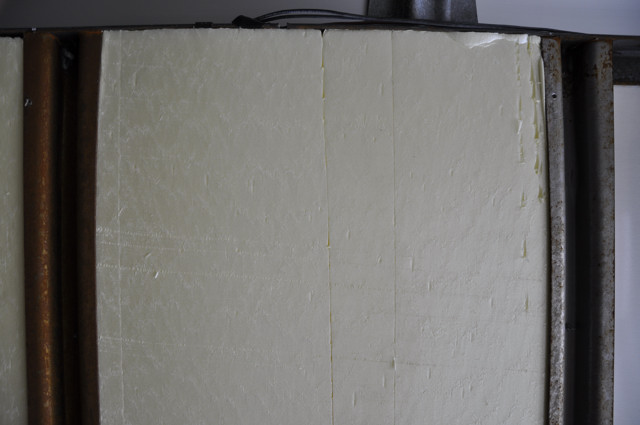

Here's the process I used to get the insulation in to the T-frame of the Well's Cargo.
First I cut the board to the width of the space behind the flange so that it will slide behind the flange. Then I cut the board down the center, but not all the way through, just enough to get it to break but leave the skin intact on one side. From there I install as follows:
Putting the board into the area with it folded out to fit between the flanges.
The as I press the fold back in place it slides behind the flange to fill the entire space.
Final fitting with the ol' hammer fist technique.
And here it is installed.
The last photo looks a little curved because I used a wide angle lens to get a closer photo...
The cut I made in the center has closed tightly so I don't believe it'll need any tape but I may put some on just to make sure although I am thinking of adding a vapor barrier anyway so it probably won't be necessary.
Hope this helped.
