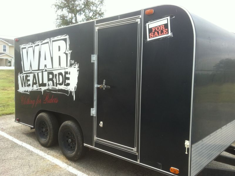

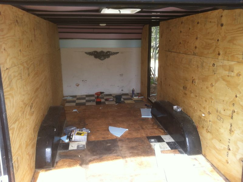

Hello, new to the forum here and wanted to let you know what we are doing and maybe get some advice. My wife is a massage therapist and we go to bike rallies where she wanted to set up shop. We found a used 7x14 trailer and we are going to convert it so she can do massages in it and we could camp in it. We bought the trailer Friday the 15th, and have to have it ready for use on the 25th, so we are in a little bit of a time crunch right now. I have read through several post here and gotten some good ideas so here goes.
We started by pulling up the vinyl tile squares so we could put down a padded floor. We think we are going to go with those puzzle piece foam tiles you can get at lowes. I took down all of the luan board that was on the inside walls and put foam insulation sheets throughout the walls and ceiling. I then put up 3/8 plywood for a little more sturdiness.
We bought some E tracks for the walls to put up bunk beds like I saw somewhere on this site. We bought a fold out RV step which I will install tomorrow and a RV style door handle. We ordered some indoor outdoor carpet for the walls for a little more sound proofing. We have not decided if we are going to buy cabinets for the front end of the trailer or build some so we can customize them the way we like. I like the one that Don and Christi built on here. We are going to go with a portable room air conditioner to start with but may add roof top air later. This is what it looked like when we bought it, we are still scraping off the stickers.ImageImageImage

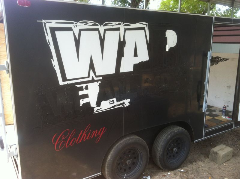

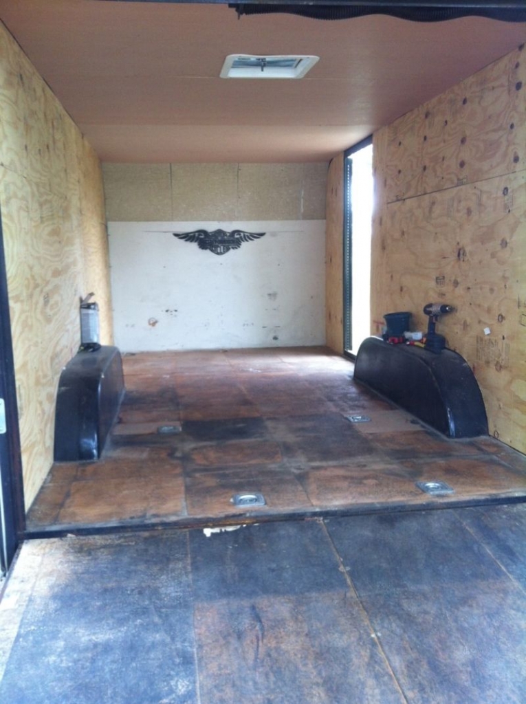

A couple more pictures, it does not look like we got much done but it is June in Texas so you have to work for an hour, drink a gallon of water, rest for 30 minutes then get back to work. That and I am not as young as I use to be.

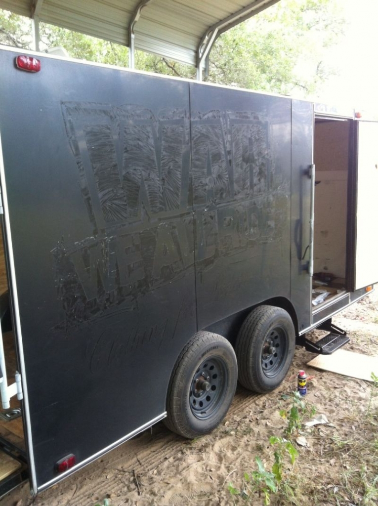

The stickers are a PIA to get off, we have been using razor blades to get them started then peel about an inch before they break and we have to start again.

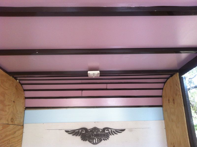

The inside walls are done, I kept the one in front because of the HD image.
The pink insulation is R4, the blue is R3.

Postby Pyrofish » Mon Jun 18, 2012 4:38 pm
Welcome to the forum! Lots of good info on here :beer:
Those stickers will come off alot easier with a heat gun, or a hair dryer. I took off the landscaping decals on a 20 trailer like that. Both sides, one day. It still took a while, but it was MUCH easier. One tip that I didn't get to try was using a block of wood with the heat. The heat softens the paint, and I was using a metal scraper, which left gouges that needed repair. I hear the wood doesn't do that, ymmv. :thumbsup:

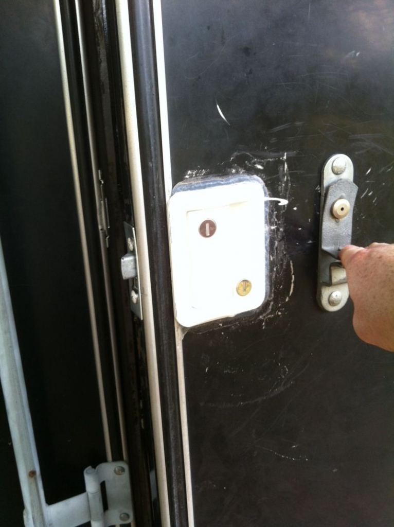

Postby Smiddyt » Tue Jun 19, 2012 7:25 pm

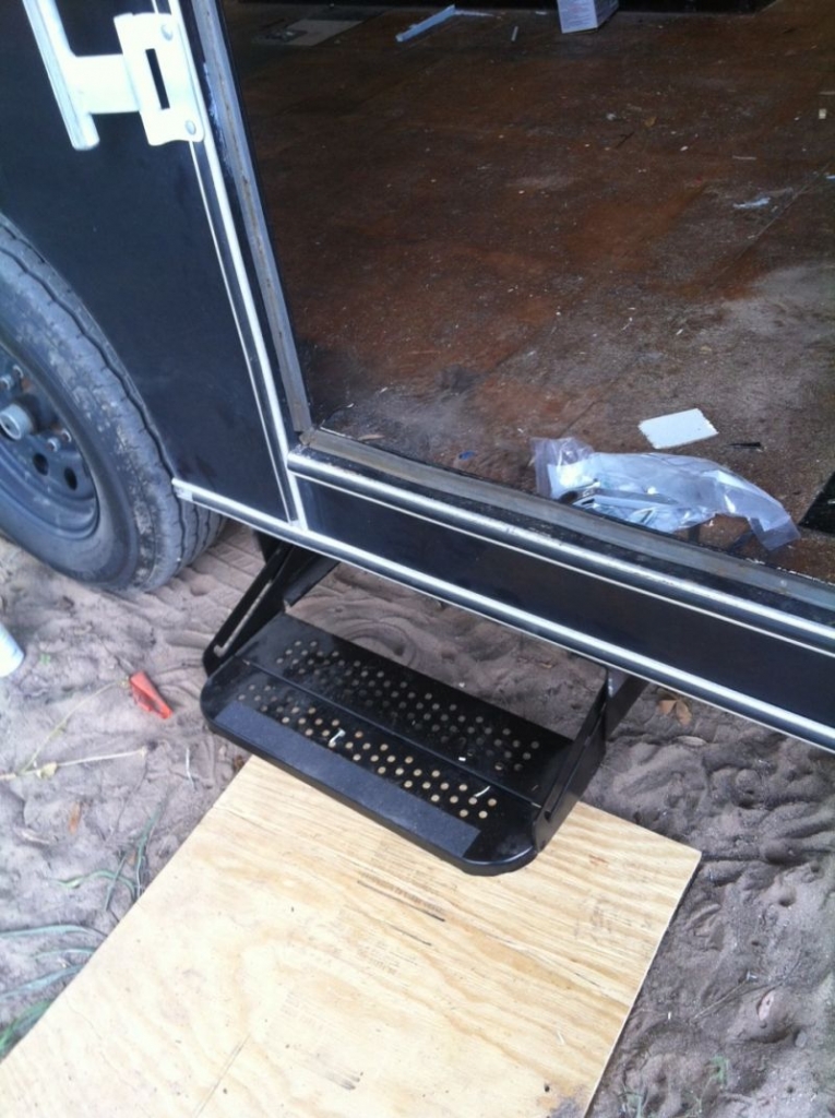

Today I put the RV style door handle in and my wife worked on scraping stickers. The hair dryer idea was a good one, thanks. We then went to find someone who could weld a piece of plate metal under the door to bolt the steps to. I have a wire feed welder but all I can do is mud dob so my wife said we needed to find a professional. That was difficult to do and took us several hours, most thought the job was too small to deal with or wanted me to leave the trailer until they got time. Finally found a guy who did it for $20. Went in town to get the luan board for the ceiling and foam tiles for the floor. will probably install that tomorrow. I could go back to work but I dont want to :D

Postby Smiddyt » Wed Jun 20, 2012 2:47 pm
The stickers are off, still got to get rid of the glue though.
The step is on
The door handle is on, I scratched a paint a little but we plan on painting the whole thing white in the near future

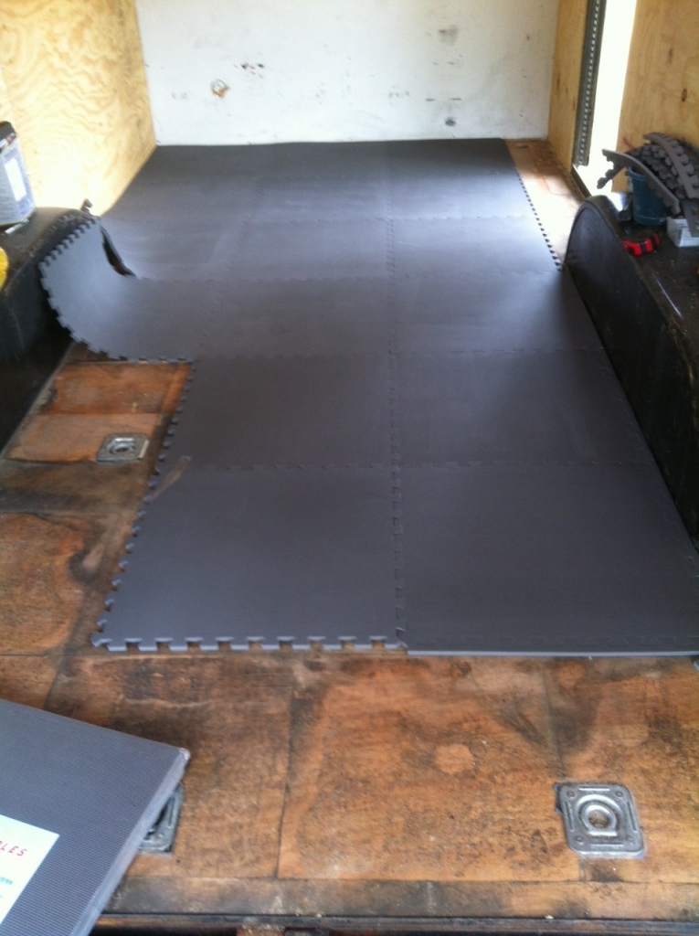

Started putting down the flooring

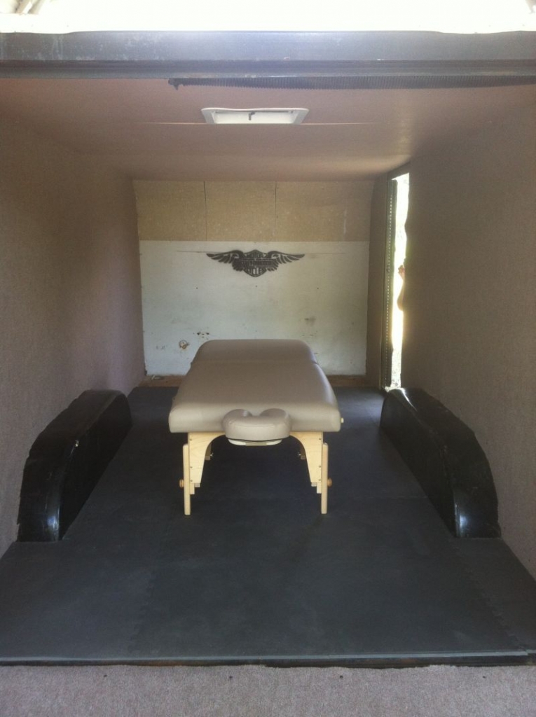

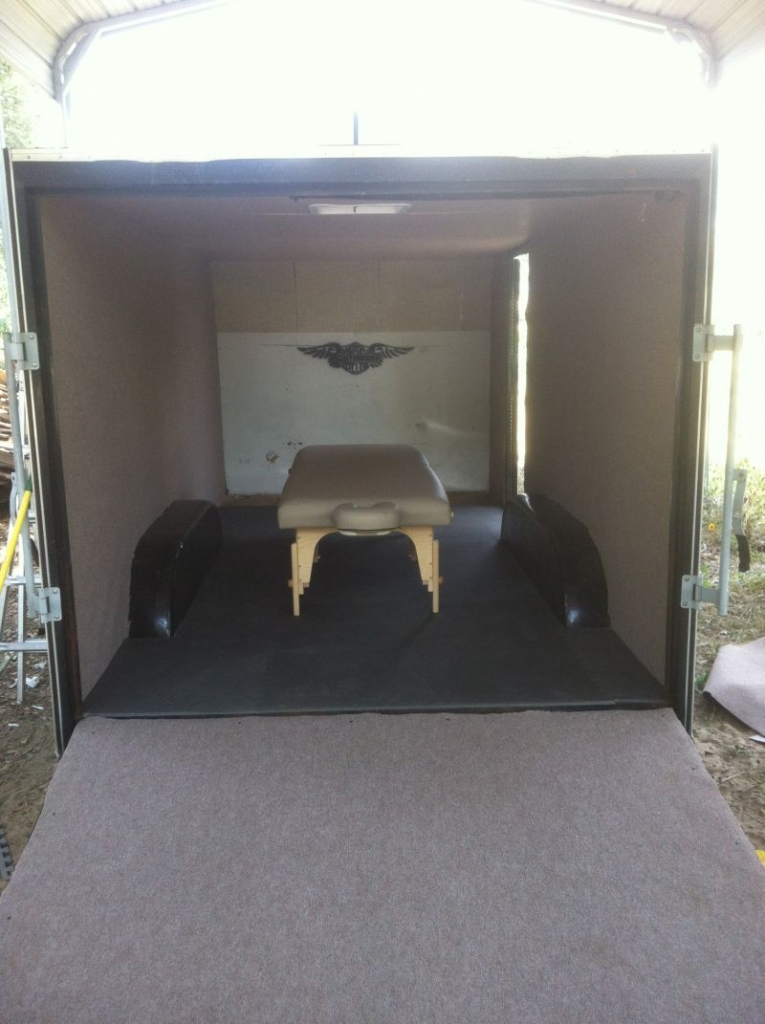

Postby Smiddyt » Fri Jun 22, 2012 12:52 pm
Well got the floor done, and the carpet on the walls and back. I have hung 2 of the Etrack rails
Closer shot
Now it is off to lowes to get the air conditioner and some lumber to start building the cabinets.
