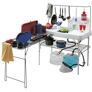

In the next phase of conversion (In reading everyone's posts, and personal experience, I am finding that everything is like Ivory Soap- 99.4% done), I plan on setting up one of the propane on-demand heaters for doing dishes and providing hot water to my exterior kitchen sink setup Image. It seems that 4 people can generate a lot of dirty dishes. :( I am going to basically use a "Y" hose to split out the single garden hose supply to provide cold water and feed the heater for the hot, with connections to a high-neck faucet. A portable tank for collecting the grey water.
