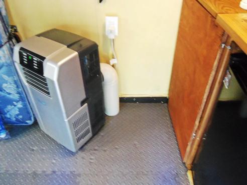

I know you said yours is not a toy hauler.. But even if mine wasn't I still would have done the floor the same way.. Its all one piece rubber raised coin mat.. All water proof, tuff and easy to clean.. It also adds a bit of padding and absorbs sound some. Once we pull our RZRs out we have two indoor outdoor rugs we lay out.. I think I paid 10 bucks each for them.. I want to say they are 7x9 or something like that.. The cover pretty much the entire floor but are very light.. When they get dirty I lay them out on the driveway and spray them off with a water hose.. It works well for us..
Here is how I clean the trailer
Heres what it looks like..

Postby 8ball_99 » Sun Oct 14, 2012 8:17 am
You seem to want a padded floor? We don't really walk around in the trailer barefoot very much. We get up and dressed pretty early. Sorta of the same thing, once we get undressed we are straight to bed..
If you really want padding though why not do like most people do at home. Either wear house shoes or adde rugs. We live out in the country so pretty much our entire home is either hardwood or tile. We have thick padded rugs in places like the bedroom or living room, one in front of the kitchen sink, ect. You could still do a sealed floor like linoleum or that rubber coin mat, but Instead of the thin indoor outdoor rug like I said earlier you could get a padded rug for your main walk way.
