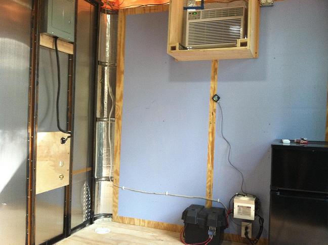

Here's the fuse box and the 12v system. Looks kinda rough but will be all hidden when the cabinets are complete.
Front Wall wiring.jpg (54.04 KiB) Viewed 3084 times

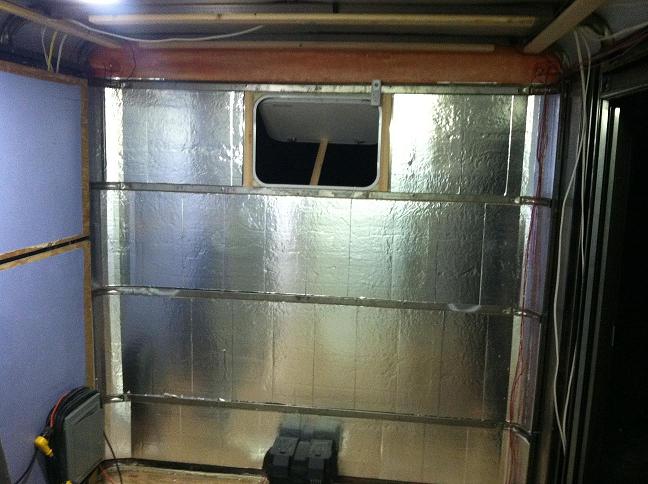

Used a straightedge and a razor knife. Scored the insulation every inch for seven inches. Let me follow the contours on the trailer.

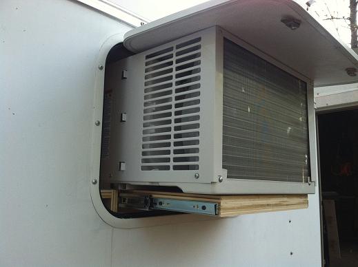

This is the AC installed. Gonna pull it back out and adjust the mount a little. I have room to drop it another 3/4 of an inch to give the door a little more slope to shed water. Also going to waterproof all the exposed wood.

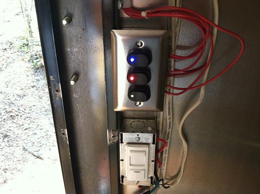

Here's the switch plate for the 12v outside lights, inside lights, and vent fan.

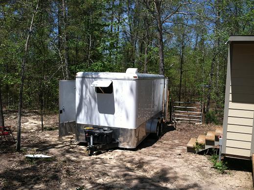

Here's a shot of the trailer. Need to finish cleaning it up.
