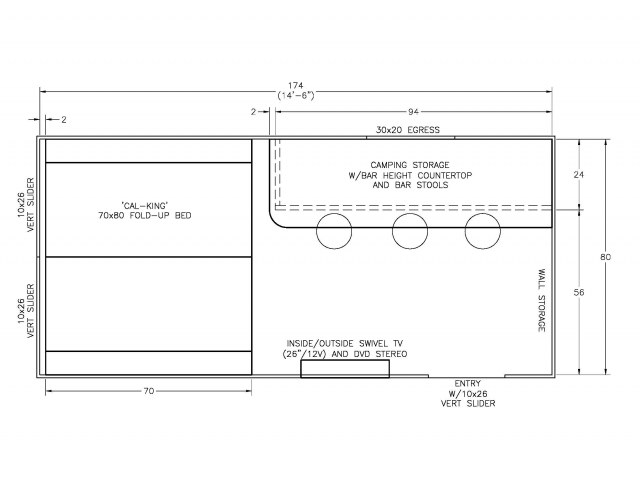

Hi y'all. Finally found a cargo that 'should' work for me...ha ha, guess we'll see when it's done. Lotta great ideas on here. Kinda wish the board was even more active as my brain has been like a sponge soaking up the ideas. Anyway my background is in the RV industry for the past 24 years. I have built them and designed them. Currently I am the CAD manager/Lead drafter for my company so this build will be easy for me albeit my first cargo conversion. My approach is going to be be very minimalistic. Going to haul up to two quads with a large fold down bed, cabinet for storing the regular camping gear with a bar like counter top to eat at and prep/cook when the weather is crap. I still prefer my camping experience to be 'outdoors' so my interior will only be the basics...no toilet/shower, no holding tanks, no 120 volt. Power will be 12v only with 6v batteries and solar charging. My kinda camping is pretty remote with no hook-ups. Here is the basic floor plan (more pics to come)...

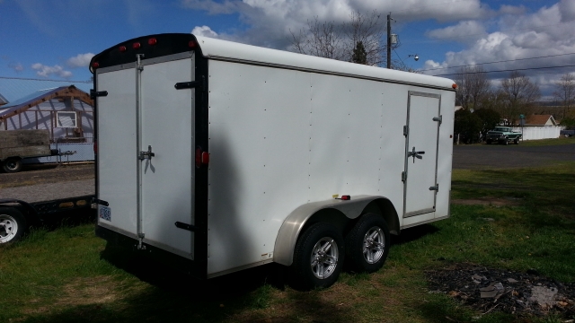

Postby Quadriderdad » Sat May 18, 2013 5:09 pm

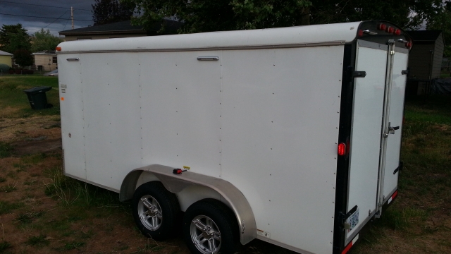

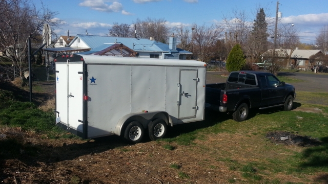

The day I brought it home...
...I hate the way the sheetmetal is so wavy on some of these. I'm hoping once I get it insulated and put the panels up inside that it won't be quite so bad.

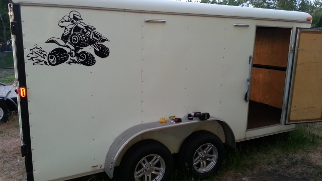

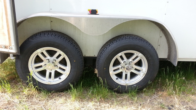

Let the fun (work)...lol, begin.
Started removing some of the factory decals. Man those are a pain in the butt!
Put on new wheels and tires from product we build at work...
Yeah!...look better already! :D

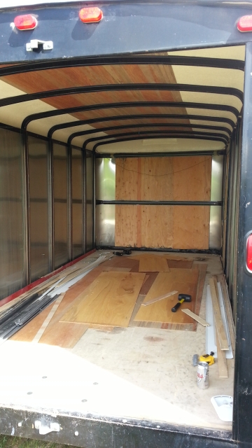

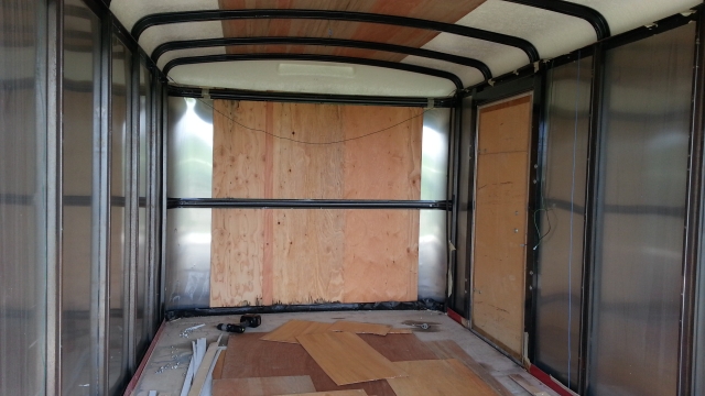

Interior gutted and ready to do the floor...

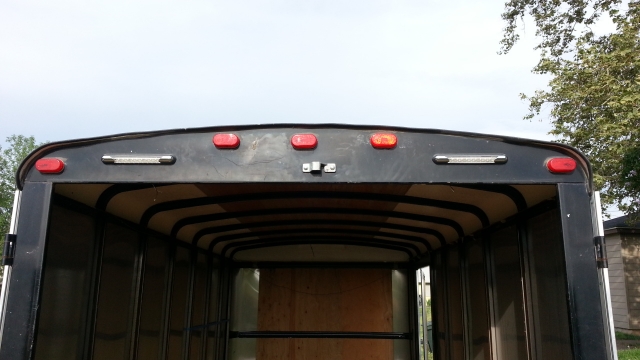

Exterior lighting done. All LED. Still thinking about adding one to the front over the battery area.

Nice lights. Are those 12v white led lights? Are they all on one switch?
Rainier70
Posts: 1083
Images: 244
Location: Southeast Idaho
Re: Quadriderdad's 7x14 toyhauler
Postby Quadriderdad » Sun May 19, 2013 6:33 pm
Rainier70 wrote:Nice lights. Are those 12v white led lights? Are they all on one switch?
They're kind of a bright white with a bluish color to them. I don't have them wired yet but each side is gonna be on a separate switch. :)
...yes 12 volt.

Postby Rainier70 » Mon May 20, 2013 7:37 am
That will be nice. Do you mind posting where you got them? Thanks!
Rainier70
Posts: 1083
Images: 244
Postby Quadriderdad » Mon May 20, 2013 10:51 am
Rainier70 wrote:That will be nice. Do you mind posting where you got them? Thanks!
Sure...this is the company that we get them from...
http://www.optronicsinc.com/pdfs/Sell_Sheet_ILL70_71AWN.pdf
Convenient for me since we get them by the case :D The ones I'm using are the 9".

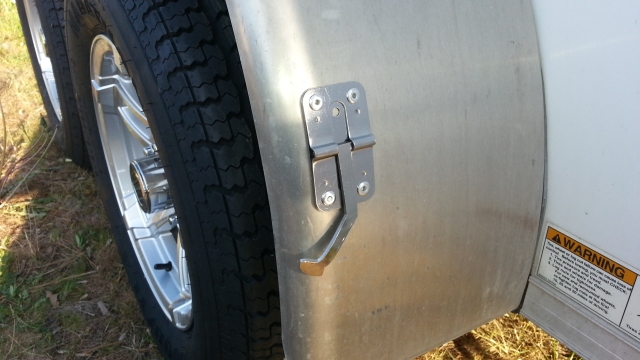

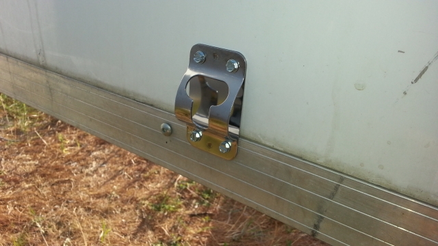

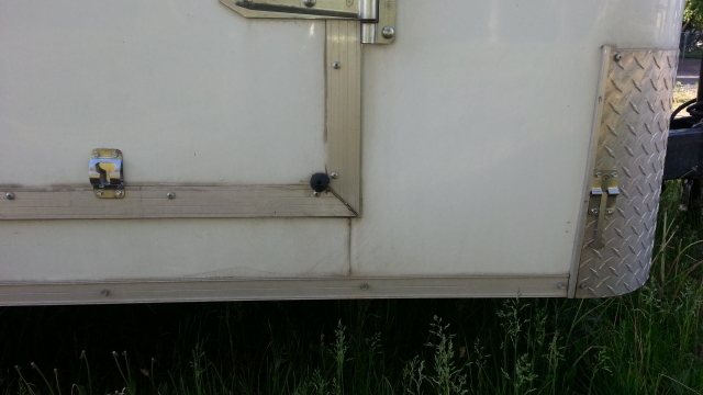

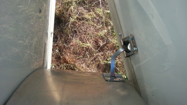

Postby Quadriderdad » Wed May 22, 2013 2:08 pm
Door catches installed at each door...

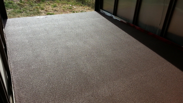

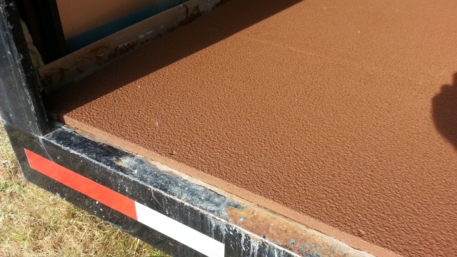

Postby Quadriderdad » Sun May 26, 2013 9:02 pm

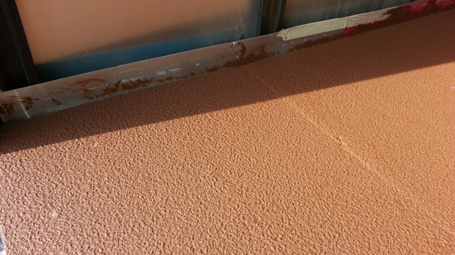

Got the floor done. It's a product called 'Restore' made for decks and concrete patios. Seems pretty tuff but not super flexible. I have a feeling it will crack at the decking seams as the trailer flexes.....guess we'll see how it holds up.
Postby roadinspector » Sun May 26, 2013 9:40 pm
Quadriderdad wrote:Got the floor done. It's a product called 'Restore' made for decks and concrete patios. Seems pretty tuff but not super flexible. I have a feeling it will crack at the decking seams as the trailer flexes.....guess we'll see how it holds up.
Quadriderdad,
I like the looks of your floor. :thumbsup: Do you know if Restore is oil/gas/chemical resistant?
Earnest
roadinspector
Posts: 599
Images: 127
Location: Texas
Postby Quadriderdad » Mon May 27, 2013 11:37 am
I'm not sure if the deck restore is oil and gas resistant. They do make a product called 'Extreme Concrete' that is. I'm kinda having buyers remorse wishing I'd got it instead but to late now. My quads don't leak oil so I think I'm ok there.
