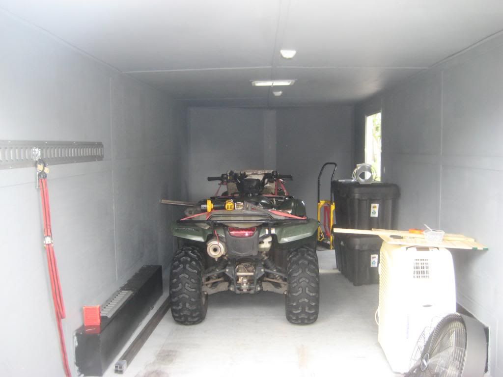

Below is a picture of the new to me 20'X8'X6'6"2010 V nose trailer.
I want to keep track of everything and post lots of pics to hopefully get some feedback and ideas from you guys
This is what Ive done so far

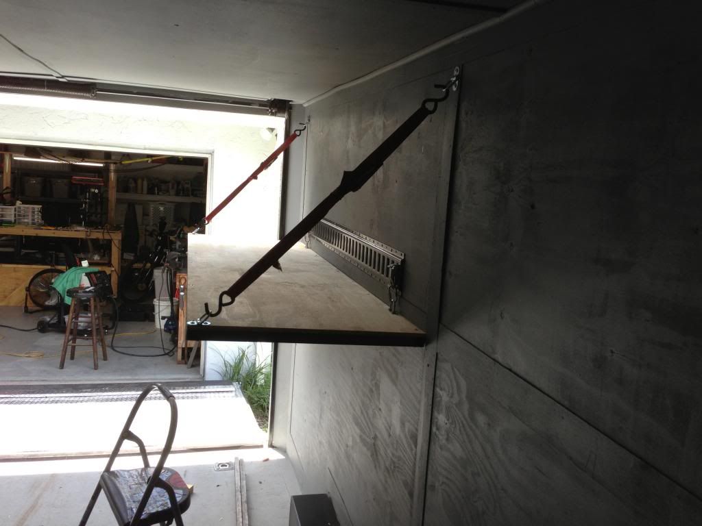

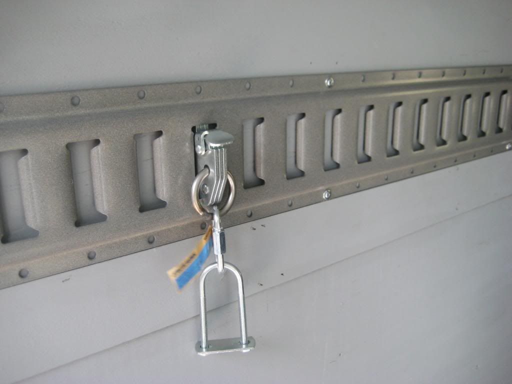

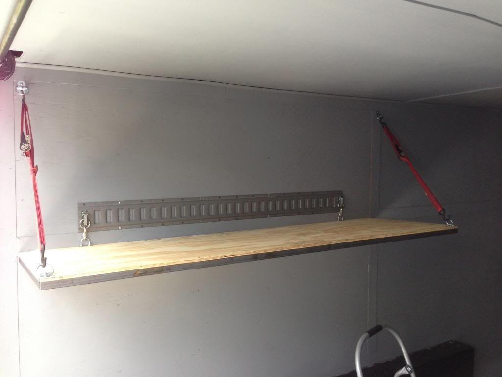

Installed some E track to attach removable bunks

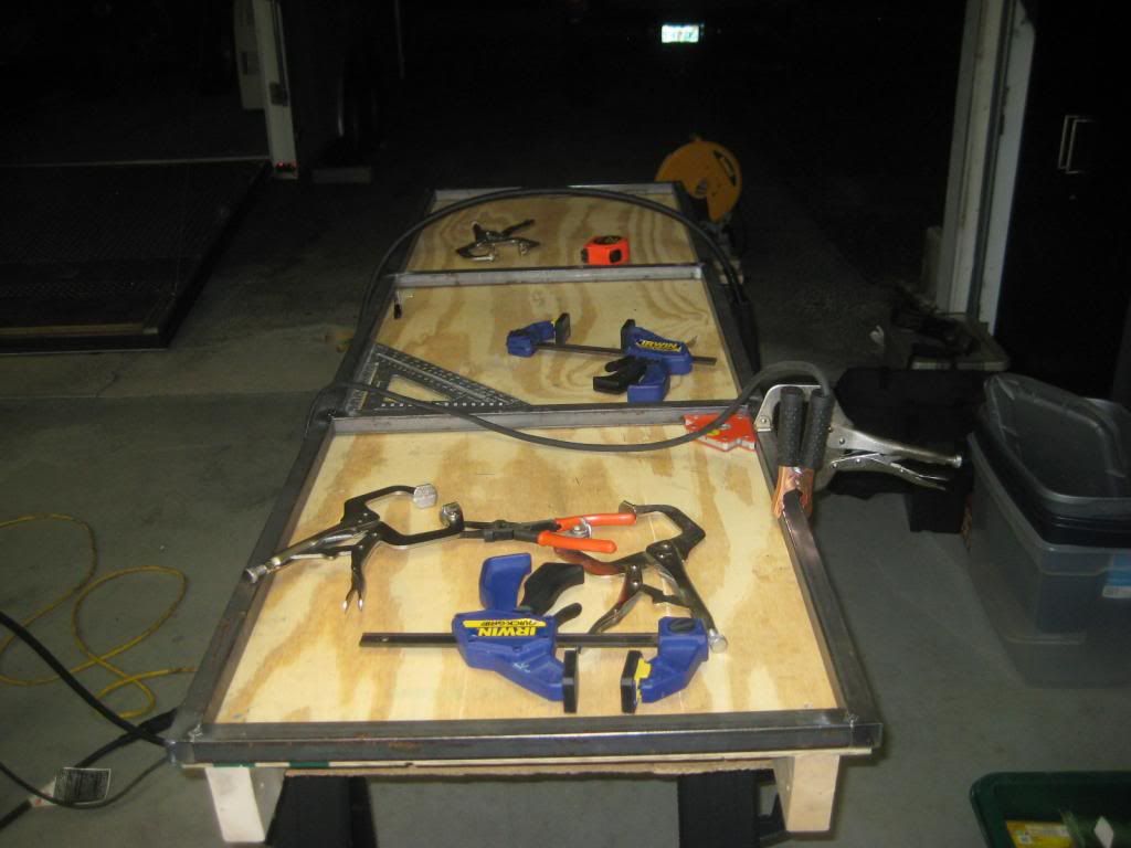

Welded up some folding bunks

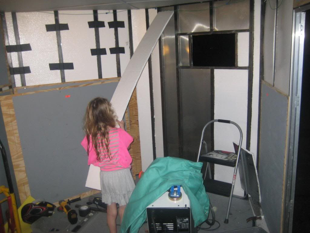

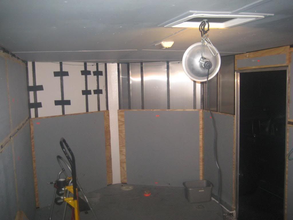

took down the paneling and added foam board insulation
My son helping me

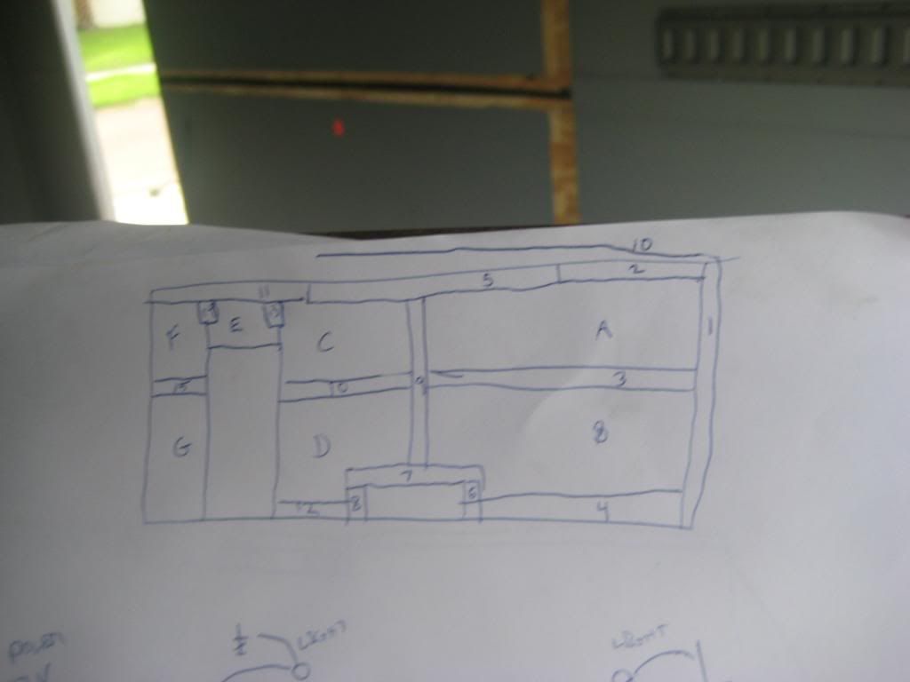

We labeled all the panels and trim pieces with tape and made a fancy cheat sheet for each wall so we could figure out how to put it all back together

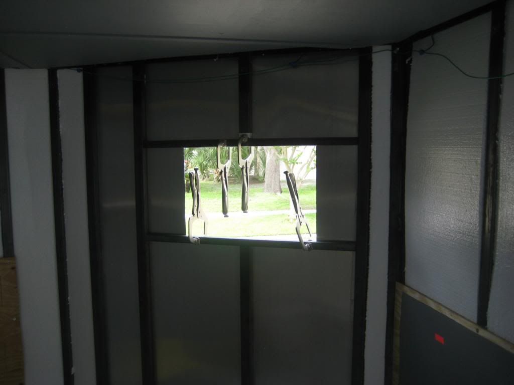

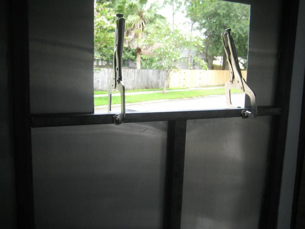

I got all the insulation done yesterday. Today Im cutting out holes for my window unit, vents, and my 14"X22" vertical sliding windows that just came in the mail yesterday!!! I am really nervous about cutting holes in the trailer. We'll see how it goes. If you guys have any tips on how to do this I sure would appreciate it. the skin is thin sheet metal, studs are 1" thick square tube, and interior ply is 3/8th.

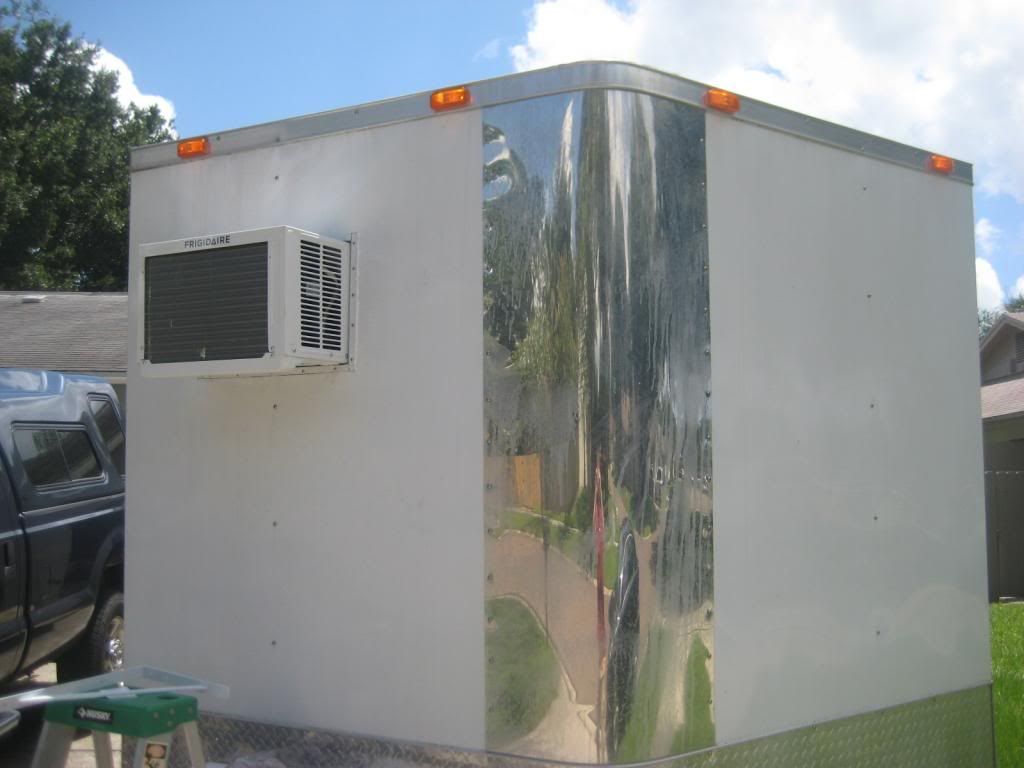

installed A/C unit, lots of pictures
Postby Brian556 » Wed Jul 24, 2013 7:18 am

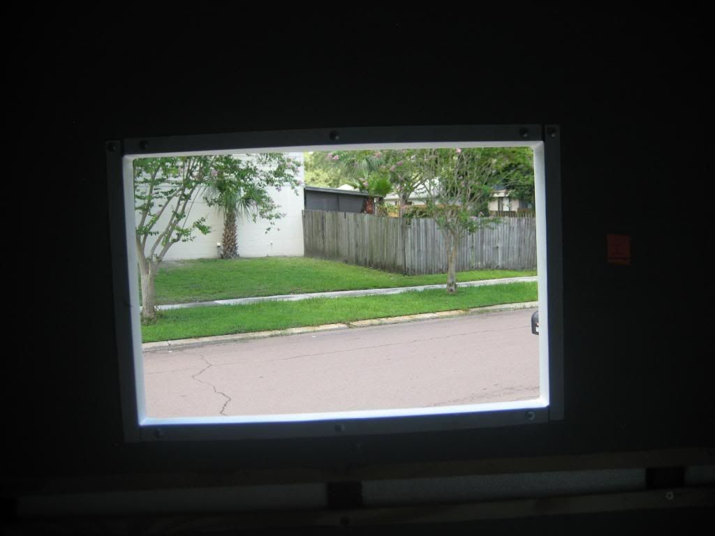

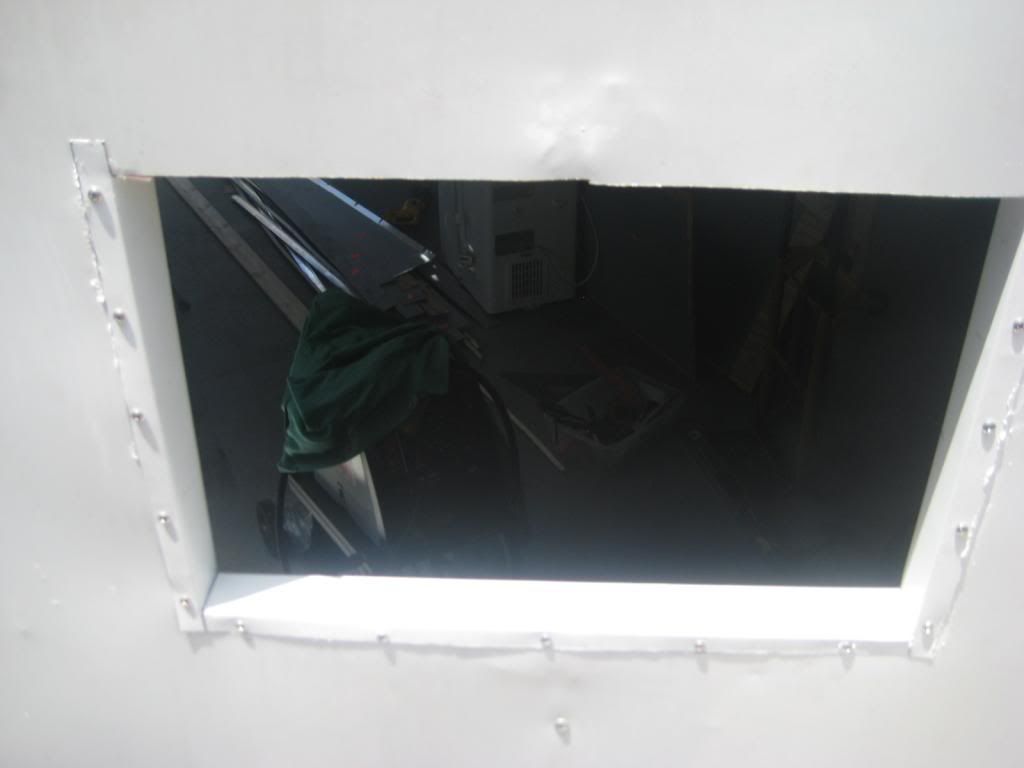

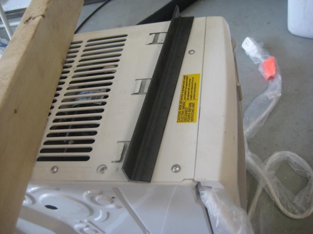

Well Ive been hard at it the last couple days and even though Im running out of time before our 3 week trip to Wyoming I feel like I got a lot of things done. The first huge hole I reluctantly cut was the opening to mount the 8,000 BTU A/C unit I bought from lowes. After trying a 12,000 BTU portable unit I decided this was the route I wanted to go. They are cheap to replace, way cheaper than a roof mount unit and I don't have to worry about the weight on my flat roof sagging and causing leaks.
Here's some pics:

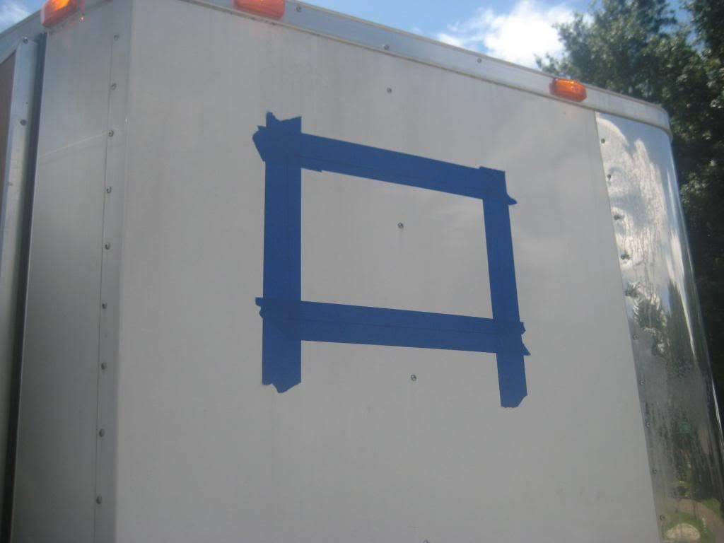

Taped the opening

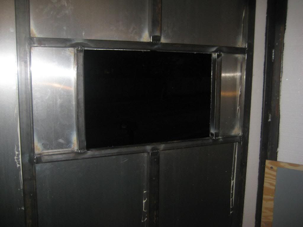

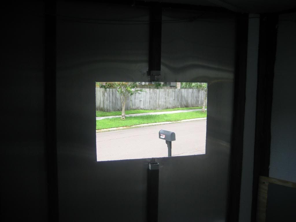

Made the cut. I used a metal blade in a jig saw for the thin stuff and then a sawsall to get through the stud. After that I had to use an angle grinder to cut the stud down 1" on the top and bottom to fit in my frame pieces.

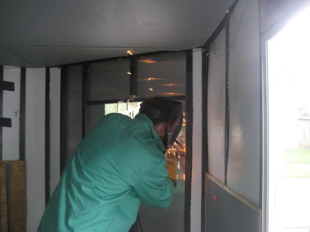

All welded up. The bunks I made were actually the first thing Ive ever welded besides practicing on scraps. I know they aren't pretty but seem to be getting good penetration with minimal burn throughs

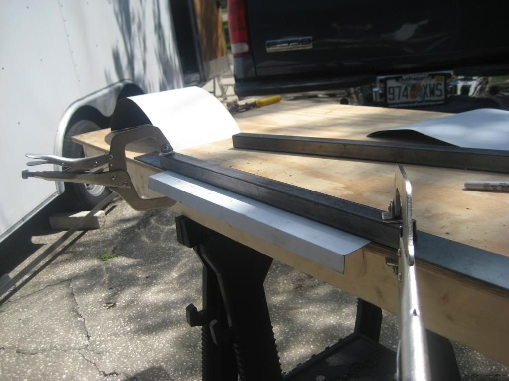

Homemade metal brake for bending the aluminum flashing for inside the frame
Test fitting and drilling side flanges I made out of 1" angle iron
The hole
It is hot as balls in here!!!
Installed and sealed. This thing rocks! I was working on interior stuff yesterday and had it on full blast. I was actually a bit chilly in there which is a huge relief. I was worried it would not be big enough.

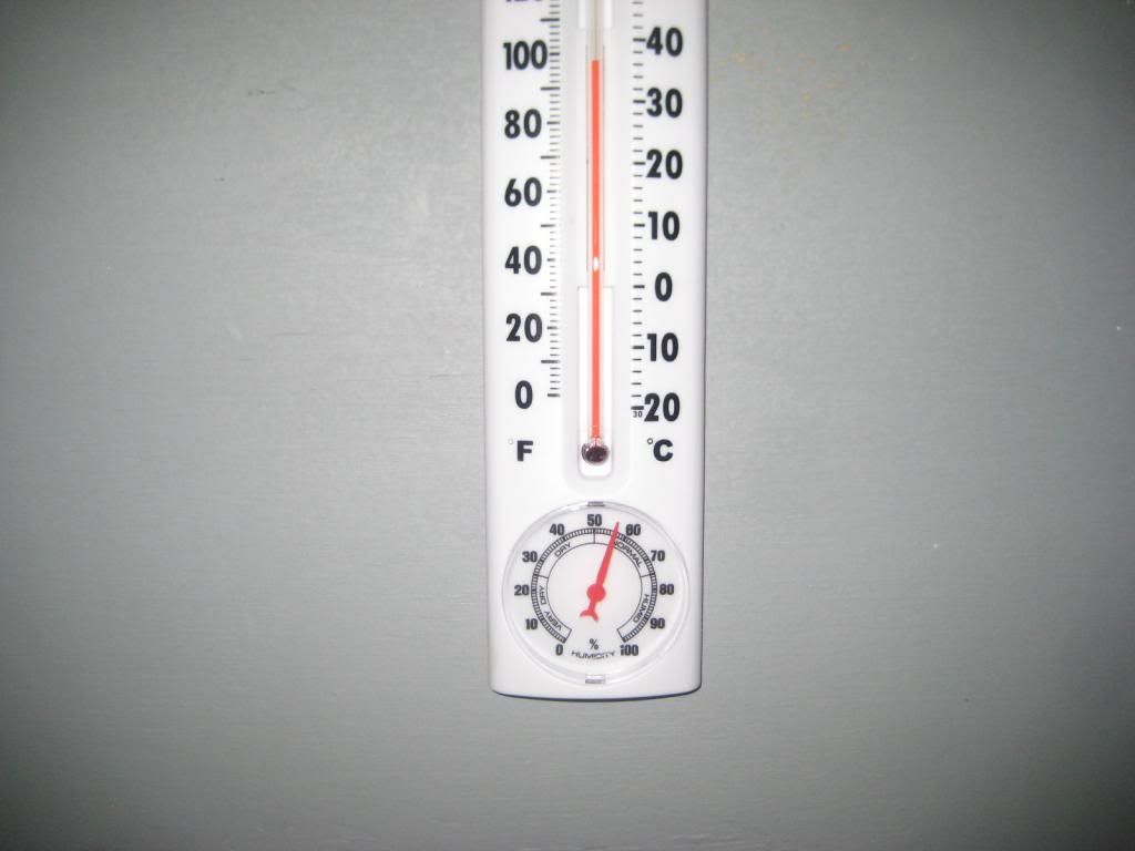

Postby OverTheTopCargoTrailer » Wed Jul 24, 2013 10:11 pm
Did you happen to know what the outside max air temp was ?
Were you parked in the full sun or shade ?
Also what was your inside low temp after running unit a few hours ??
I'm trying to compare different usage & graph insulation values & power usage
Thanks Jerry
Posts: 1628
Re: 20' Enclosed trailer converting to luxury toy hauler
Postby Brian556 » Thu Jul 25, 2013 7:10 am
The outside air temp was around 90 something with about 75% humidity
R 3 3/4" foam board between the studs
Not sure what the ceiling has as it was already done when I bought the trailer. Probably similar stuff though
It sits in the florida sun all day long
It takes about an hour in the heat of the day if I try and cool it off after it gets really hot. Ounce the humidity is reduced inside it really feels a lot better. It will still be a bit warmer in the back of the trailer until it runs for probably 2-3 hours
Postby hankaye » Thu Jul 25, 2013 10:00 am
Brian556, Howdy;
Question about why you installed it on the front, aren't you concerned
about damage to the cooling fins on the condenser? Perhaps you've designed
a cover for it you haven't fabricated and have ready to show us yet.
hank
hankaye
Posts: 2567
Location: S.W. New Mexico
Postby OverTheTopCargoTrailer » Thu Jul 25, 2013 1:16 pm
Hi brian
thats pretty good for only 8,000 Btu in full sun at 90 deg ....
Did not think a small unit would work that well :thumbsup:
don't worry about the front install, worst case after 50,000 miles you get a few stuck bugs.
I would however recommend not driving uncovered in the poring rain
when I get my insulation done, I'll let you know how mine turns out....
as bodies and appliances also produce some heat - not in my calculation.
im hoping 7 x 18 will do 100 deg full sun, with 5,000 btu on only solar
so far so good on shore power test & with empty trailer, but not sure if it works as well
because the inverter & charge controller make some heat also ?
jerry

Postby Brian556 » Thu Jul 25, 2013 9:27 pm
hankaye wrote:Brian556, Howdy;
hank
I know, I stressed about that for a while but decided I wanted mount it permanently so I could lock it down solid and seal it up real good. I am concerned about the issues of having it on the front but am determined to figure out a way to make it work. Funny enough I noticed one of the crappy gray plastic storage bins I had in my garage actually fit over it pretty well....Gonna have to see what we can do with that.
I figured worse case if I don't have anything worked out by Monday it will be trash bag and ratchet strap style :)
