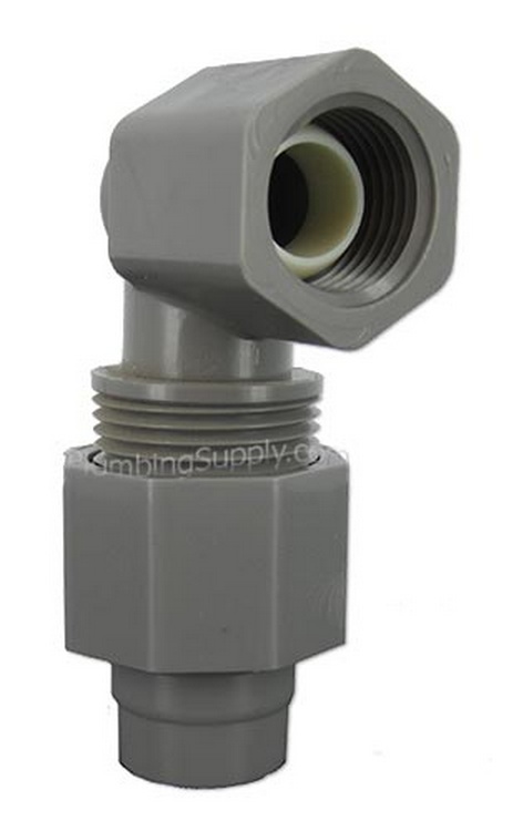

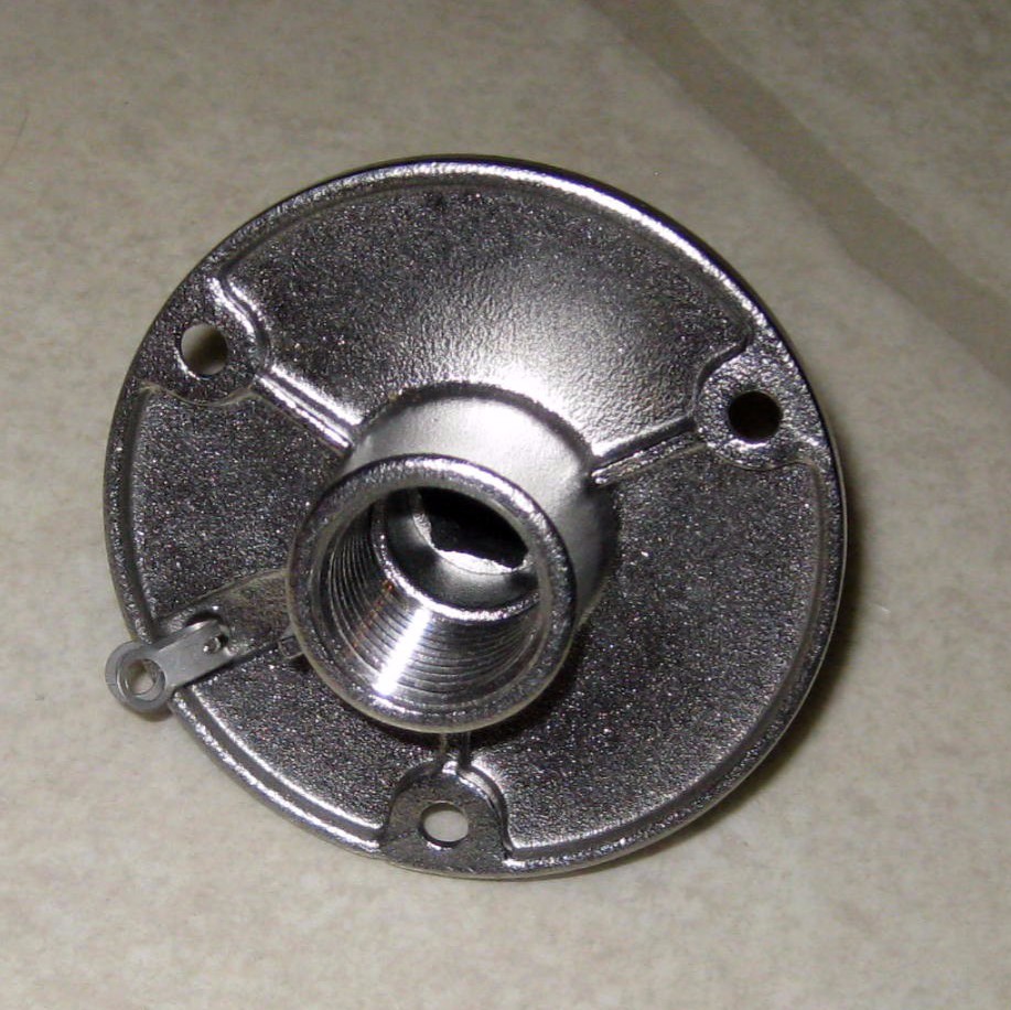

Hi Y'all,
I'm a noob and this is my first post here so, please, bear with me. I've been working on my little cargo trailer and it's time to do a little plumbing. I've done some homework in preparation but the more I read, the more questions arise. I think I've got it mostly figured out but, at this point, I think it would be a good idea to get some input.
I found a good post here viewtopic.php?f=54&t=54069 that was helpful. There was discussion about Qest mechanical fittings there from 48Rob. I had some Qest plumbing in my old Newell. It had been in there for 15 years and never leaked. I liked the stuff and, after reviewing Rob's thoughts about it, I'm looking at Qest fittings https://www.plumbingsupply.com/polyb.html.
The concept for this trailer is to have it set up for shore power and water so (for now), no holding tanks and no 12V. I've got it wired for 30 amp service which I installed thanks to another post by 48Rob. Actually, it was mostly drawn from a good picture he posted of what he used. Needless to say, space is at a premium and I'm trying to get all the stuff I know I like in a trailer and that includes a toilet and sink. The toilet is a dometic 310. My plan is to install a water inlet and tee off to the toilet and sink.

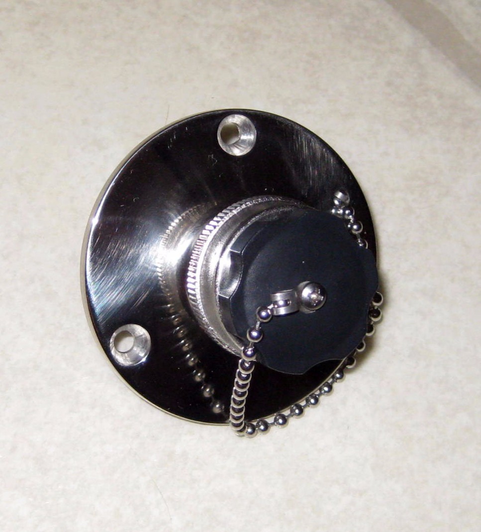

The inlet I chose is stainless steel 1/2" NPT. The walls of the trailer are now 2" inches thick (fully insulated with rigid foam, 1/2" plywood walls over steel studs and 1/4" paneling). The female threads on the backside of the water inlet are only about a 1/2" deep so I'll need a nipple the correct length to protrude through the wall long enough to connect to. Does stainless pipe require pipe dope/teflon tape ? I'm thinking a 90 degree fitting on the nipple on the inside (see picture). I'm thinking 1/2" pex pipe? Then from the 90 degree fitting, connect a tee (again, if I did this right, pictured). I just tried to attach it but apparently there is a 3 pic maximum per post so I think I should try posting this and start another because I really don't have any idea what this is going to look like. My apologies in advance if it's a mess. This is my first post. So here goes!

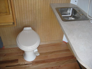

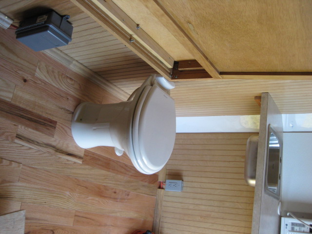

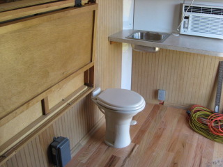

Let's see. Where was I? I'm going to include a couple of pics of the toilet and sink in place. The toilet will be at the foot of one of the folding beds. I know it's not in the greatest location but it's the only spot I can fit it in. So, getting back to the plumbing, with the tee installed, the left side would go to the toilet. I haven't quite figured out which one of the Qest fittings would be needed to connect to the dometic 310. The right side would go to the sink. There are two connections to the hot and cold on the faucet. It's a Price Pfister faucet. Instructions don't state size of connection but it looks like a standard faucet. I'm not sure if a Qest fitting will connect directly the the faucet thread or not so I could use some input on that too. I suppose I would also need a Qest tee to split the water input line into two for the hot and cold. I won't be running hot water but I'm thinking I would connect both left and right faucet inlets even though I'm just running cold water.
The sink drain is 1&1/2" and I think I'll need a s-trap for it. I found one at Home Depot. I'm thinking I'll be using all pvc for the drain plumbing. ABS would be nice but I don't think it's necessary. There is a lot of steel underneath the trailer to plumb around but I think I've figured out a route. I looked at a stock floor flange at Home Depot: http://www.homedepot.com/p/Sioux-Chief- ... K/20231321. Don't know yet if this will work with the Dometic 310 yet or not. This is what I came up with for the drain: http://www.homedepot.com/p/NIBCO-3-in-x ... /100678004. Those URLs are big. If the post too big, I'll have to figure out how to make them smaller. What I'm thinking is connecting the sink drain pipe to the toilet elbow via the 1&1/2" side inlet and install a bayonet fitting to the outlet of the elbow and that would be a direct sewer hookup. I don't plan on dry camping this trailer. At least not now. If I want to dry camp it I'll consider that when the time comes. For now I just want a camper I can tow over to the east coast and hook up at a state park. I'll get a portable black/gray tote tank for parks with a dump but no sewer connections. Here's an URL to the bayonet connector: http://www.amazon.com/Valterra-T1029-1- ... B002N5T4PM .

Hi, thanks. I don't know for sure about the residential floor flange not being compatible. Guess it would be safer to just go with the rv flange. It's hard to know what your dealing with looking at pictures of it on the internet. If I could look at all this stuff in person it would be a lot easier. I was hoping to avoid having to vent the toilet and sink. I figured with such a short distance of pipe involved from the sink to the toilet, the toilet would not siphon the trap on the sink. I wanted to avoid venting. I would imagine that would involve running a pipe through the roof. I've read about air admittance valves. I'll try a little research on those. Maybe a p-trap with an air admittance valve.
I considered the gate valve. I thought, without a holding tank and the direct connection to the sewer line I wouldn't need a gate valve. There's not much room to work with under there. Perhaps for convenience and sanitation it would be better with the gate valve. I thought I'd just get a cap for the bayonet connection when not in use. I figured when disconnecting, I could just shut the water off, flush the toilet so the bowl was empty, remove the sewer hose and just put a cap on the end.
I'd prefer to use ABS and probably will. Home Depot and Lowes don't stock much ABS at all so I'd have to order that stuff. Don't know where I'd find it locally. Maybe a plumbing supply outlet. I've looked on line for local plumbing supplier. Not much to choose from around here though. I don't know what a transition fitting is. I'll try reading up on that. So that "termination adapter" (bayonet fitting) I showed the link to is ABS. I'm guessing that adapter will not slip inside of a 3" pvc elbow? If it would I figured I could just use the correct adhesive to glue abs to pvc. I have a feeling though that it won't slip inside a 3" elbow.

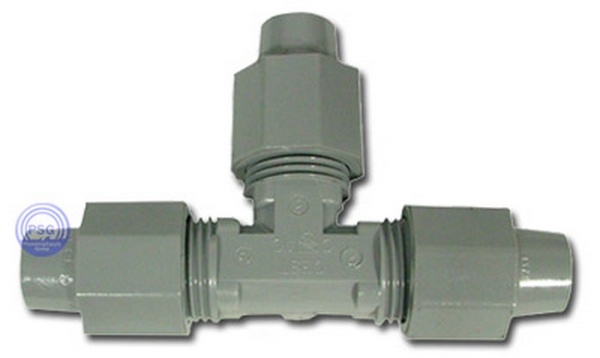

I forgot to attach the Qest tee that I mentioned. Let me have a go at that:

Postby aggie79 » Fri May 08, 2015 1:33 pm
I should have mentioned that I have not done any actual RV plumbing. What I relayed is what I've found out in researching a possible cargo trailer conversion. I have heard good things about the Qest fittings for water distribution.

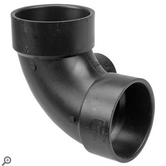

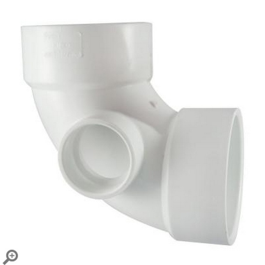

Postby Trailmate » Sun May 10, 2015 6:22 pm
Couple of images of the elbows I'm considering for the toilet drain. I'm thinking glue one of these to the toilet flange and then glue a bayonet fitting to the outlet of the 3 inch elbow. The sink drain pipe would connect to the inch and a half side inlet on the elbow.

Postby kenm8521 » Mon May 11, 2015 7:24 am
Trailmate wrote:Couple of images of the elbows I'm considering for the toilet drain. I'm thinking glue one of these to the toilet flange and then glue a bayonet fitting to the outlet of the 3 inch elbow. The sink drain pipe would connect to the inch and a half side inlet on the elbow.
I'm not that familiar w/ RV toilets, but IIRC, they use considerably less water than standard household toilets. This is likely going to cause an issue w/ any solids moving through your 3in pipe.
In a typical RV setup, a tank is full of solids/fluids, and the fluids help move the solids through the pipe when the gate valve is opened (leaving the gate valve open on the black tank is frowned upon for this exact reason... Google "pyramiding")... It looks like you're going to attempt to run this like a standard household toilet. I could be wrong, but I think you'll have problems doing this.
If you went w/ a standard household toilet however... it should be OK.

Postby Trailmate » Tue May 12, 2015 7:07 am
Hank's post got me to thinkin'. If I install the elbow directly to the toilet flange and connect the sink drain pipe directly to it then I'm going to be getting some outflow from the toilet into the sink drain line. I knew that already but it didn't really occur to me how, in the long run, that could just be not good at all. I'm going to have to come up with a way to tie the sink drain to the toilet drain that would not allow that to happen. Back to the drawing board!
