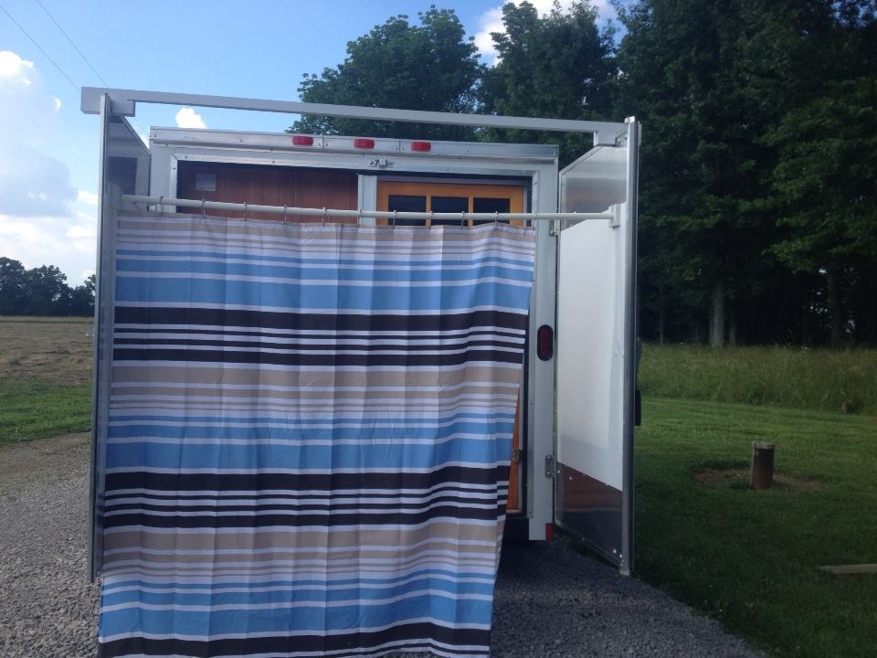

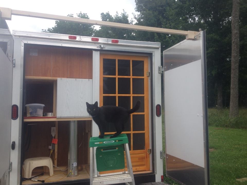

shower area.jpg (95.42 KiB) Viewed 3794 times
We are installing a 5L on demand hot water heater. And going to place it on a hanging system to put it over the back doors. Have a couple pics here. Water heater should be in sometime this week so when we get it done will post a pic

Postby rebapuck » Tue Jun 09, 2015 10:22 pm
Isn't it funny how cats have to sit on everything? I can't bring anything into the house without them checking it out.
I like the door spreader. Better make that curtain rod secure. Wouldn't want it to drop at an inopportune time.
