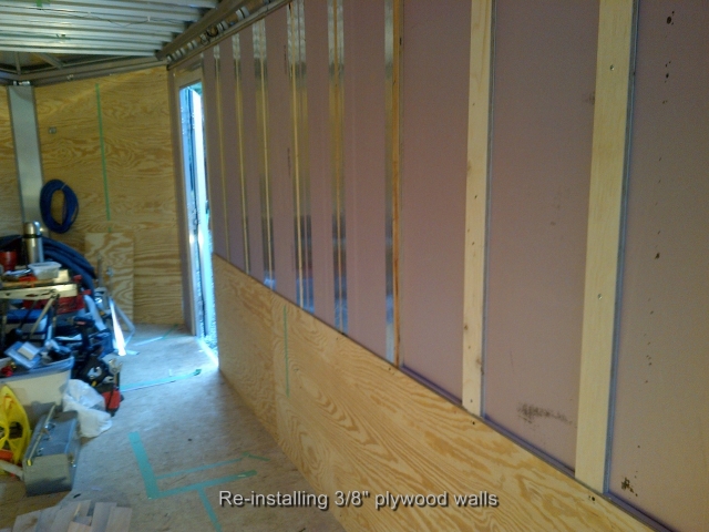

I'm not sure I understand your statement: "Adding wood stripping onto the steel frame would just continue my thermal bridge so I know that is out...".
When I insulated my trailer, I added 1" rigid insulation between the ribs. I then screwed a 3" strip of 5/8" plywood over each rib, sides and roof. I then added 1/2" rigid insulation between the strips and sealed all seams with aluminum tape (the kind used for sealing A/C ducting), NOT duct tape.
When I re-attached the plywood walls, I screwed to the wood strips. The strips are my thermal break or in other words, no visible screw on the inside was "attached" to metal ribs.

Postby CoventryKid » Sat Jan 30, 2016 12:48 am
In a house wall, there is enough mass in a 2x4 or 2x6 that heat/cold can be transmitted through the wood to the interior, so a thermal break is created by staggering the 2x4s:
But cargo trailers are different.
The screws holding the interior plywood walls in place should not come in contact with the metal frame of the trailer. That's why I installed the plywood strips on all the ribs. The interior plywood walls are screwed to the plywood strips, so there is a "thermal break" i.e. the screw holding the interior wall in place does not touch the rib. If you look closely, you can see the screws holding the plywood are screwed into the plywood.
You can see in this picture how I've taped the seams between the plywood strips and 1/2" rigid insulation. As Bob indicated he used "house wrap tape". That's the red stuff. I used a lot of tape too!
Of course OTTCT will say if you'd bought a CarMate (with wood stud walls) you wouldn't have this problem :D :D
Good luck with your project and don't forget - lots of pictures!
